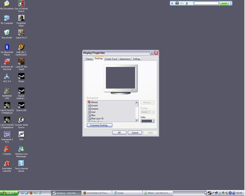

the virus has gone completely its just disabled the right to change backgrounds now :(
this is what it looks like :(

the virus has probbley added a policy so you cannot change the desktop wallpaper
goto start - run - gpedit.msc
play around in that, and remove and settings that are enabled
Indeed it will be a group policy issue. Open the group Policy editor by running gpedit.msc from the Run dialog. You will need to look under Computer Configuration and User Configuration.
The item you need to edit is:
Code:
Administrative Templates > Control Panel > Display > Prevent changing wallpaper
Set this to Not configured.

O23 - Service: InstallDriver Table Manager (IDriverT) - Macrovision Corporation - C:\Program Files\Common Files\InstallShield\Driver\11\Intel 32\IDriverT.exe
O23 - Service: iPod Service - Apple Computer, Inc. - C:\Program Files\iPod\bin\iPodService.exe
O23 - Service: NVIDIA Display Driver Service (NVSvc) - NVIDIA Corporation - C:\WINDOWS\system32\nvsvc32.exe
Thats the log :P
do you use Windows XP Pro or Home mate?
not too sure if the Home version has got GPEDIT.MSC or support group policies
if you have home, PM me your msn address and i can send you the file if you wanna
