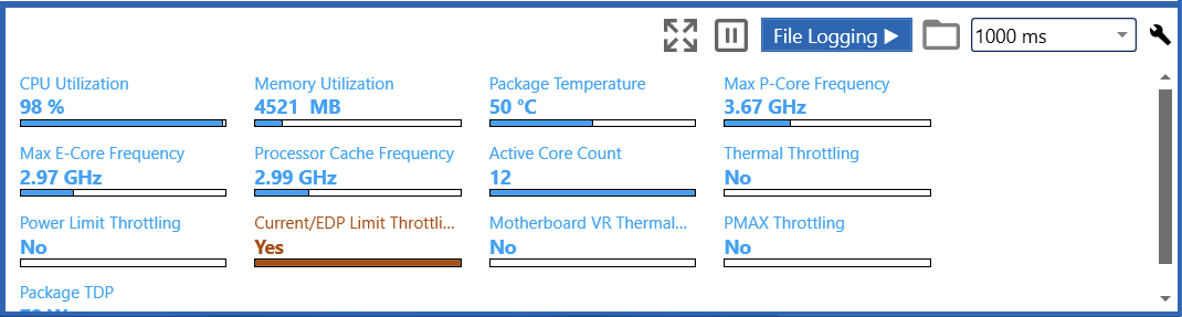

Hey guys, just installed an i7 12700f into an n50 - 640 Acer pre build system. The single core performance seems great but multicore is down quite a bit from where it should be. Could this be a hardware power limitation? Or could there be something else happening?
Temps never go past around 50c.
Would that be something that couldn't be adjusted? I could learn to live with that. Only concerned if it's an setup issue and there's lost performance if that makes sense.

Thanks, yeah the mobo is really limited in BIOS options. It's one of those Acer pre build PCs, think the mobo is a cutom b660, the only options I can see in BIOS are basics boot order, turn of VMD etc. nothing that would unlock more juice from what I can see. Maybe it's aggressive on keeping the power use low?
Single core seems fine, just that multi-core performance is down.
Likely the VRM just isn't up to the job of delivering enough power and so the BIOS is limited to protect it.
Unfortunately nothing will work round that - either live with it or replace the motherboard :(

Not sure why people are focusing on VRM temperatures? Surely the OPs XTU Screenshot would say "Motherboard VR Thermal" rather than "Current/EDP Limit".
Current/EDP Limit suggest it's hit a preset limit rather than a physical limit e.g. temperature
Yes I think your right, all the temps etc are actually incredibly low. Impressive really for such a small PC with an Thermalright Assassin. Like you mentioned I believe it throttles even when temps are ok, based on power consumption or voltage. PC only has a 500w PSU.
