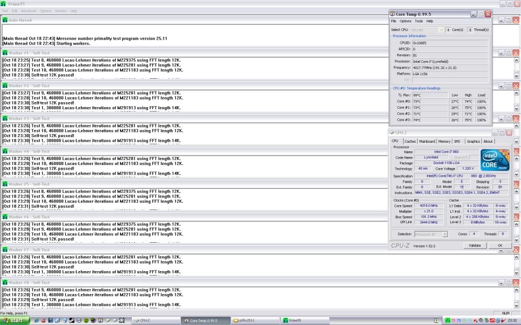

Ok, so this is as far as I'm going to take it. I've got a stable 4ghz with an FSB of 191 and voltage of 1.32. Temperatures are running a little higher than I would like, and have been advised on but they're nothing to be overly worried about. Take a look at the picture below for temps etc.. the screenshot was taken from a small FTT's test about 45 mins in.
