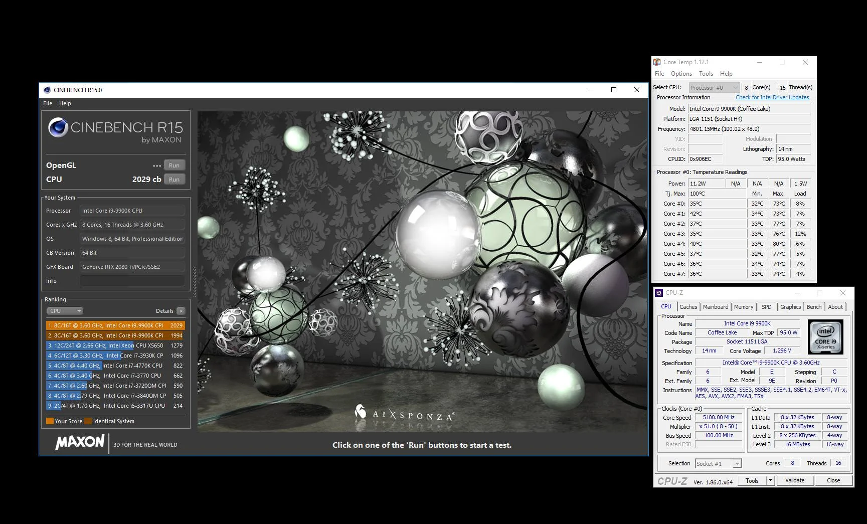

I've just run Cinebench on my 9900k and I'm seeing 2033. This was while downloading a few other Unigine benches for what it's worth.
I haven't changed anything in the ASUS BIOS except setting RAM to XMP profile 1 which is 3200 cl14.
I assume my CPU is boosting much higher than stock to get that number.
