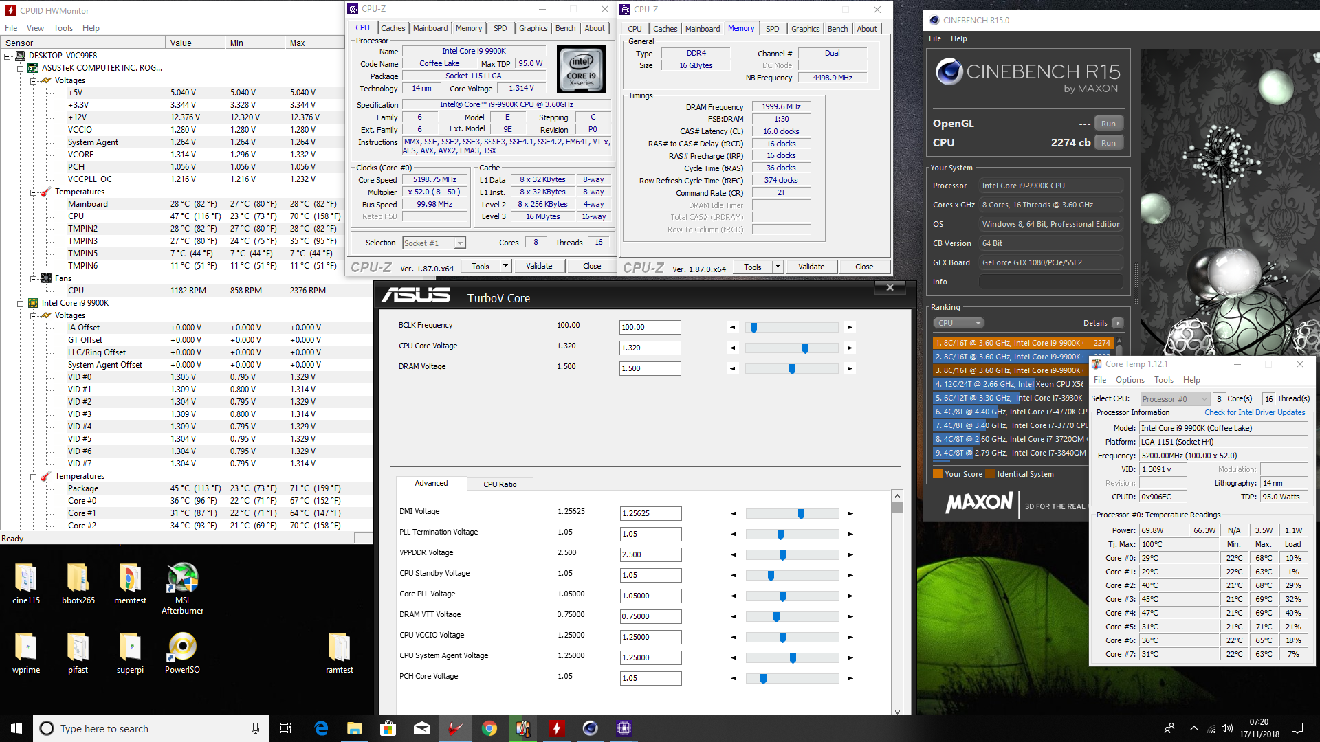

lowest i can run cinebench r15 on full win 10x64, i say this because stripping services back to there bare minimum i can run with less voltage. coretemp and hwmonitor were zero'd before running. LLC7
****EDIT just testing the above for 24/7 stabillity, needing 1.4v to pass 15min stress test in realbench2 with 8gb set and hitting 82c.
Also running as we speak 10 mins in, prime 95 ver 26.6 torture test, max heat etc, max temp 76c
