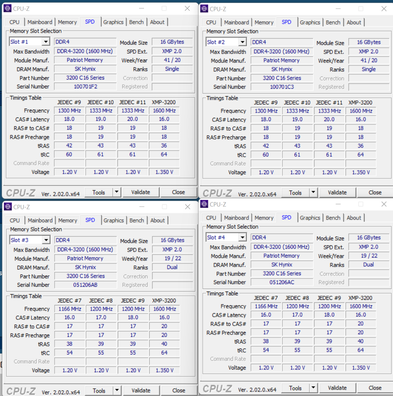

I purchase the same RAM kit "Patriot Viper Steel DDR4 32GB (2 x 16GB) 3200MHz Kit - PVS432G320C6K" around a year ago and indeed it came with XMP of 16-18-18-36. I just bought the "same" kit again this week, from a rain forest website, and after installing had the exact same issue as you (X370 board, Crosshair Hero VI) and couldn't POST.
Just installed CPU-Z to check what's going on, and sure enough even though the kits have the same model numbers, their XMP profiles are very different.
You can see the specs here, old kit in slots #1 & #2 and new kit in #3 & #4:
It would seem that over the course of a year or so, this memory spec was changed. I'm going to play around with the timings and voltages over the next week and see if I can find a happy middle ground or even bring the new kit into 16-18-18-36.
