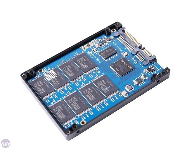

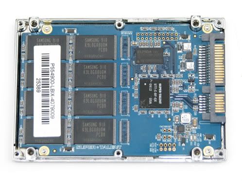

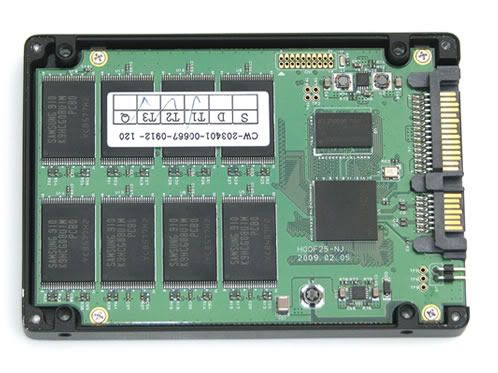

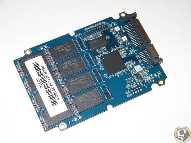

Funny you should mention the pcb's, I've been keeping the images just in case I felt brave enough to cross-flash...which I'm not
Crucial M225
ST Ultradrive
Vertex

Thanks for the pictures. You can clearly see the Vertex and the falcon are the same. So are the ST and the Crucial.
