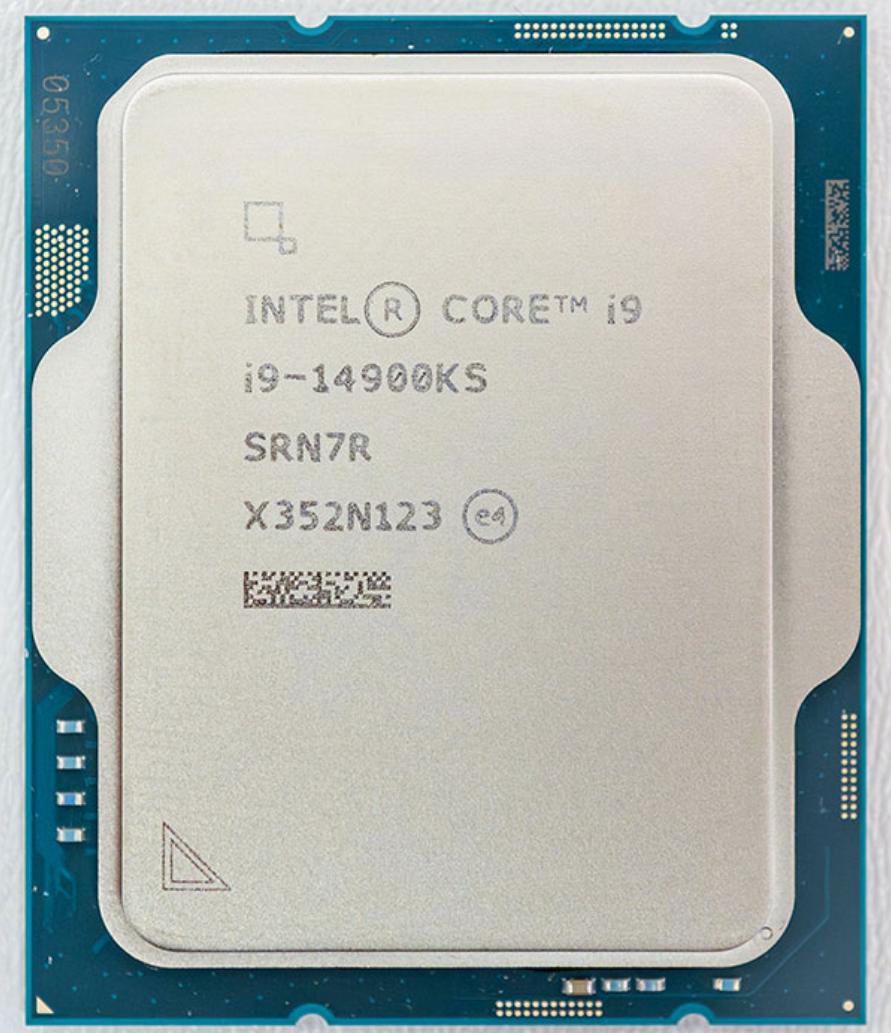

Would love to know if from the codes it is possible to not only get the date but also the fab as at least two fabs are supposed to be involved.
High-res image from a recent view:
Looks like Intel are not keen to tell anyone where it was diffused.
