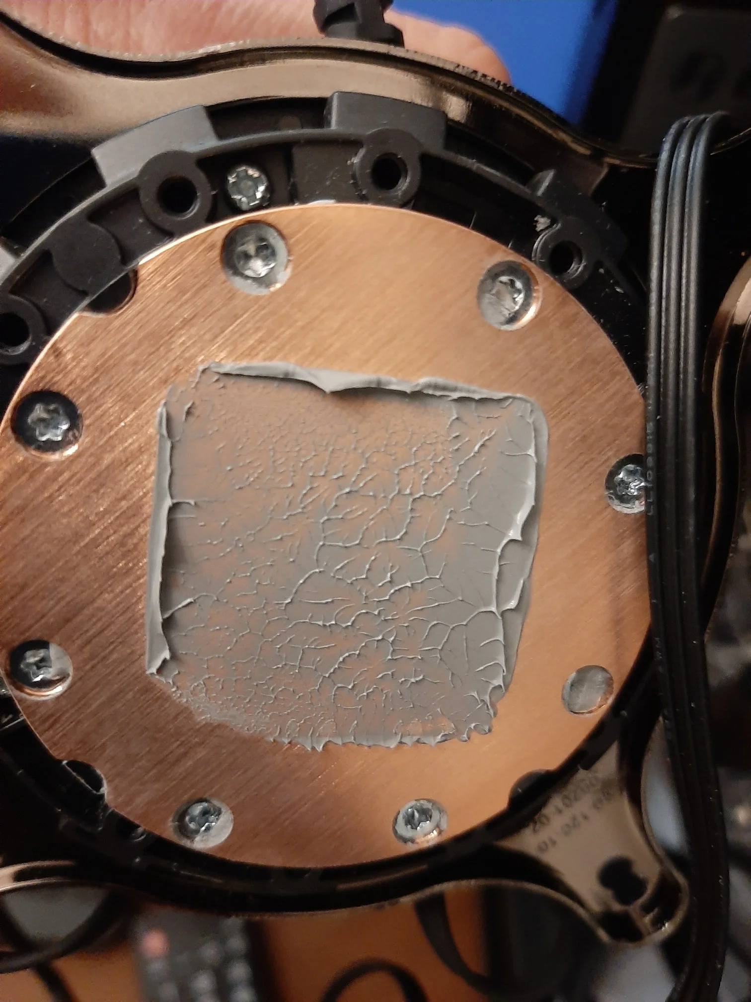

I recently built a pc using an intel i9-10850. All was fine, idle about 32deg, room temp 20deg. On load ie Cinebench it was 88deg
The cpu is cooled with a Fractal Design Celcius 360

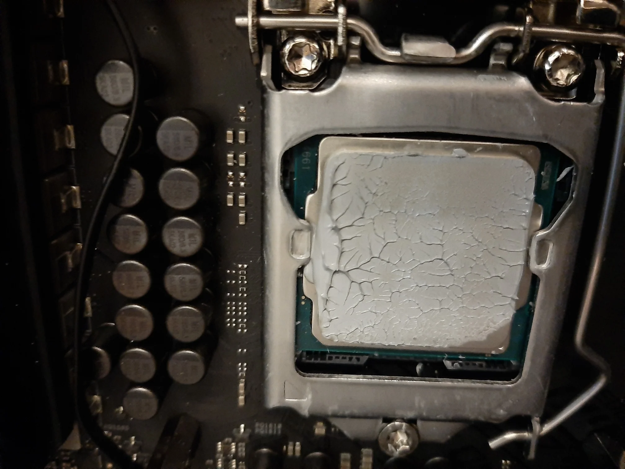

today i decided to Replace the fans and do some general tidying so removed the block from the cpu.
once done fired the pc back up, idle 50deg, hmm thats not right so i removed the block a reseated it.
refired the pc, idle 40deg but as soon as i ran cinebench it went straight to 100deg! and crashed :(
so i removed the block again and took a couple of photos for you to look at. One thing idid notice, both times i removed the hold down screws there seemed to be not much resistance/spring.
its as though the cooler block is not seating properly
any thoughts

Are you using new thermal paste? You need to clean off the old stuff and use new paste every time you remove the cooler.

If all you did was take it off and put it back, it does sound like the mounting hardware isn't getting it close enough to the CPU? I presume the cooler's fan(s) are actually spinning?
Yes
i seem to have sorted it, at the 5ghz oc its idling at 33deg and when running Cinebench 88deg. I cleaned everything and reseated the cooler but turned it 90deg

Maybe something bad happened to the AIO Pump? I had similiar problem and it turned up as broken pump.
Depending on angulation it is possible some air bubbles trapped in the block, and with the rotation it has allowed them to move onwards, thus freely up more cooling capacity.
It might have cleared itself over time and improved temps.
