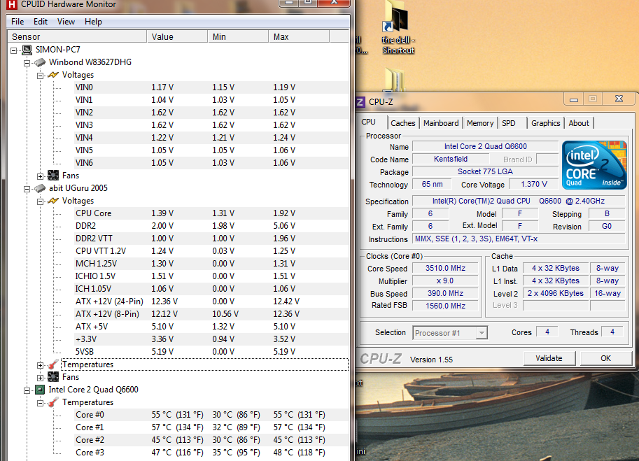

If you have it set to 1.43v in the bios and you are seeing 1.38v or so when at load, then that is probably about right as these boards do suffer quite a bit of vdroop. For instance, mine drops 0.1v when loaded, yours seems to be about half that if I am reading it correctly.
Best way to check is load up HWMonitor and then start Prime95 and watch the Vcore reading.

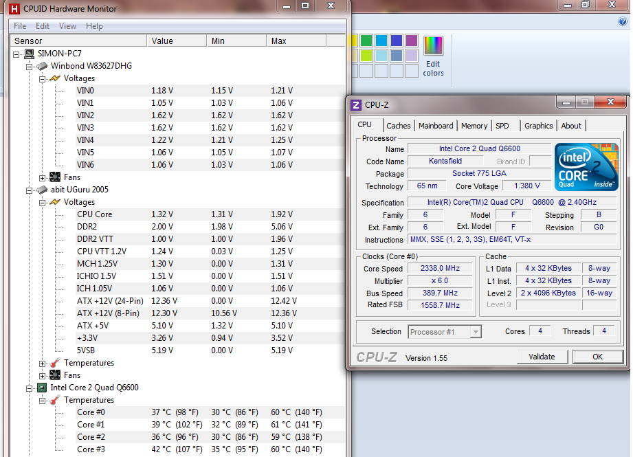

Top one is idel and second one is load.
slight difference between cou-z and hwmonitor.

Hmm OP it is very strange indeed:confused:. Your voltages are 100% correct but they should be the other way round. My Q6600 has exactly the same VID of 1.2625v. I think we need the input of fellow overclockers to shed light on this issue especially

I have seen see some very peculiar things but this isnt one:
In my experiences HWmonitor is more accurate.
Different vcore for load vs idle is normal
vcore droop is the answer
your running a q6600 @3.5 GHz on a Abit IP35 Pro, p35 needs that extra little bit on vcore for stable especially on that board.
Some chips also need the push, 1.39 (HWreadings) is cutting it close for a 1.1GHz overclock on that board mate.
Another indicter for needing more vcore is "after a couple of hours, a couple of cores fail prime"
Your cooler is keeping things well within spec, push the bios vcore until HW is reading 1.44 idle.
