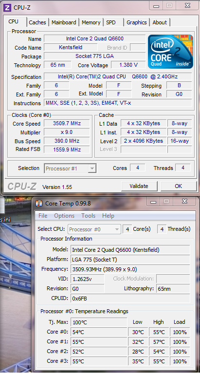

Here is Cpu-z screenys with idle and load, curilously the core vid remans at 1.263

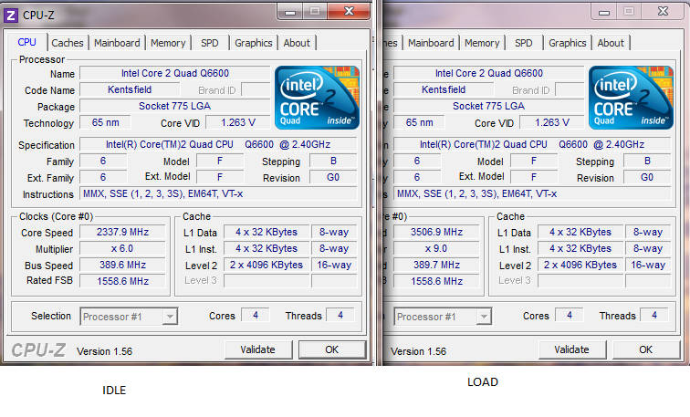

Wait there is something really dodgy with the cpu-z voltage reading:confused:. Normally cpu-z displays 'core voltage' and not 'core VID'. The core VID is the voltage intel has specified for the cpu to run at stock speed and in this case it is 2.4GHz. So VID can also be thought of as stock voltage.
The reason it is not changing under idle or load is because it is not the correct voltage the cpu is running at. You have specified 1.4325v in bios and cpu-z is 'showing' 1.263v. If we are to take these values as they are then you are experiencing a collective vdrop/vdroop of 1.4325-1.263 = 0.1695v:eek: and this value is very high. This would suggest the mobo is a very poor overclocker and not good for stability.
My Q6600 G0 has 1.2625v VID. Although I haven't experimented throughly with my cpu at 3.4GHz but this is what I have on my gigabyte p45 ud3lr mobo:
Bios Vcore 1.4250v
Idle core voltage 1.376v
Load core voltage 1.312v (prime 95 small ffts)
Even though I am experiencing large vdrop/vdroop aswell of around 0.11v it is nowhere close to your's. I would suggest downloading the latest version of cpu-z and running it again:).
Edit at 3.5Ghz your core voltages at idle and load should be in 1.3xxv range.

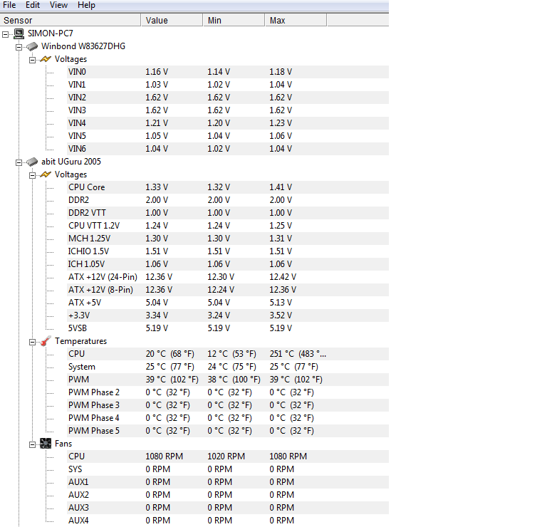

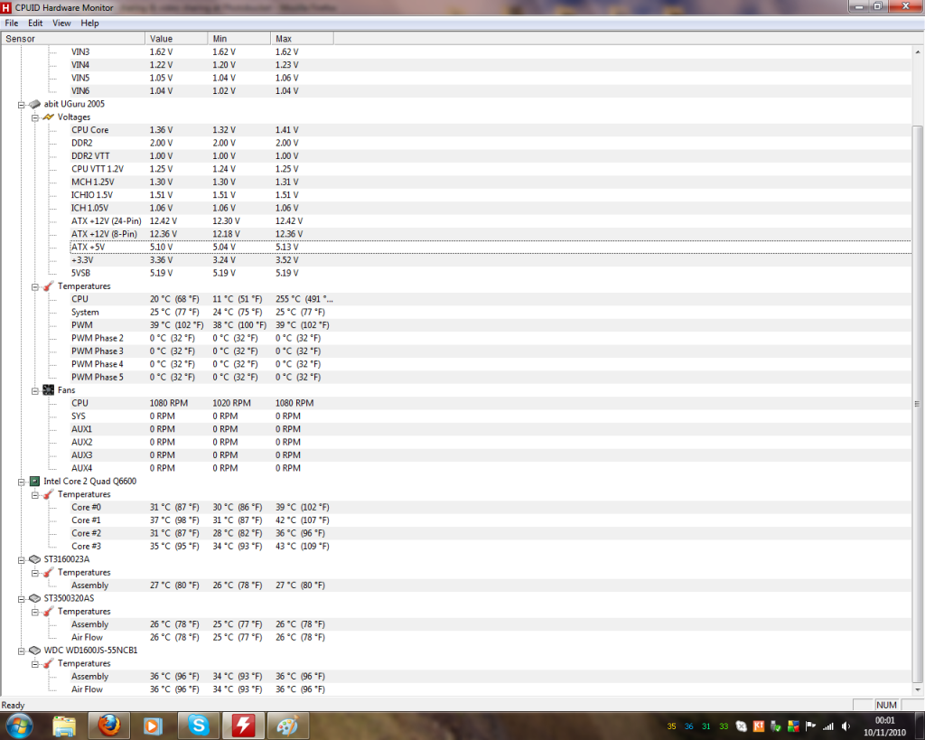

Try running HWMonitor and see what the voltage is idle and load. CPU-Z is notorious for being more than a little iffy at reading voltages, certainly in my experience anyway.

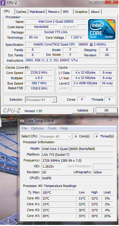

Just downloaded previous version on CPU-z, core voltage shows at idle as 1.320. Under load, i was getting:
1.360
1.370
1.380
1.390
That looks more reasonable. No idea why the latest version isnt working.
I presume your first HWmonitor screen is showing idle cpu core voltage of 1.36v and 2nd screen is displaying load cpu core voltage of 1.33v. In these cases they seem to be correct values as mentioned in my previous post that for 3.5GHz the cpu core idle and load voltages should be in 1.3xxv range if you bios vcore is 1.432v:).

Are you sure about that? The core voltage at load should always be lower than core voltage at idle because of Vdroop unless you have load line calibration LLC enabled in bios (if you have this feature) which is used to reduce vdroop and may affect the normal intel specification.
I think it is most probably the other way round.
Idle
1.360v-1.390v
Load
1.320v
Hmm OP it is very strange indeed:confused:. Your voltages are 100% correct but they should be the other way round. My Q6600 has exactly the same VID of 1.2625v. I think we need the input of fellow overclockers to shed light on this issue especially
