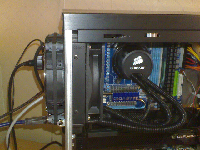

Does anyone have a picture of a PUSH/PULL setup on a H50? Im curious as to how the extra fan is attached..

I put my fan on the outside as I didnt want to put any extra strain on the pipes. I wouldnt use the standard paste, they put far to much on. I used like a half a pea size and that dropped me temps by 8c. also adding the pull fan which in my setup is pulling outside the case knocked about 5c again off the temps. Like others say the radiator blocks all the push air and it just accumulates at the rear so the pull knocks it down a bit :D Im now comfortably sitting my 955 @3.7Ghz at 36c :D
