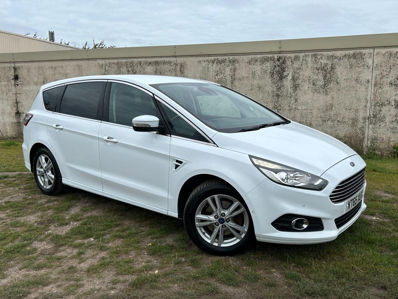

Not an S-Max on that year with a 1.0
Smallest in the model range is 1.5 Ecoboost.

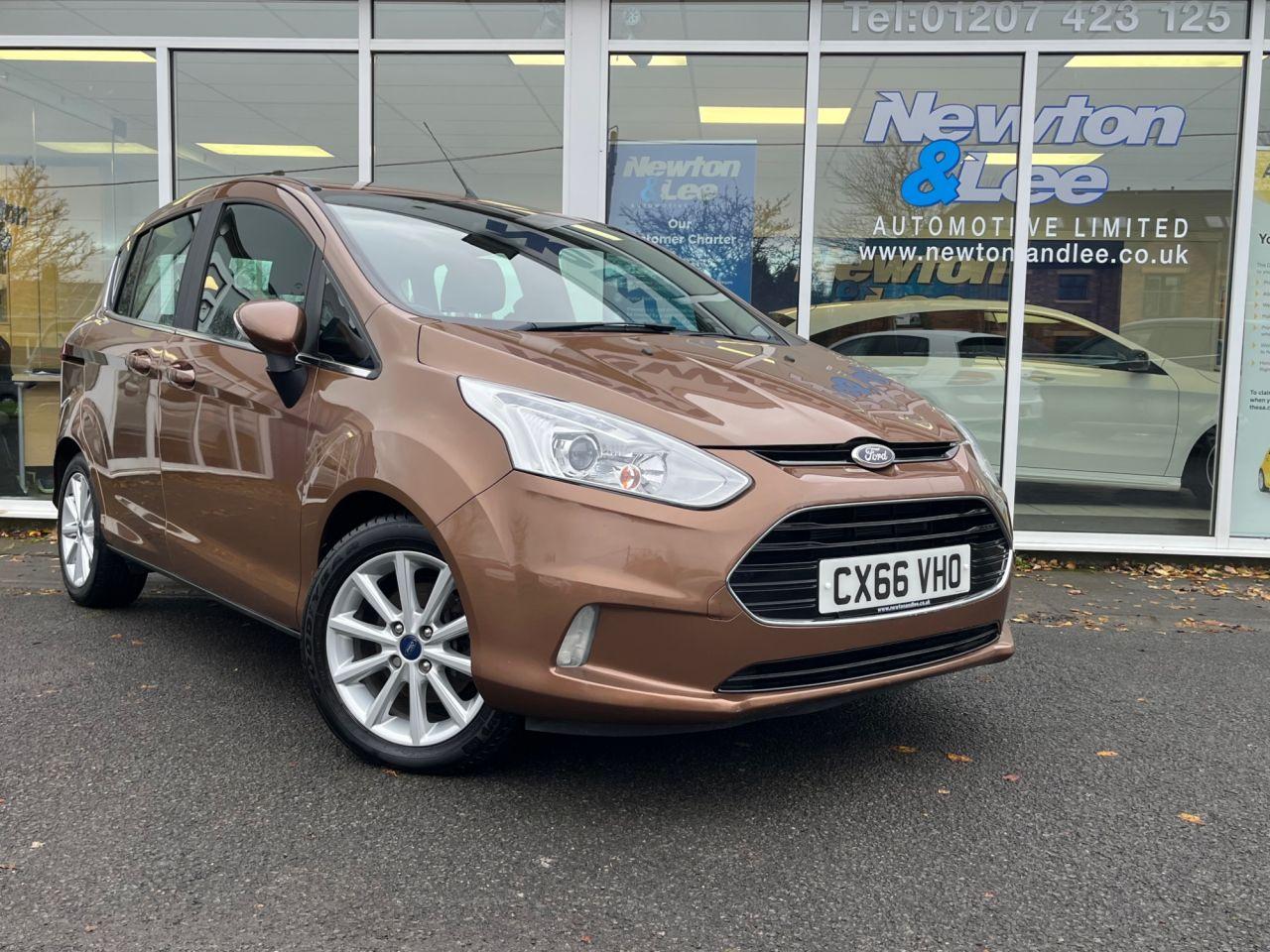

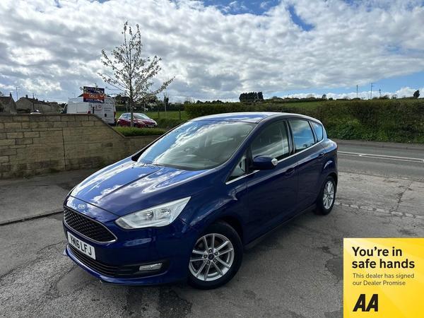

B-Max & C Max both came with 1.0 Ecoboost engines.

B-MAX
C-MAX
And just for clarity - S-Max
