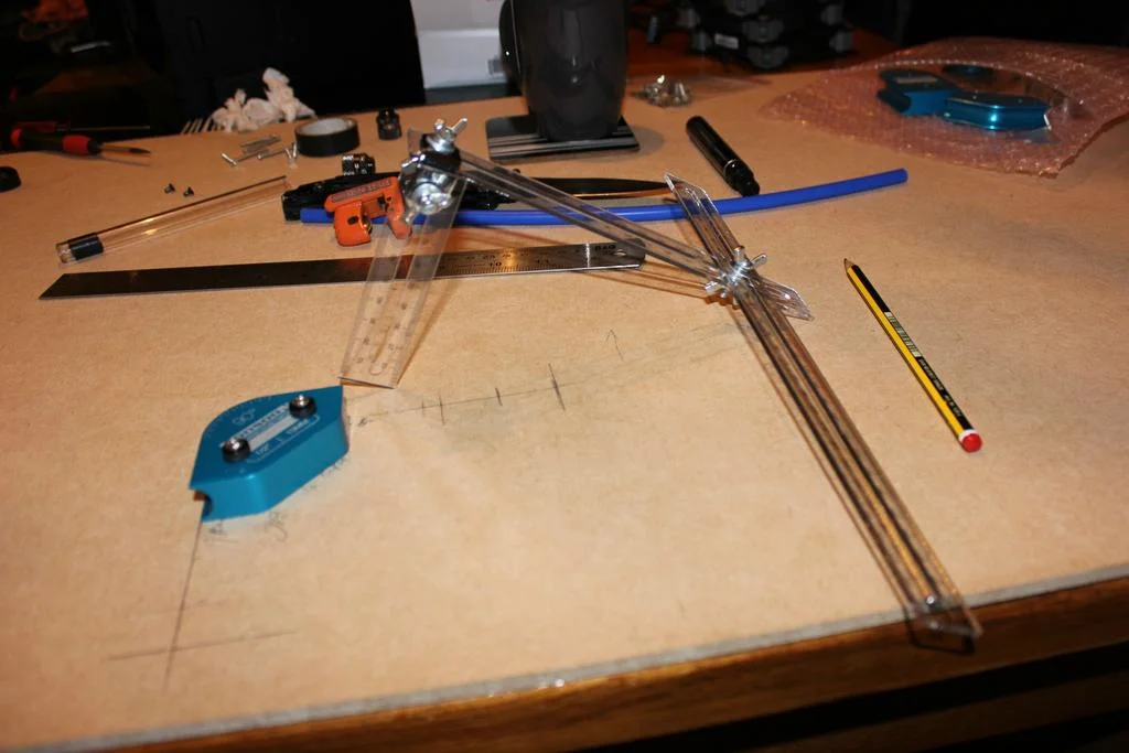

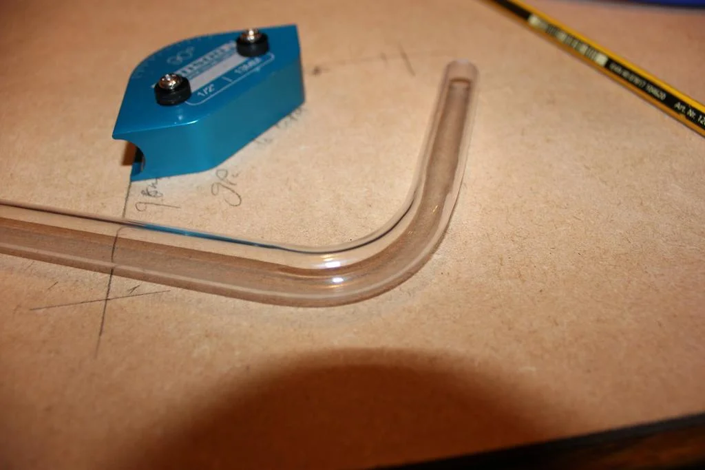

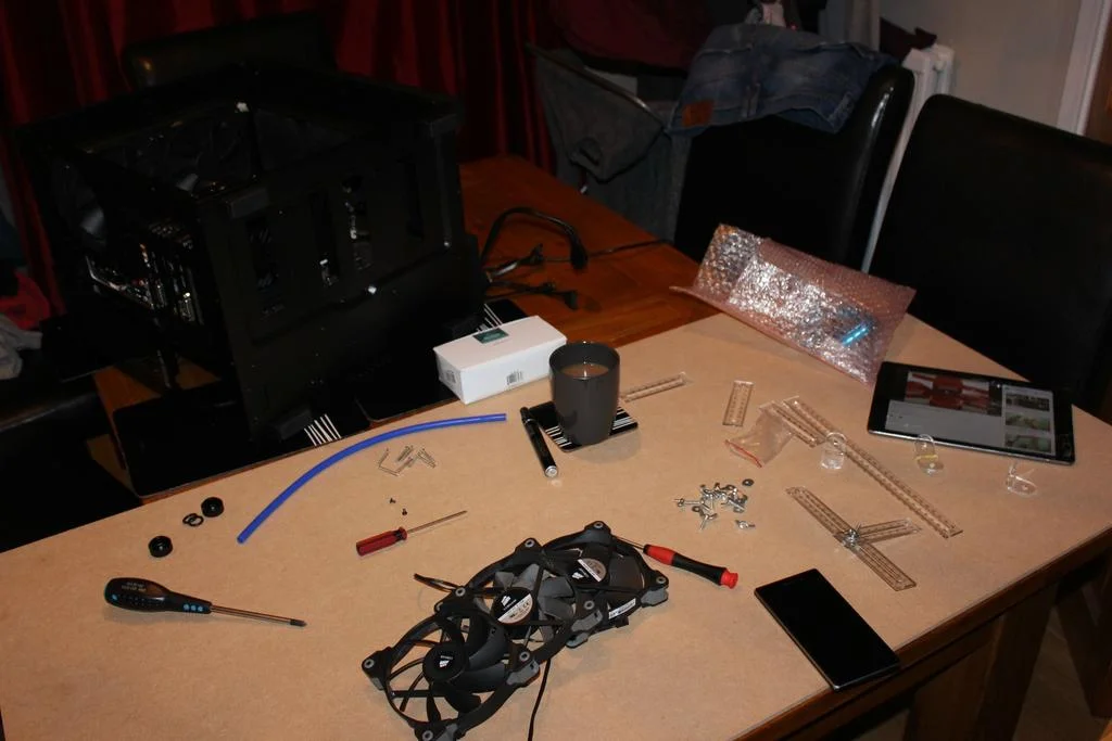

I went and bought some MDF as said above, it was needed after watching a few videos,

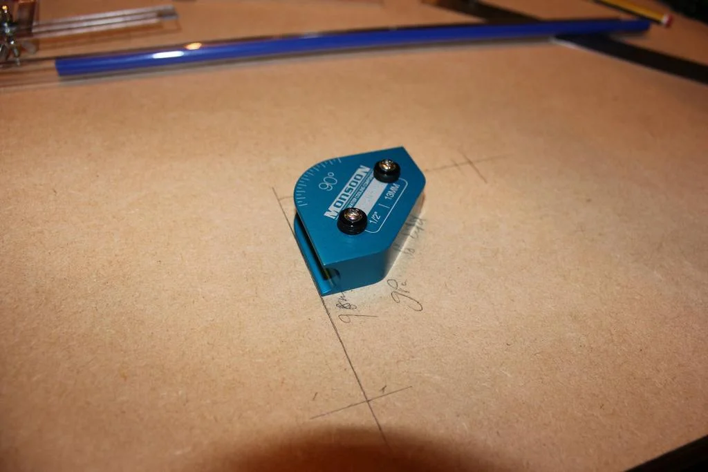

Screwed down my first bender ma' bob.

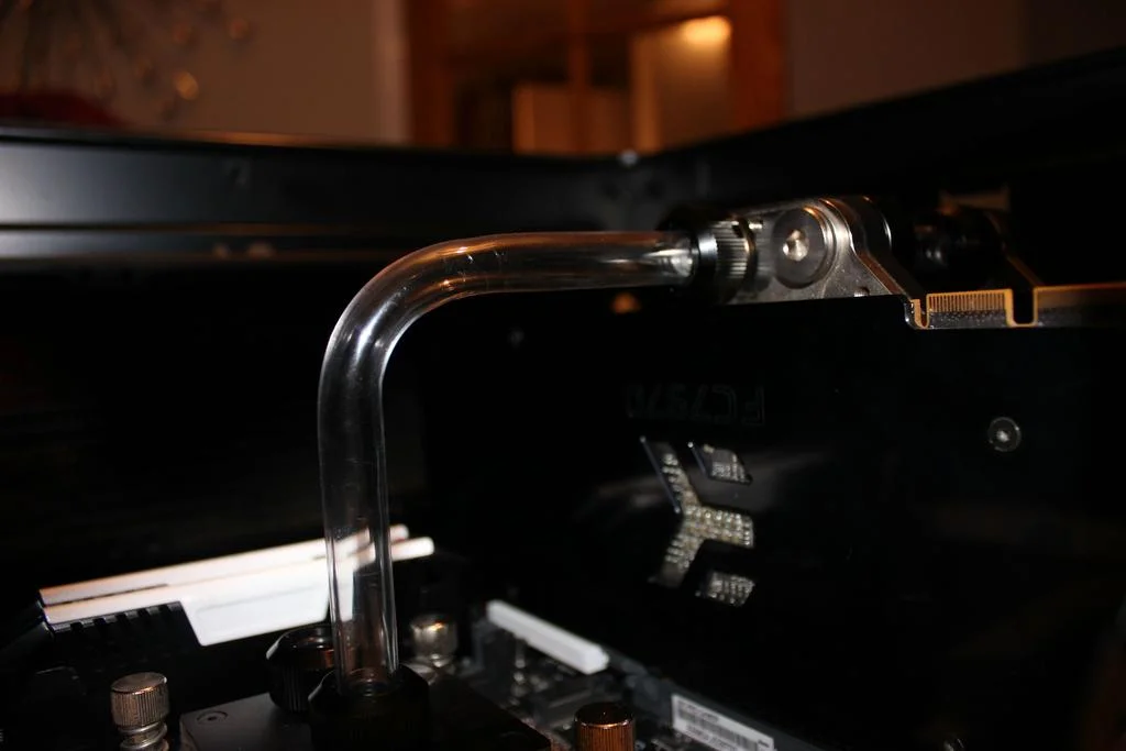

Measured out the lengths from the CPU to the GPU. Then went for my first bend.

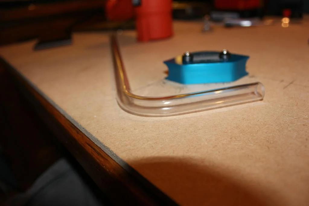

Popped it in, it sat a little too high to line up properly.. You can see it points down a little, this was rectified with the deburererer tool, it's great for taking off little amounts!
This was when I trimmed it down.
Went for the second bit which was a bit more complex but measured up and got everything set up and measured on the MDF.
Started again (My parents were getting annoyed by this point :D )

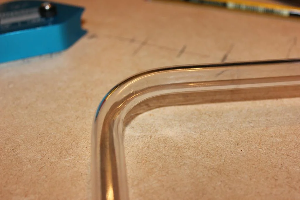

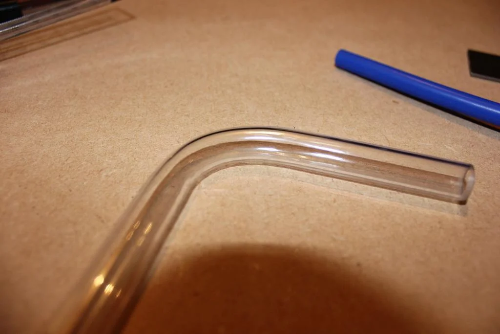

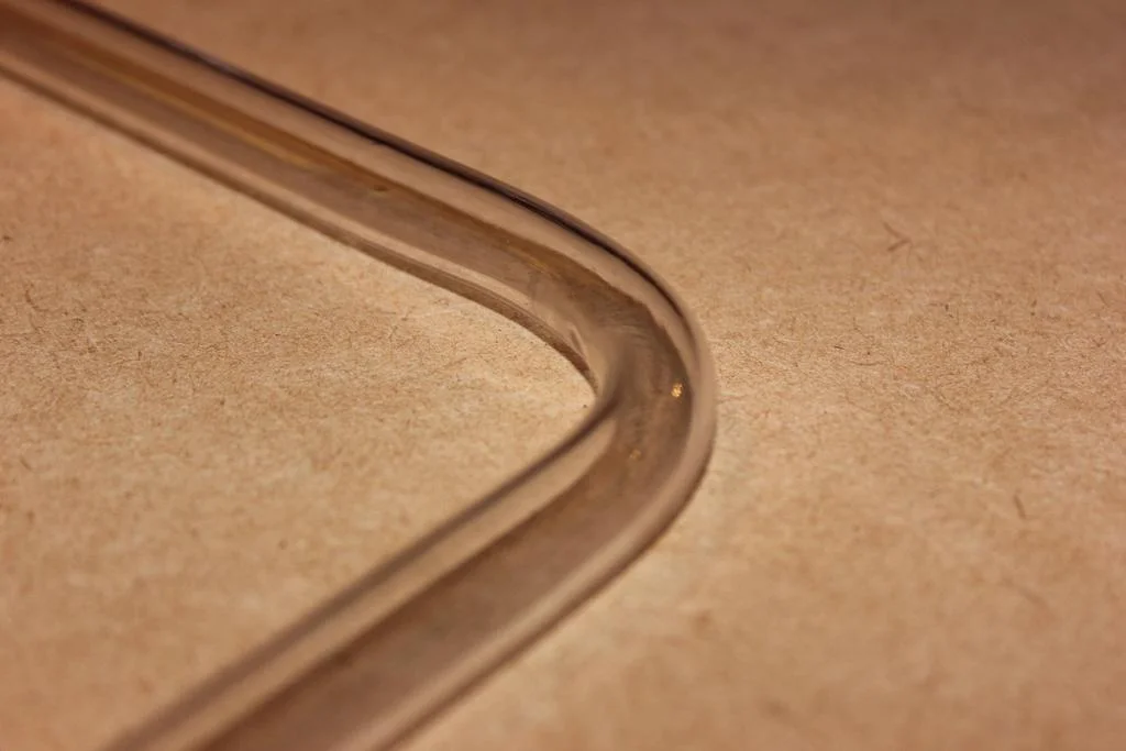

Not to bad I don't think :p
I did make the second bend in this and it went really well, turns out when I went to line it up, i'd bent it the wrong way.. I didn't take a picture as I forgot but not it happens!
More tomorrow, starting to enjoy it now! I love the precision and work you have to put in.
That's great progress chief, and excactly the way I do it. Also believe me, it's easier than you'd think to do a bend the wrong way. I've done it on more than one occasion when it's bending on several axis in one run.

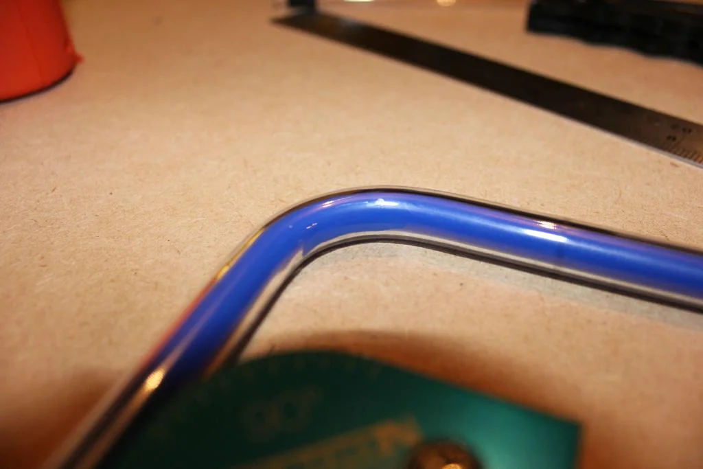

Try holding the tubing as far from the bend as you can to avoid any depressions in the tube around the bend. It also makes it a little easier to line the bends up nice and square.

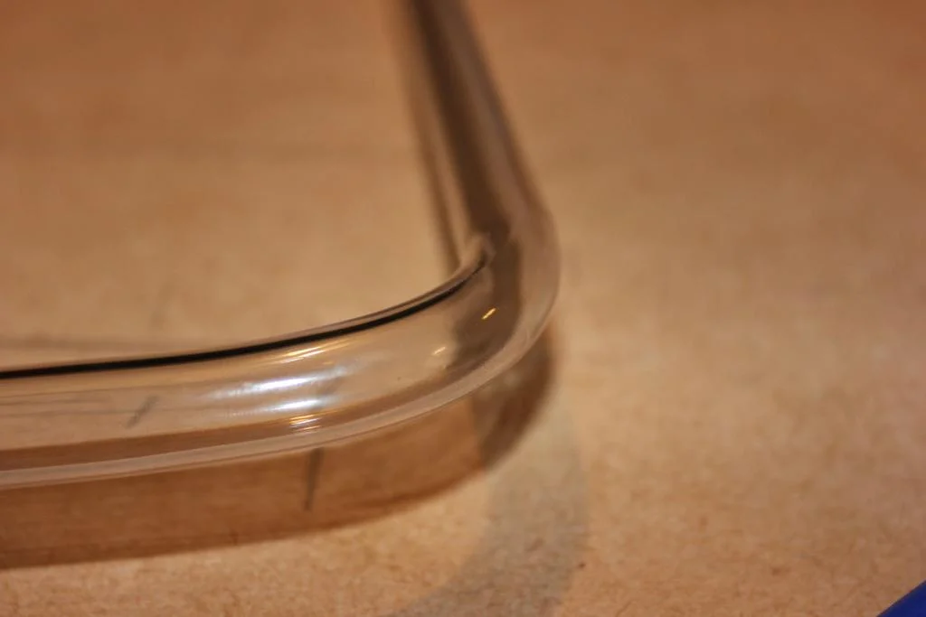

Your tubing run looks good as you appear to have got a good, precise corner with minimal collapsing on the inside of the bend. Just remember that bending it should be like walking it arround the mandrel instead of being like bending a piece of metal/plastic. Still though, nice work and I look forward to seeing the rest of the tubing runs :)

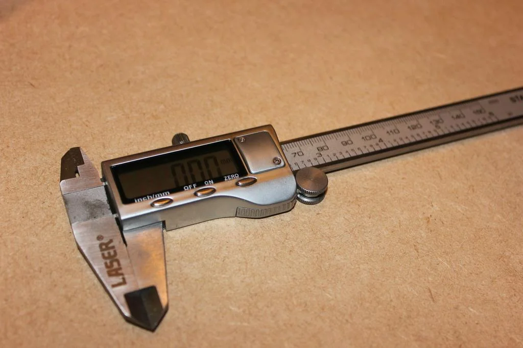

I got fed up with the stupid measuring things and thought i'd do it my own way, which for me, works much better!
I took my spare Vernier caliper from work, it is pretty handy.

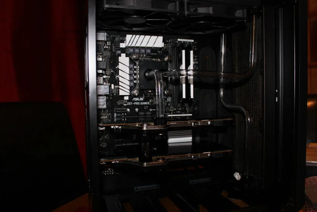

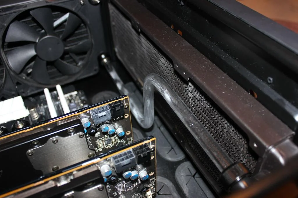

I was thinking this would look cool, which I think it does but I didn't take into account the fans luckily they fit at the front behind the mesh which doesn't ruin the looks a massive amount. it's a couple of mm too long in the middle between the two bends but luckily I used my 90 fitting to get it to fit.

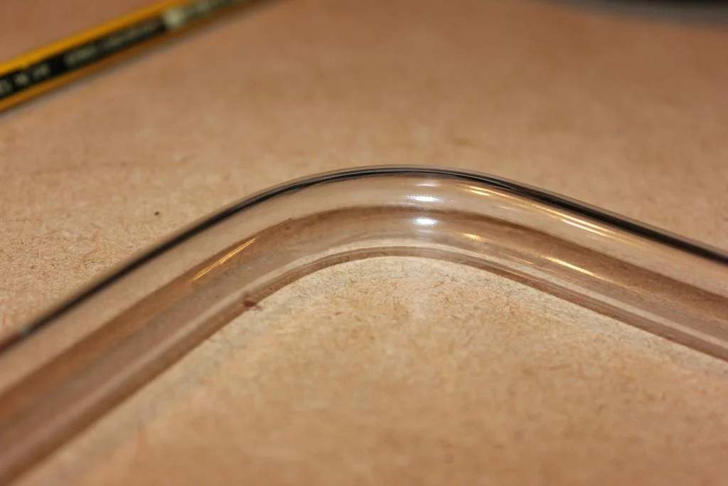

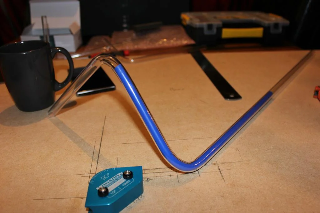

I got a bit carried away with bending and this was my best bend I've done so far... I'm real proud of this one.
I was so 'stoked' on this it was unreal.. I was showing my parents, how didn't give a crap and looked at me like a weirdo!

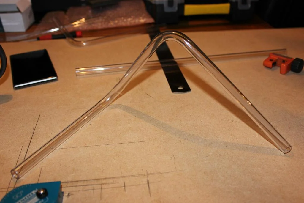

Got my two axis game on, it worked this time!
I think it's look pretty sweet now. The camera angles make the bends look a lot more out than they actually are.

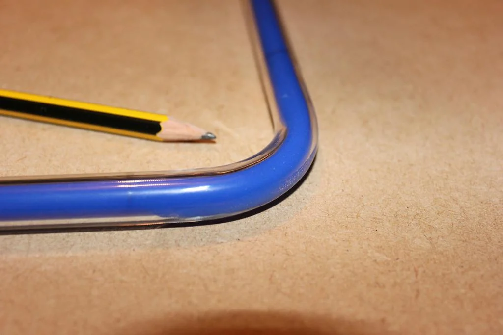

Those tubing runs look excellent. You must have spent a lot of time measuring them as they look very precise and neat with no collapsing. :)
Can't wait to see the rest of the build log as the build is coming on in leaps and bounds.

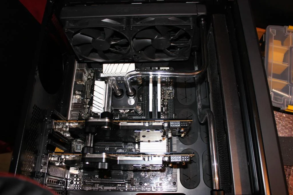

Little update, nothing major:
I've ordered more fittings from another water cooling company in the UK which are awful as I still haven't got my fittings.. Not a happy bunny!! Can't go another night without my PC and no work this weekend means loads of gaming so i've put it back together with my soft tubing as the last two bits of tube.
Here's a little peak of what one tube looks like :D
I'm not giving anything away as i'm quite proud of this :D
