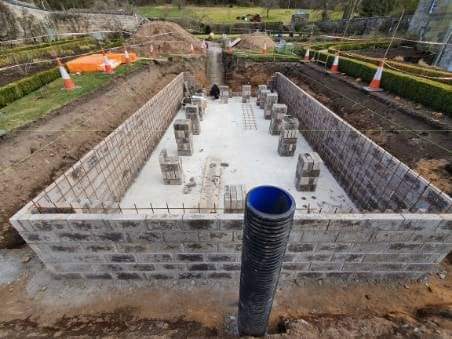

Regarding breaking the shell, these pictures are of a domestic pool the company I work for are currently doing and will give you an idea of the amount of steel that there may be in the structure:
I'd be very surprised if there was no steel in yours. A customer of ours is currently in the process of suing his structural engineer for a 6 figure sum in order to repair his pool as it was spec'd incorrectly resulting in there being no steel in the floor. As a result, when it was filled the floor came away from the wall down one side and his 75,000 litre pool has been loosing almost 100,000 litres of water every month for the last 10 months :eek:
