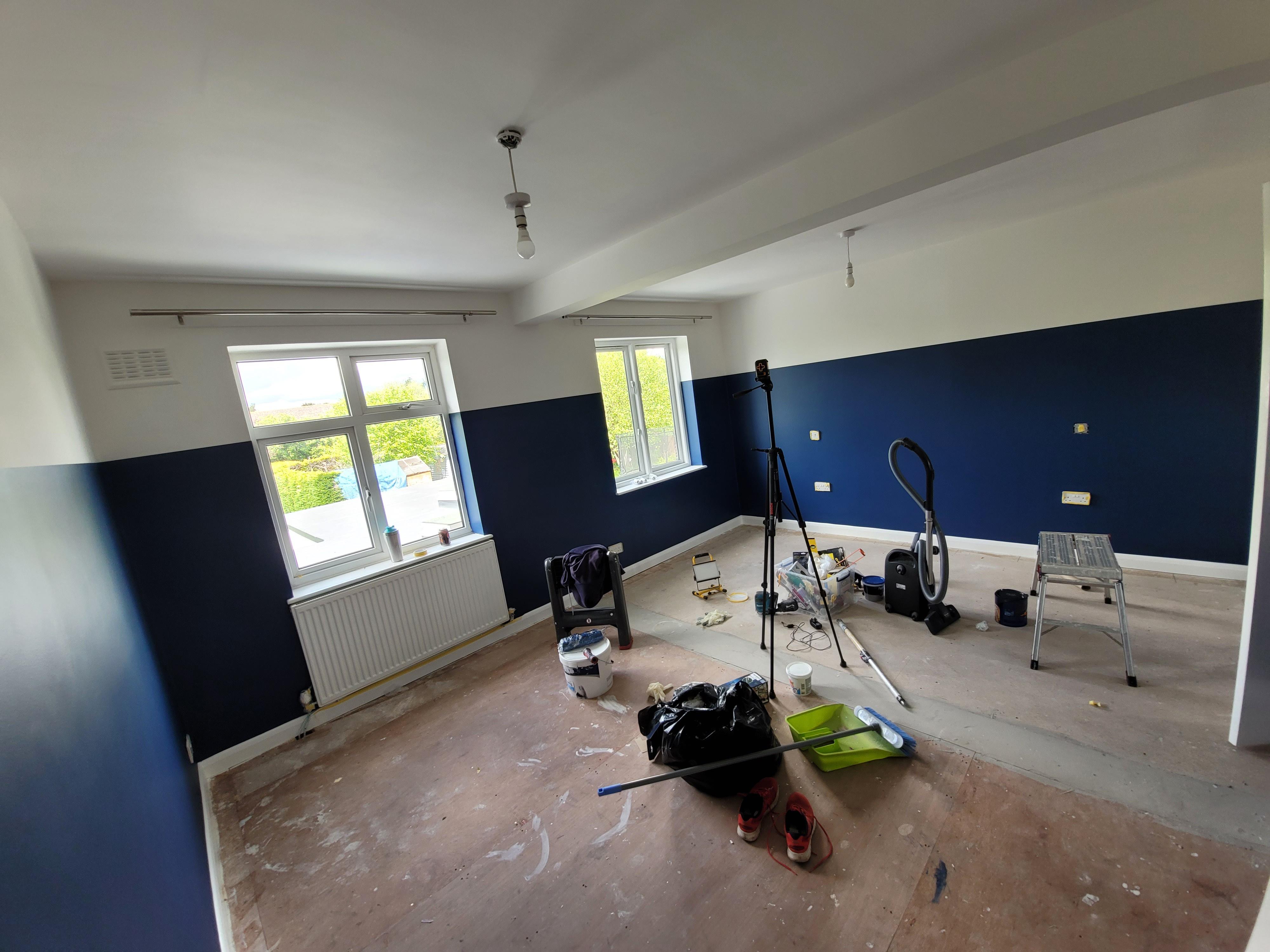

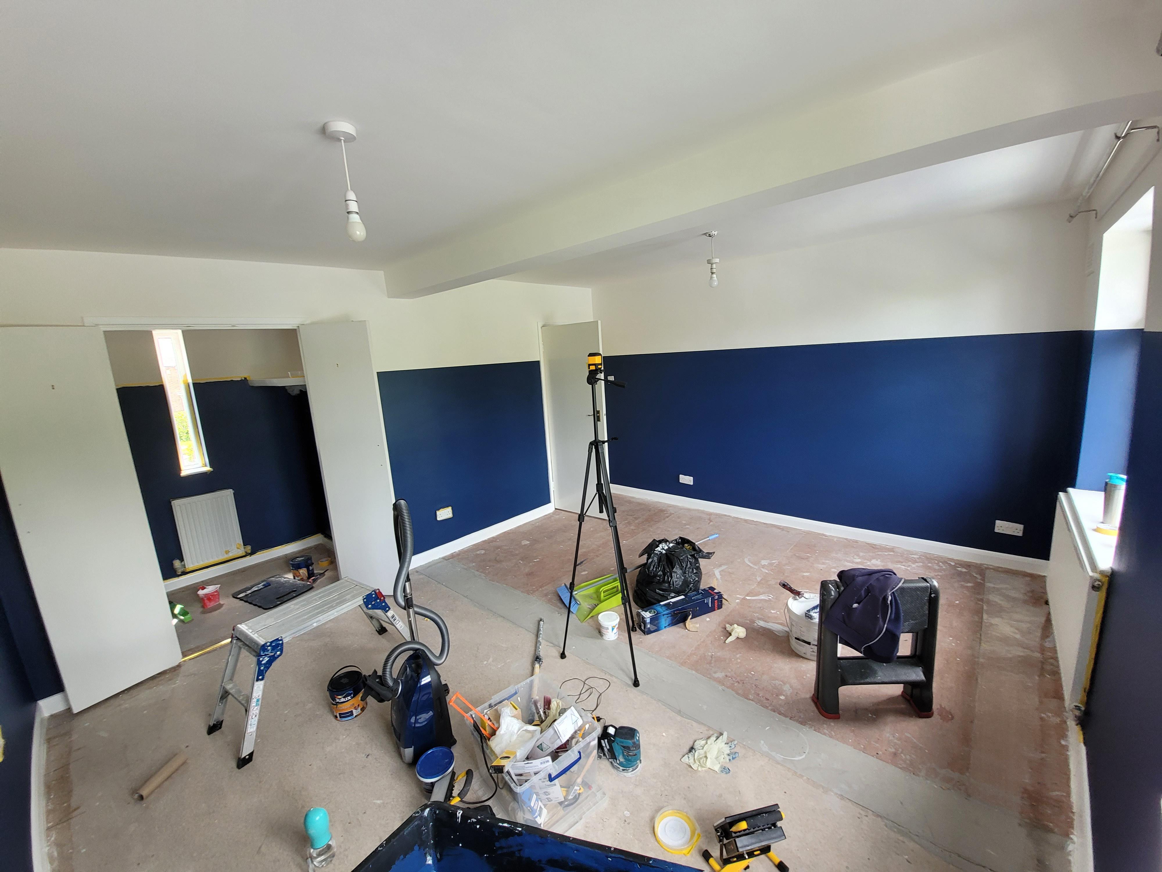

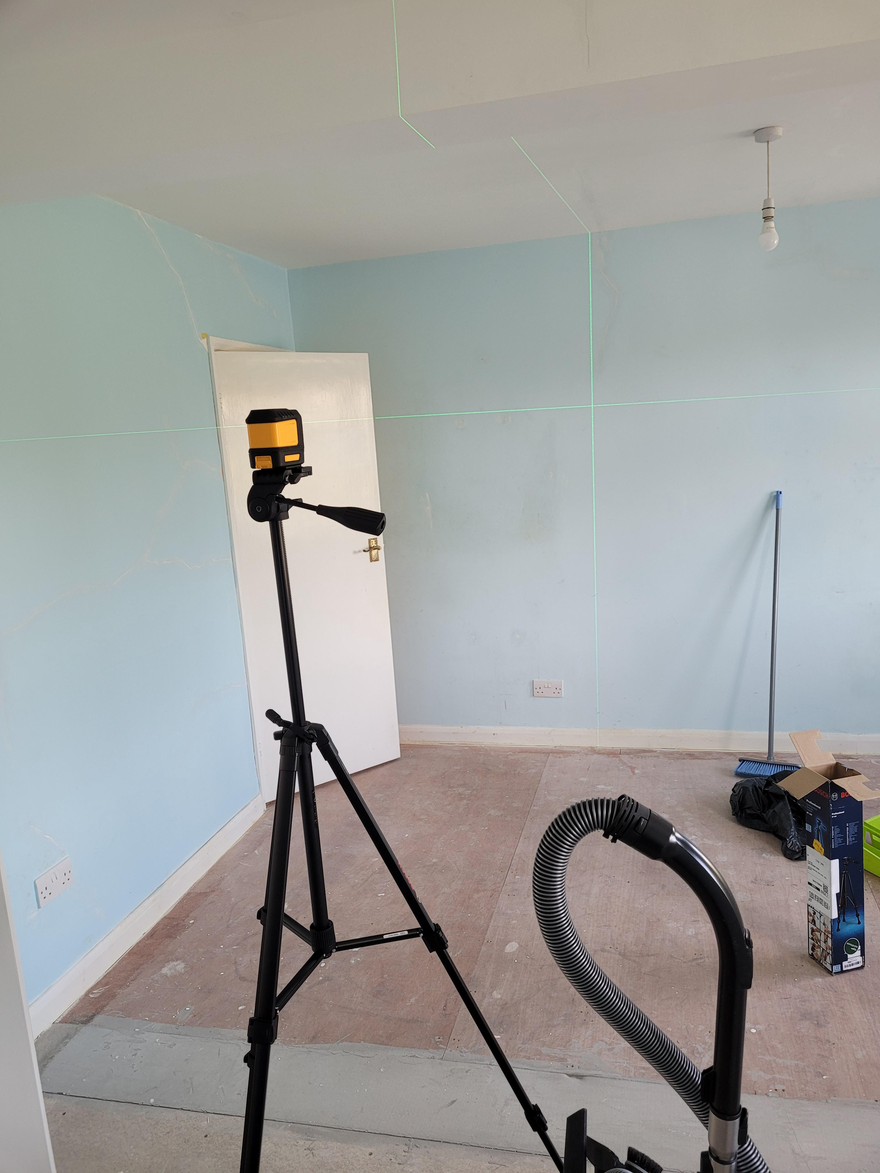

I use one of these
Laser Level Green,RockSeed Green Beam Cross Laser Level Horizontal and Vertical Points Rotatable 360° Self Levelling Laser Level with Manual/Self-Leveling Mode IP54 1M Shockproof (Battery Included) https://www.amazon.co.uk/dp/B07VPH4...t_i_7TKDF1M31HG9V74FBD8R?_encoding=UTF8&psc=1
Combined with one of these
Amazon Basics 60-Inch Lightweight Tripod with Bag https://www.amazon.co.uk/dp/B005KP4...t_i_SXE8BDYMXN0XM34W0YA2?_encoding=UTF8&psc=1
Has worked out to be a great combo for me!
