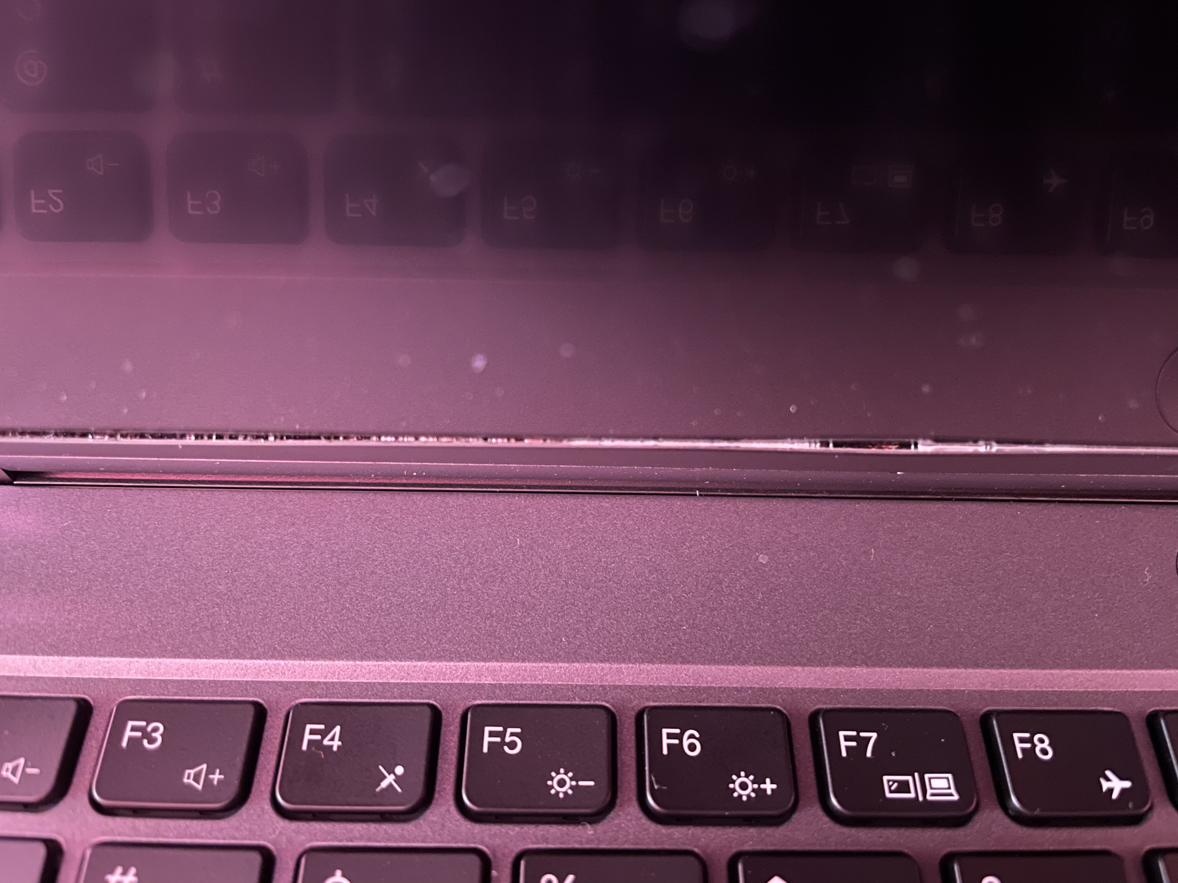

So second one... No dead pixel, buuuut huge amount of blacklight bleed from lower bezel. When I looked close, I was shocked that lower bezel was loose from the screen. Like wtf is going on? Then opened laptop to change the memory, There should be warranty void sticker on one screw (as my first pro had) and on this one this sticker is being removed, I can see it from a little piece left over and screw looks like its been handled pretty ruff. So I am sure that this laptop was sent back and it has been repaired. That explains poorly assembled screen.
I am stressed out to be honest. WHat a mess it is. Don`t know what to do next. Should I order third one or just get some other brand/model.
