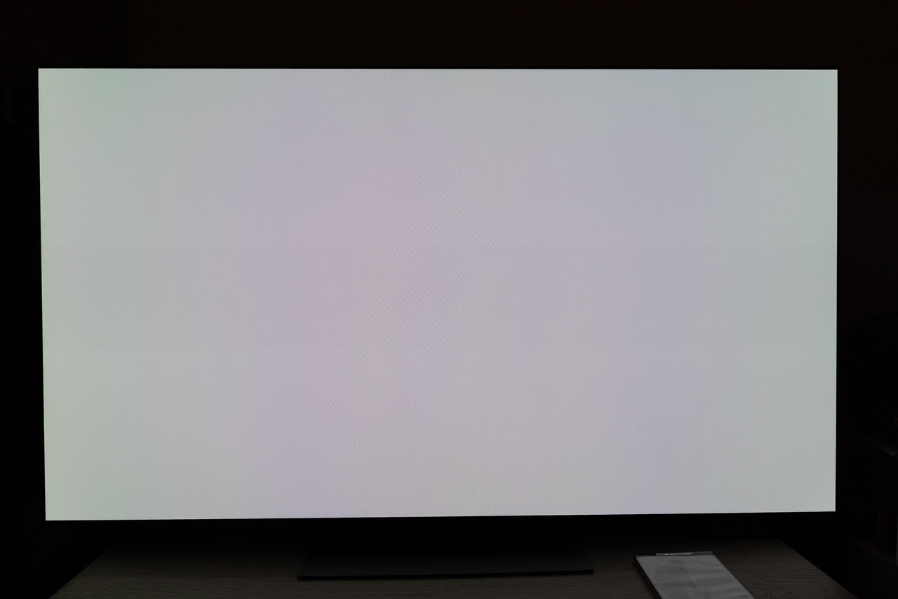

I picked up the LG G5 65" during the BF sales, and it's not been a good experience.
The first unit had extremely poor tint on viewing angles, I'm talking tint shift when moving half a metre from dead centre, I sent it back for an exchange.
The second unit has slightly better tint shift off axis, but head on, looks like this on a 100% white screen.
I'll go again with an exchange, but the QC over at LG is insane.

If can see that on my phone it must be worse viewing it.
Not sure if quick/long pixel refresh corrects that
Hmm I’d say the opposite - a phone will pick up these things way better than human eyes. This is why there are loads of amazing photos of the northern lights in the UK showing vivid greens and pinks but you couldn’t ever see it like that with your own eyes.
That’s not to say it isn’t bad. What really matters is whether you can see it in the context of something you’re actually watching. If it’s only noticeable when displaying a block colour… especially grey which always seems to bring out the worst in any display… there’s scope to chalk it up as a non issue.
Obviously, if you’re not happy with it then don’t accept it. Just trying to avoid someone the pain of only accepting ‘perfection beyond what you can naturally perceive’, if that is what is going on.
100% agreed
I don't even bother testing greyscale stuff, generally speaking when I buy a TV, if I can't see an issue when watching it and playing games, then it's perfectly fine.
I've got a 65" C2 I brought home from work. It has a few clusters and scattered dead pixels - maybe 10-20 or so around the edges. I gave it a few days and I have never once noticed a dead pixel from the sofa. Keeping it.
