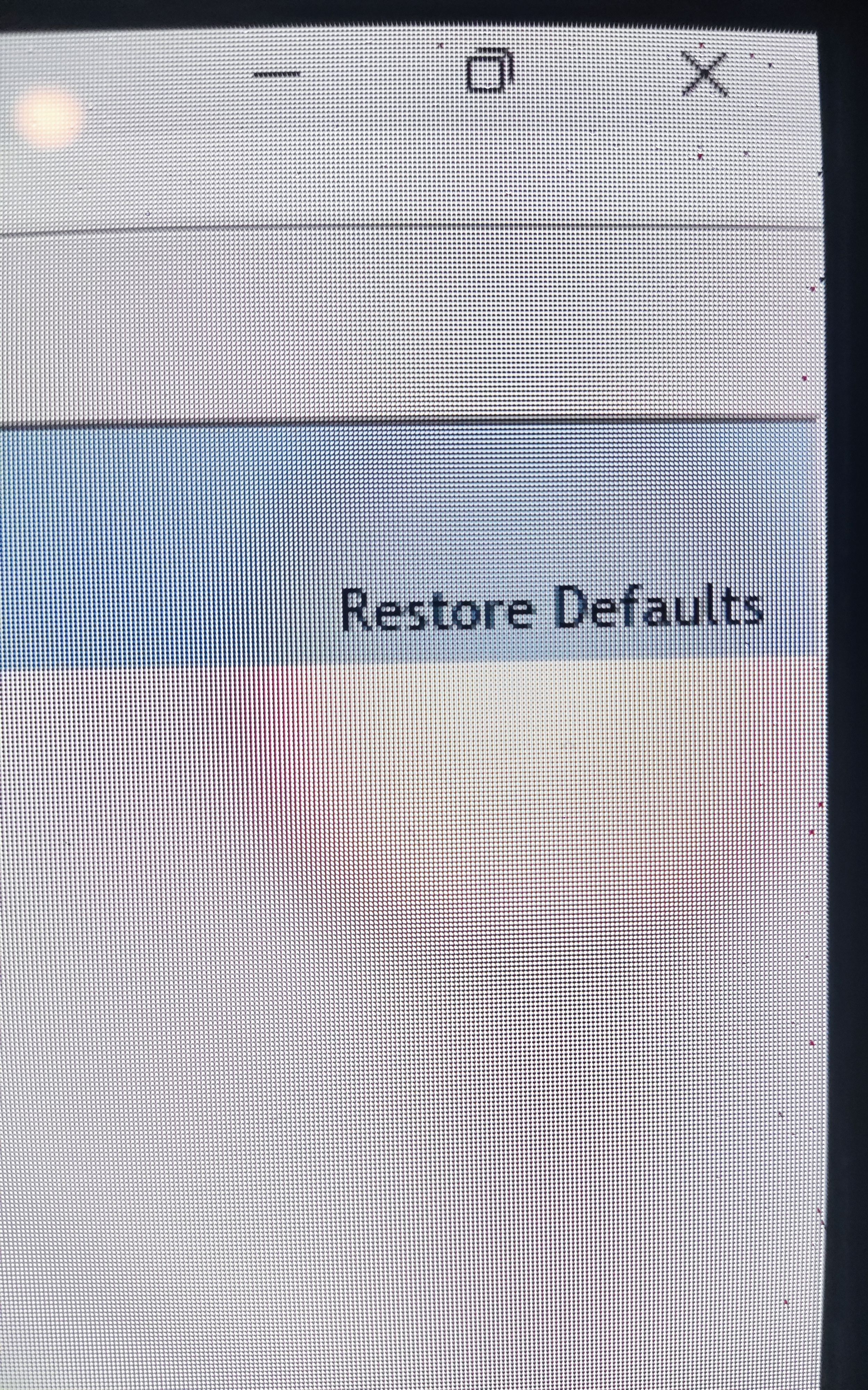

Guess it can't hurt to ask the retailer or LG but I was sure it was only 1 year. Here's how mine looks up close.
Huh, whaddaya know it is 5 years. You read online about how some people have to fight customer support to claim warranty stuff. It went pretty smoothly for me and I got a pick up scheduled for this week. Let's see how it ends though..
