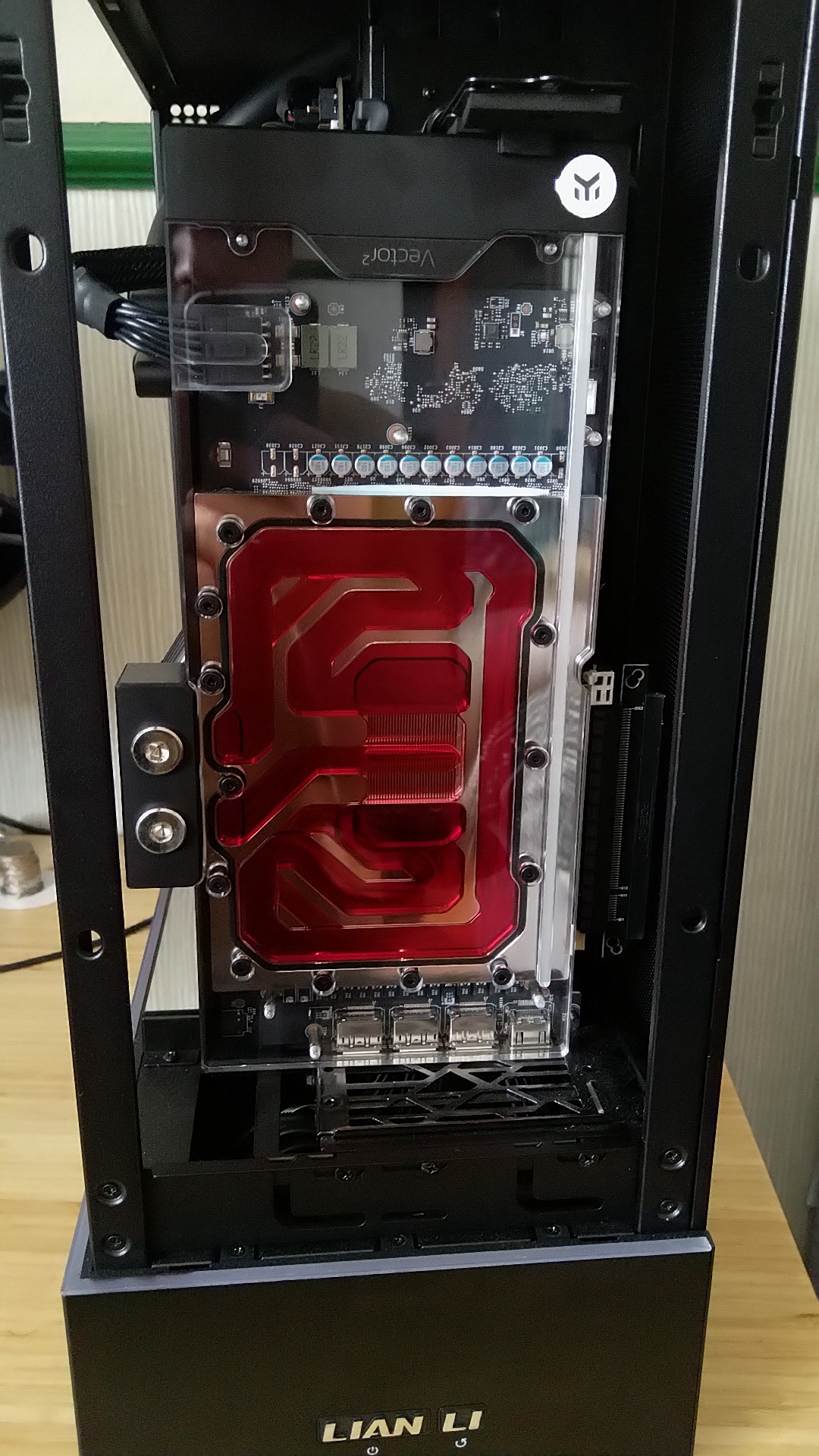

i did and managed a custom 360mm (x2) loop, gpu has been changed to a 4080s instead of the xtx in the post due to damage found.
once you work out the layout its a very unique design and cools well :)
I'll get some updated pics in the light of day, too dark now.
I was sceptical when i first saw the sup-01, but having lived with it for a few weeks its looks and design are growing on me in a good way, to have the ability to supoport 6x120mm fans or 3x120 and 2x140's in its footprint is very impressive, custom loops work very well.
There is one downside and that is lack of dust filters at the rear of the case, but a clean every few weeks will sort out the dust no problem.
Be very interested in pics too thanks, like the look of the case as an air option but thought a bit limiting for water. Have a pair of XR5 rads already so interested how you got them crammed in :D
with out further or do here are updated pics of my sup-01 build

Apologies for the red coolant, bit of a sin with a nvidia gpu, but i was running a all amd rig until my 7900xtx started to play up (didnt like the riser, noticed damage on the card that explained why)
Bit of a rats nest i wont lie, but only the rad fan cables, everything thing else critical is tied back to the mobo tray to give the maximum amount of room for the fans/rads, super close but it works.
Awesome thanks, looks very doable then given the gaps to route the tubes. I have a Leakshield I would want to incorporate so would probably need a res which would add some mess, the all in one pump/res/cpu block looks to help for sure.
i did think about a seprate pump/res but in the sup-01 room is at a big premium, the lower section in the front below the gpu is the only real place but you have to take into account the display cable that will be sticking out from the card, if your psu isnt too big you can move a pump/res unit back but have to plan like mad to manage the tubes and cables, going the cpu/pum/res way frees up room and possibilites.
