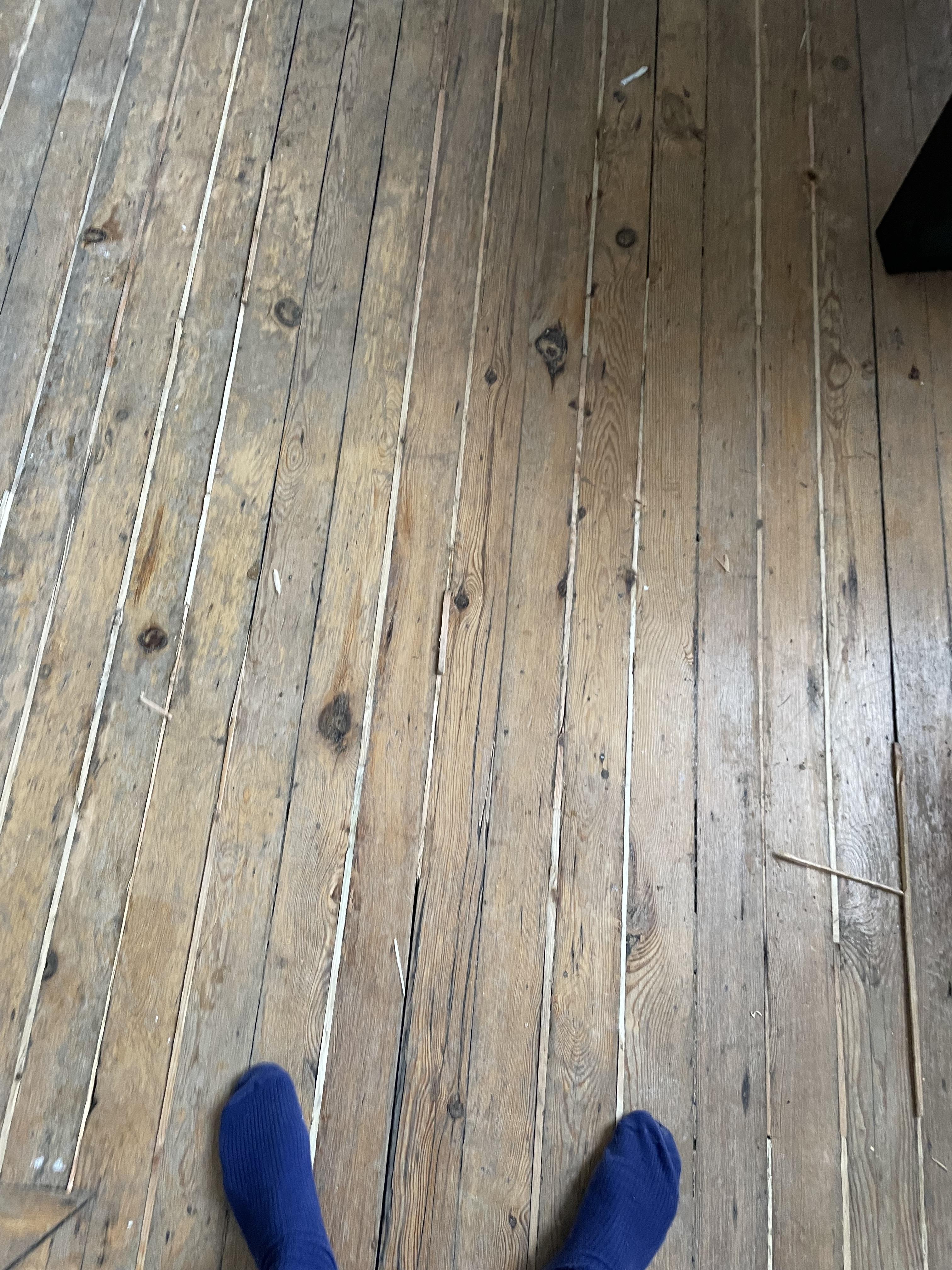

From the look of my floors can we determine they are, indeed, pine?
I'm trying to find out how to finish them.
I want them to look like this:
Sand a bit and see if it looks like that.
The picture you put up is a freshly sanded floor with no treatment. So whatever we you do it won't stay like that once you put a finish on it.
