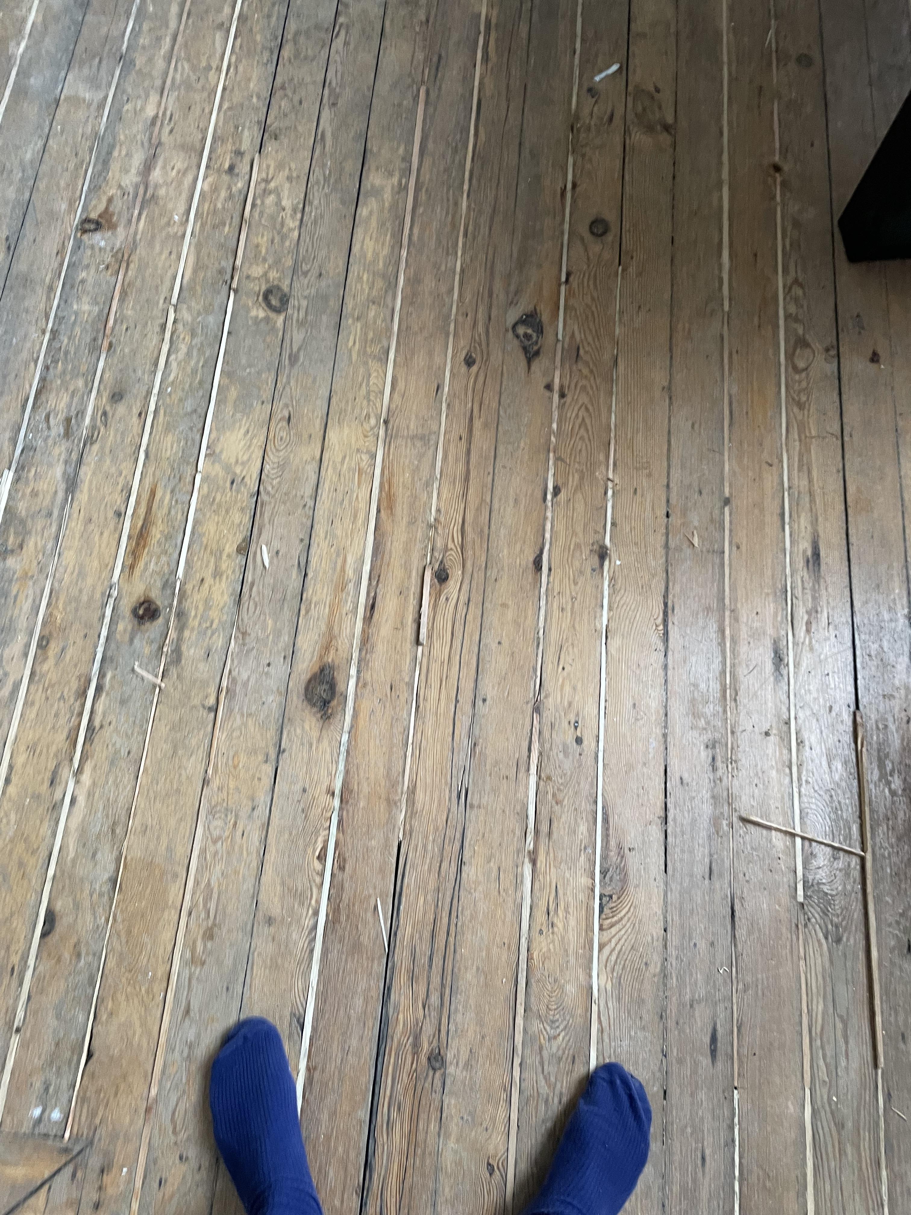

From the look of my floors can we determine they are, indeed, pine?
I'm trying to find out how to finish them.
I want them to look like this:
It's not going to look like that - that's fresh wood. Certainly not for any period of time at least.
With the different shades you're going to be bound to still have even with it all sanded / vs the new strips - I'd suggest going for a darker, perhaps richer colour.

You're never going to get it looking like perfectly even new floorboards. If yours are old as you say they won't be perfectly level and smooth, they'll have 100 years of knocks, wear, warping, drying and they won't have been perfect when laid. Especially if the building was a warehouse or whatever. If you want them to look like that, you're going to have to lay new flooring on top.
I'd suggest sanding them down as best you can so that they're back to bare wood so far as possible and applying some sort of stain or coloured finish.
I've not used their flooring products, but I found Osmo Oil really good on my interior wood.
https://osmouk.com/colour-your-floor/
Perhaps something light coloured would be enough to blend it all in?
I'd suggest getting samples before committing though! -
Edit - £1.49 a sample https://www.wood-finishes-direct.com/product/osmo-colour-foundation

The belt sanders can be a bit of a handful the first time you use them. From your video it looks like you've gone against the grain/not with the flow of the boards. Is there a way on the underside to adjust the sandpaper so its not so abrasive.
I used one years ago for my parents and didn't find it too bae once I got going. Nails sticking slightly proud ripped the sand paper but it wasn't too bad. I only went with the grain/direction of the boards, then used a big handheld orbital sander for the edges. That was quite tricky to tame but worked well.

Are you planning on filling the smaller gaps too? Would be a shame not to do it all.
Boards are coming up nice. Ide be careful with the PVA as whatever you choose to treat the wood with may not soak in the same way and it might stand out.

Oh god don't tell me it's a waste of time. Everything is covered in dust now and I feel committed. According to a "wood guy" the floor is slow grown Douglas fir which is "really really nice wood" though I don't know what that means. I'm hoping to get them looking nice. Tbh it's a bit of a learning curve for me and it's something to do. I feel that as long as I keep doing DIY projects I'll be able to pass the time until death.

That is nice wood. It had probably grown for 100s of years, where what you buy in the shops is probably 20 years old or something. They longer it grows, the better it is I think (are we still talking about wood?).

Slow growth as opposed to long, in a way. Length of growth is just a function of (how fast can it grow x how big do you need it) :p
Trees that grow slower typically have denser or harder timber as the same resources can go into a thinner layer of growth. Growth rings mark the seasons - they are darker denser wood which was formed in the winter when there's less sun and so, less resources. Therefore for any given size of timber, slower grown stuff will have more rings (which are the stronger part of the wood) and typically be denser too.
Especially true for pine as it grows so damn fast, the cheap stuff is mostly pale soft wood in-between scarce grain (winter growth) lines.
