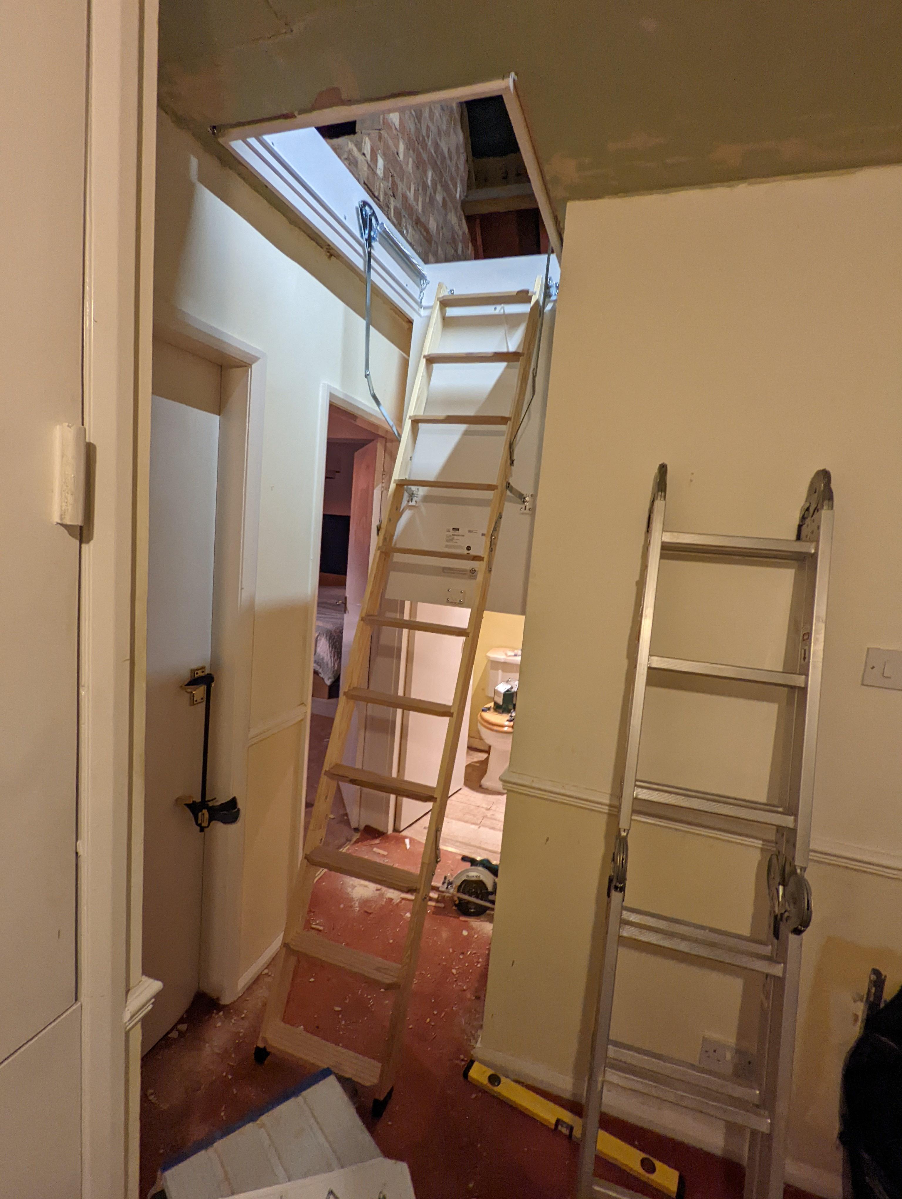

Wow thanks for the quick reply and advice. The loft hatch is the original from 1981 so isn’t insulated and has no seal, so gaps visible in to the loft above but due to the swing action it would be difficult to seal these with strips or anything. I don’t think the ladder would work with the raised board height, but i will take another look this weekend. Worst case, I was going to leave the ladder at a lower level and look to change the hatch/ladder at a later date.

You could change the hatch to incorporate one with a built in ladder. May need to make the opening bigger though. Not a difficult job to do.

You can't insulate those properly so don't bother. Just get a bigger ladder.

I got lucky and the existing ladder had an extra click.

FYI you can get insulated loft openers with ladders fixed to them, eg I fitted this below

That is epic! 300 bux tho. I will definitely upgrade to one of those when it becomes a priority.
My what a big hatch you have ;) :p
Must make getting things up and down from the roof much easier.
It's not the size of the hatch that matters, it's how you use it. Small hatches just need a bit more effort to get the same result, plus less chance of things tumbling back out on top of you ;)

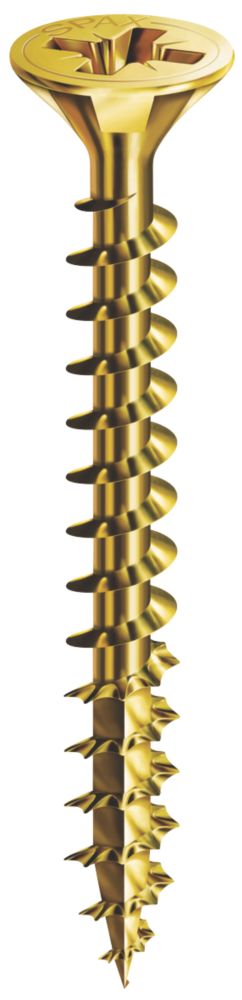

I applaud the choice of spax screws. Those and turbo silver are my go-to's. They both self cut at the common sizes which makes things so much easier, and I've had very little screw snapping, if any, with them.

Yep to be honest its the only screws I'd buy /use these days.
What makes the spax screws good? What driver head do they take?
I ask because i been using what i deem as 'ordinary' screws and they are naff.
PZ2 heads, though there is also a Tox option for more money. Quality is good, decent corrosion protection, and they have a self cutting tip and csk head - see screwfix images. Heads also seem to last without losing their definition too. i.e. you actually have a chance of getting them back out again. Turbo silvers while a different brand seem similarly good, just in a bright silver finish rather than the anodised colour of spax

I bought a box of Goldscrew for the loft, and ran out and ended up using some spare SPAX I had in limited quantity. Night and day for going through floorboards/into loft legs. Expensive though.
yeah Spax aren't cheap, but after a few rounds of misery trying to get floorboards up that were fixed with cheapos where the sparky used an impact driver on them (and stripped the heads), or trying to install cheapos that snap apart while screwing them in leaving the shaft in the hole, then I remember why I pay the extra.
