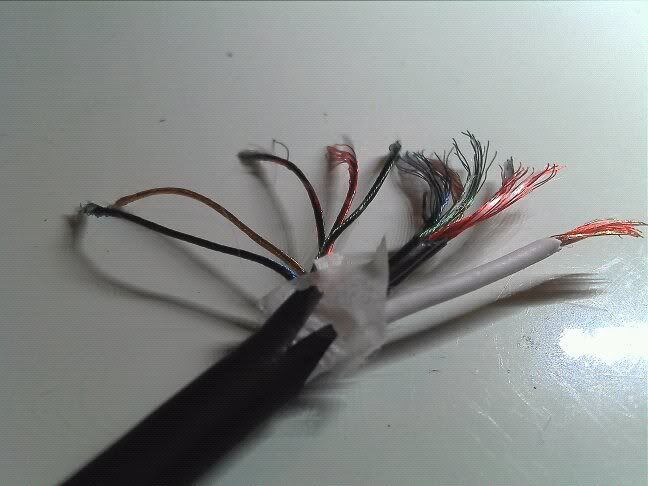

Ok second one of these iv'e fked, sat on first on and broke actual headset, second one was plugged into laptop and usb got bend, have cut the wire halfway off the first one (usb still perfect) and was seeing if i could reattach it to the second one, anyone know if this is possible with these weird 'furry' wires..

i've done this rubbish before with my xbox headset, they have this coated crap on the wires and i used a lighter to burn it off, i held the lighter over one wire at a time but not for too long just enough time to see the coated crap burn away (usually it catches alight and burns down the wire) then i found that you HAVE to solder the wires to get the thing to work and twisting them together for some reason doesnt work properly, its possible, just takes a while, and may look a bit ugly at the end but who cares :P
