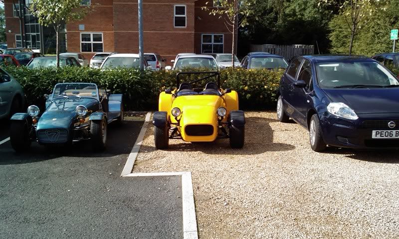

Ditto on my Westfield - top and bottom arms parallel which equates to 165mm ground clearance at the front and 175mm at the rear.
IMAG0036web.jpg~original
Not a great pic but you get the idea.
