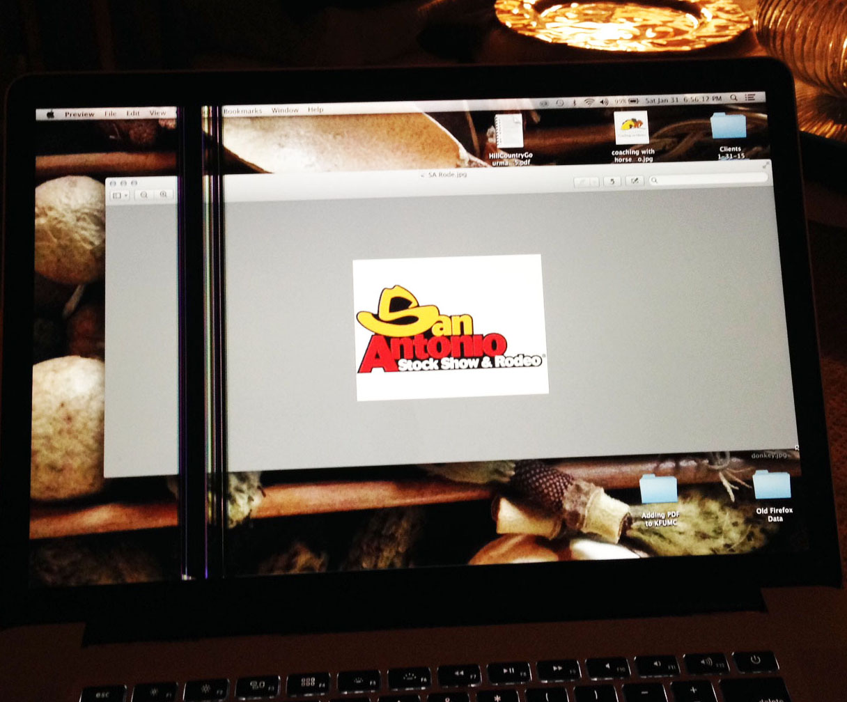

Looking back at this I've gotta say thank you for posting that as, though it is almost the opposite of what I described in the OP (vertical light areas instead of horizontal back lines) it does actually seem to be related and I can now see that issue - am not getting the black lines at the mo:
So on that basis (4 years) it seems my screen is allowed a free repair under the above program... also the keyboard issue under this one:
Looking at known issues I guess the keyboard issue might be fixable for up to 4 years:
I'll give Apple a try and see what the deal is under lockdown... then again no big rush - so long as stores open again at some point within next 9 months!
Got a pic of the whole screen? Are you talking about the black areas near the icons on the dock? If yes, then that would be covered under Apple repair program mentioned above. It's caused by the screen cable overstretching.
50 million edits later (I kept reading it back to myself and not being happy): If you're talking about the black thin lines which are near the white thick faded line, then that looks like the Display is damaged. This could have been caused by either the display itself taking a knock or the the Display Cable/Display header on the logicboard being damaged (which would explain it being intermittent). These wouldn't be covered under a repair program and you might have trouble claiming on consumer law. Apple have a set of visual guidelines they compare against which they use to determine what is elligible or not and if it looks like accidental damage they will probably deny.
Yep :)
Nah the display isn't damaged (re: the black lines), it's either some connection or overheating issue. I think you misread my post you just quoted - the black lines issue is not there in the photo I posted (it is intermittent), I posted the picture to show the issue the poster I'd quoted referred to - the vertical lighter and darker areas showing in the image.
Not quite sure what you're referring to seeing there - either a reflection or the OCUK forum layout which includes black and white lines. I'll try and take a photo of the black lines next time they occur.

Yep :)
Ahh ok, yea I did mis-read your post apologies, you quite clearly said 'am not getting black lines at the mo'!
Now that you told me your screenie is good old Ocuk I can see it now. I've used a black theme on Ocuk for so long I didn't think about Ocuk and thought the lighter blue bit was damage and the shadows on edge was the black lines :) That's why I were asking for a whole screen pic as I wasn't sure I was seeing it properly. The issue I thought you were describing is something we see a lot from knocked screens etc which start off as thin lines and worsen over time, and if this was the case Apple wouldn't honour the repair program problem even if it was obviously a separate issue as the same part has 'accidental damage'.
You should be fine then, you will be covered for the stage-lighting type issue by the repair extension program so wont need to worry about the consumer law.
