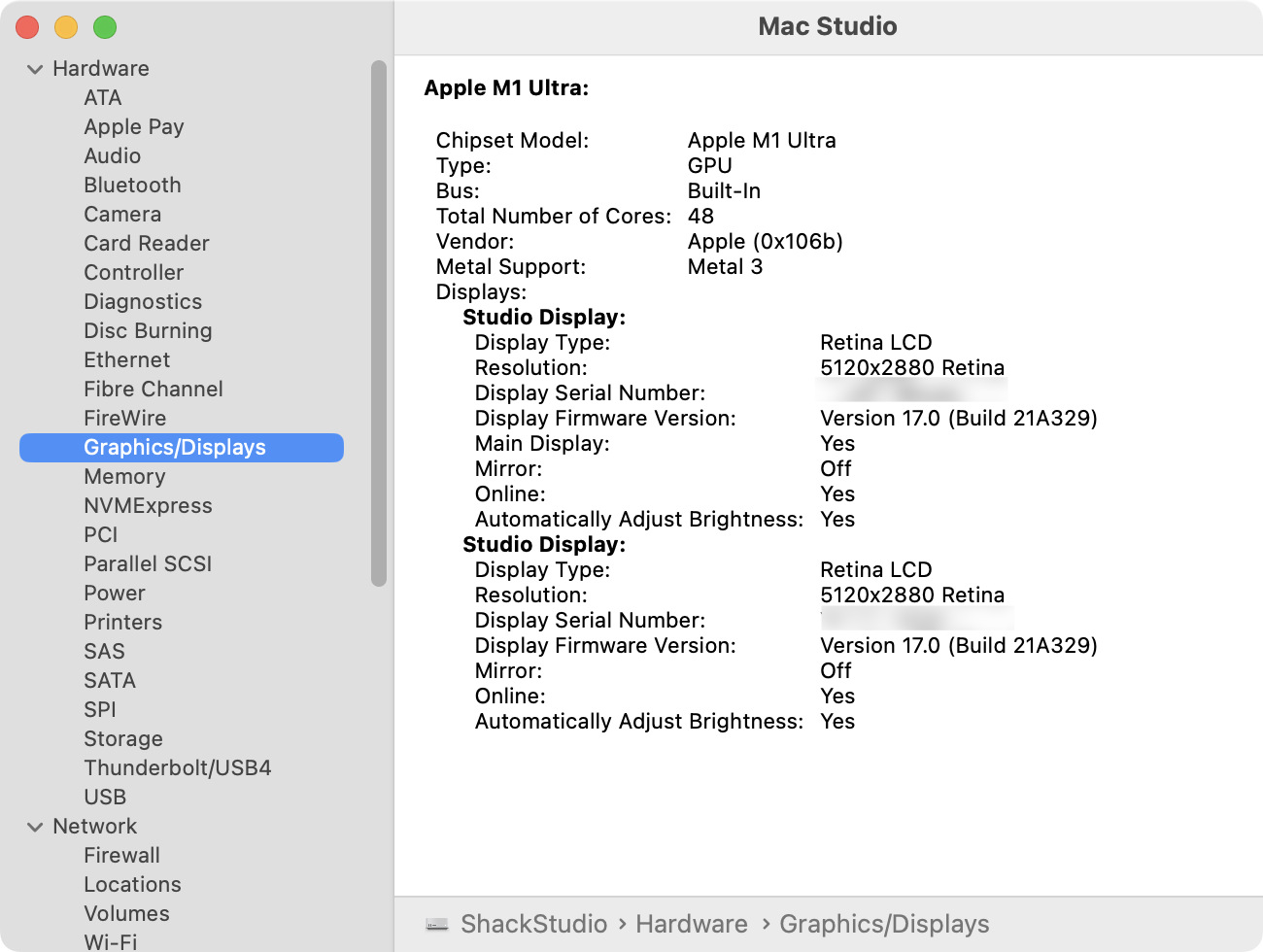

This is what my Studio displays show.
Looking in system settings/displays, I run them at 2560x1440 which is the default recommended setting. They look fantastic!

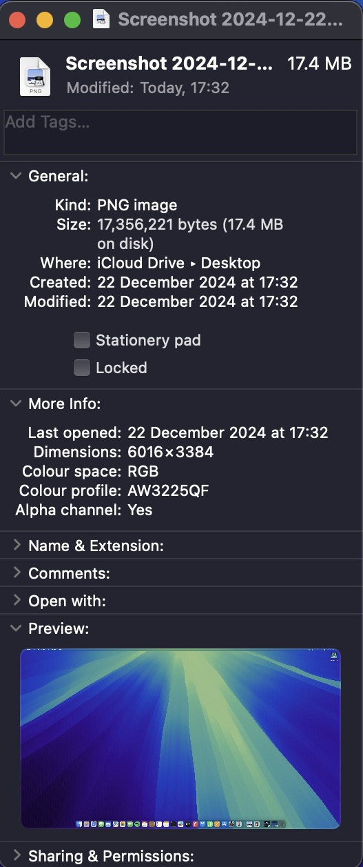

This is strange, took a screenshot of my desktop then looked at the info of the file that was created, it says dimensions 6016 x 3384. However my display is set to 3008 x 1692 not double that.
I know that in system report it says my resolution is 6016 x 3384 but it also says UI looks like 3008 x 1692. My monitor isn't capable of anything above 3840 x 2160 anyway.
This is just how HiDPI scaling mode works on Mac OS. Presumably you're using BetterDisplay to enable HiDPI on more resolutions?
You're picking 3008x1692, HiDPI mode is doubling that resolution which means it is internally rendering your desktop at 6016x3384 and then BetterDisplay is scaling that back down to your monitors 3840x2160. If you're not using BetterDisplay then it may be something specific to your monitor which is making that resolution available as HiDPI.
