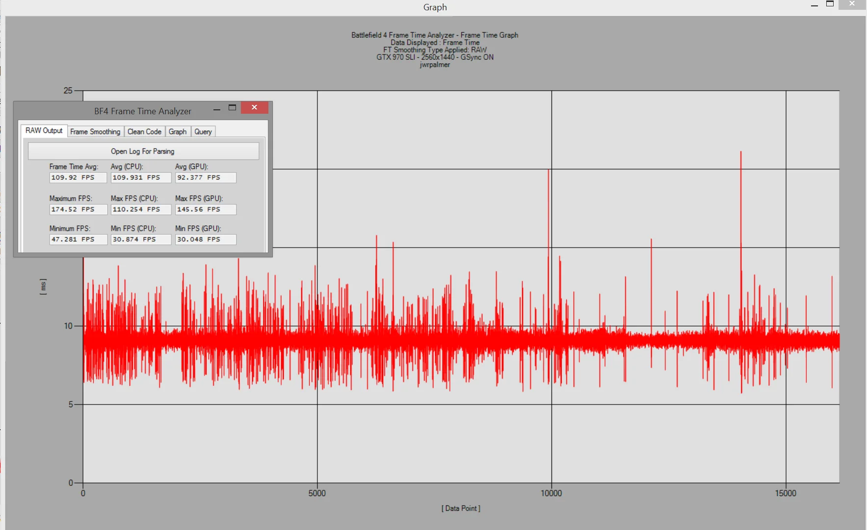

So going from Jwrpalmer's results, SLI is smoother than a single 290 :)
Also, could you put that image behind a spoiler please as it is too big for the forums :)

Shankly's results are a thin line which is more consistent than a fuzzy one, the line rising is down to frame rate dropping and having less gpu grunt in general.
A straight line at 20ms is no less consistent than a straight line at 5ms, it just means that the frame rate is lower at 20ms.
This is correct. Ideally you want a perfectly flat line like Shanklys on the left. This becomes a bit more difficult to achieve when using more than one gpu. Also worth noting that more gpu's will have a lower ms time because they generate more frames. Does not always mean a smoother experience though and those spikes we see indicate variance and a frame taking longer to render than the previous one. A little variance is normal and to be expected. Only once it passes a certain mark does it usually indicate stutter. The good thing about Mantle is, typically that variance is considerably lower than any other solutions available.
