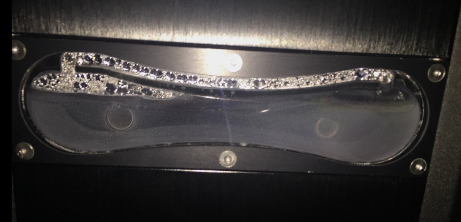

Hello, just wondering if any of you guys have been using this XT-1 stuff for a long time? I switched to it later last year but recently ive noticed my temps on my CPU getting higher and higher until yesterday it hit nearly 90 so i removed my overclock.
Does this stuff tend to need changing quite often? Does it gunk up the CPU block or summat? Im not sure as i've only use water in the past so im not sure if i should be changing it and cleaning the CPU block or summat? The GPUs still look fine, theres a little residue in one but hte temps are fine and the fins look clear.
I used blitz before i filled so everything was nice and sparkly clean butI have'nt had time to take the loop apart yet so ill do it over the weekend and see whats going on, just thought i would check to see if this is normal with this stuff to need changing already.
