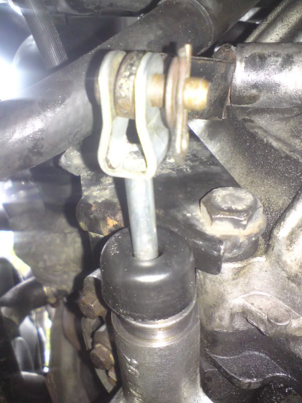

It seems the join/weld between the arm that goes to the slave cylinder and the shaft into the gearbox has sheared, causing the slave cylinder to pop apart.
Pics:
Is it time to get it towed in? Absolutely gutted.

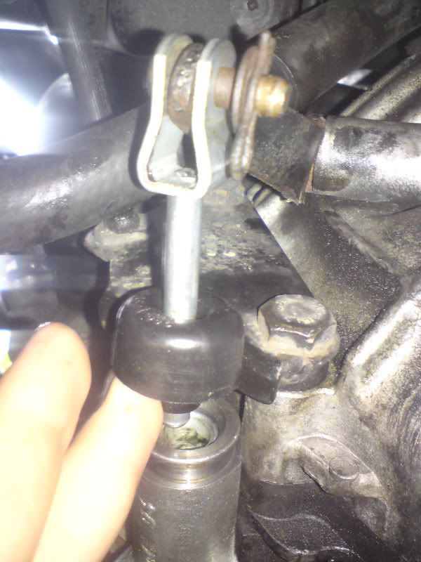

Where the arm meets the shaft into the bellhousing, the metal is bent and there is a clean shear on one side of the weld.
Anyone have any idea what happened?`
Probably a weak arm, and years of life have made the input shaft go abit tight to the point where said weakness has said bye :p
On a plus side.. it looks like steel and not alloy so you can weld it pretty easily. How hard is it to get to?

Look closely at the picture - it's not the slave cylinder that's the issue. But I agree it's not the end of the world! :)
It will cost more in labour as I imagine to do it 'properly' the clutch arm/shaft will have to be removed, which, I imagine, the transmission will have to be removed. Then the arm/shaft to be ground and cleaned for a decent weld to be applied. Might be lucky and have it repaired in situ. Can't be quoted on that as I haven't worked on the 600's before.
Drop the box.
Remove the slave cylinder and armature.
Bend back, and weld.
Refit with new armature.
Refit gearbox.
Bleed clutch.
Prolly take a pro less than 2 hours. Prolly take me the better part of a day.

The problem has probably been caused by the clutch release shaft partially seizing in it's bushes, and the resulting stress has cracked the weakest point i.e. the welded section. Not an uncommon problem and certainly not a problem isolated to Rovers.
You might get it working for a while just by welding it and working plenty of oil into the shaft bush at the top, but ideally the shaft should come out and be cleaned up and greased (box out job).

360 quid all in, dropping it in sometime next week. That includes a new clutch - the other one was quite high.
Got myself a pattern part off eBay, very hard to find but one guy had them, £25 posted :)
Hope this sorts it!
