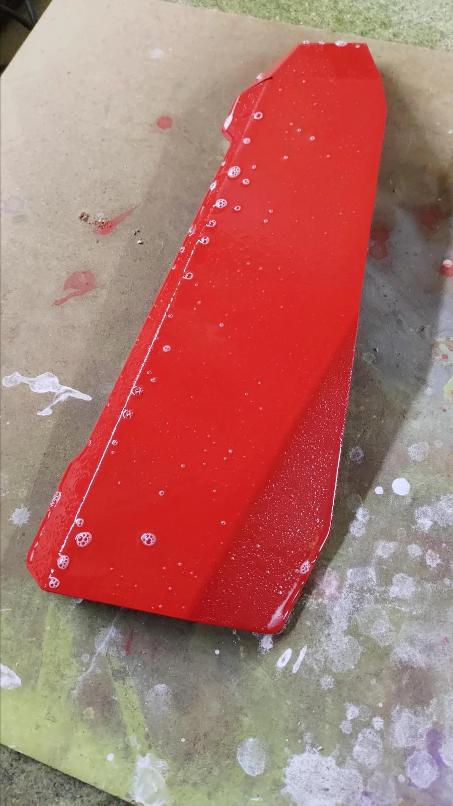

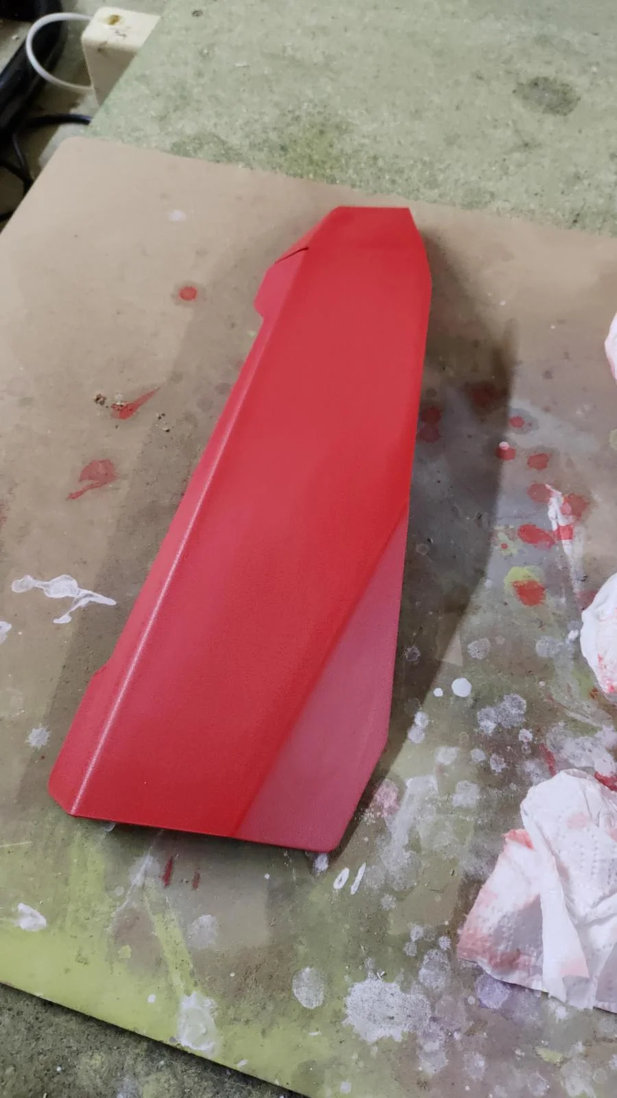

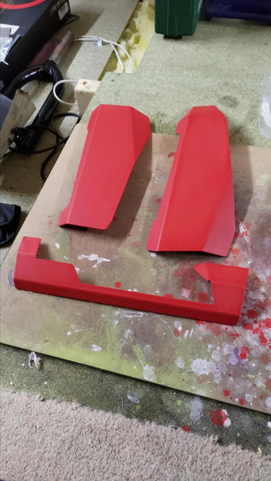

Hmm. Well, I have only used this exact paint once before. I usually opt for Kobra. Sadly they did not have the exact shade I wanted so I got Flame again. TBH? the last time I used this it really ****** me off. It was high pressure, and the orange peel was *insane*. This was low pressure, so instead of mad orange peel I got mad dripping.
When I looked up the drying times it said "working time one hour". Come again? Mission accepted.
Remember the drips?
Me either. Wet it down to see what your next stage will look like.
And do the rest.
And the aftermath.

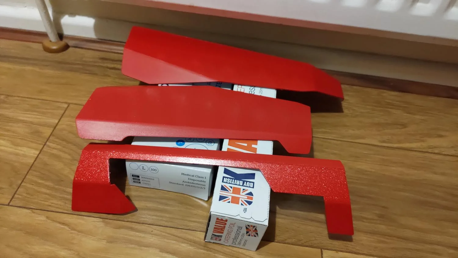

OK so this is about the time of day I usually get done. Have a shower, rest etc.

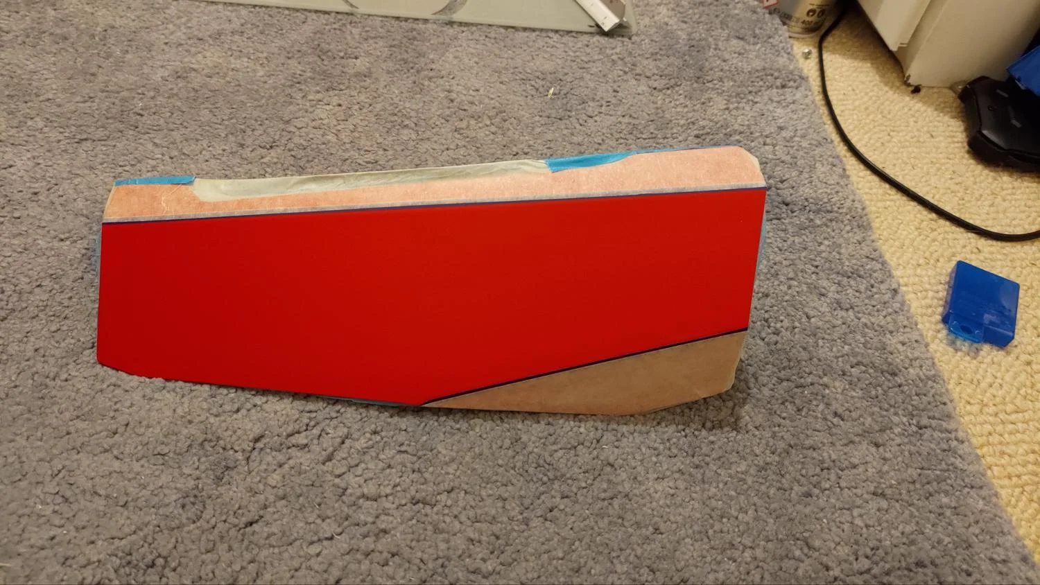

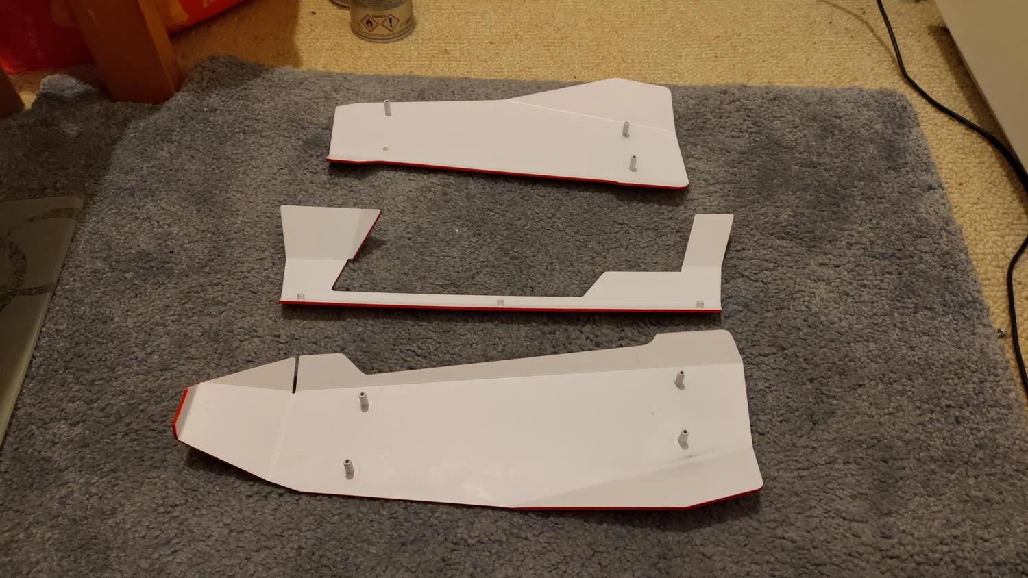

After giving it a very good clean I removed the masking. There is minimal bleed.
What I mean by bleed is where the paint bleeds under or into the edge of the masking. I expected this. The reason is I used the lower end cheaper masking tape for this stage. Like, the cream coloured stuff, not the more expensive blue stuff. The reason is that because of that white base coat I can just wet sand any bleed off. Bleed now is not an issue, but if the masking on the effects layer bleeds we will be in trouble, hence why I save the more expensive tapes for the more critical stages.
I also need to do some touch ups on the damage on that side too.

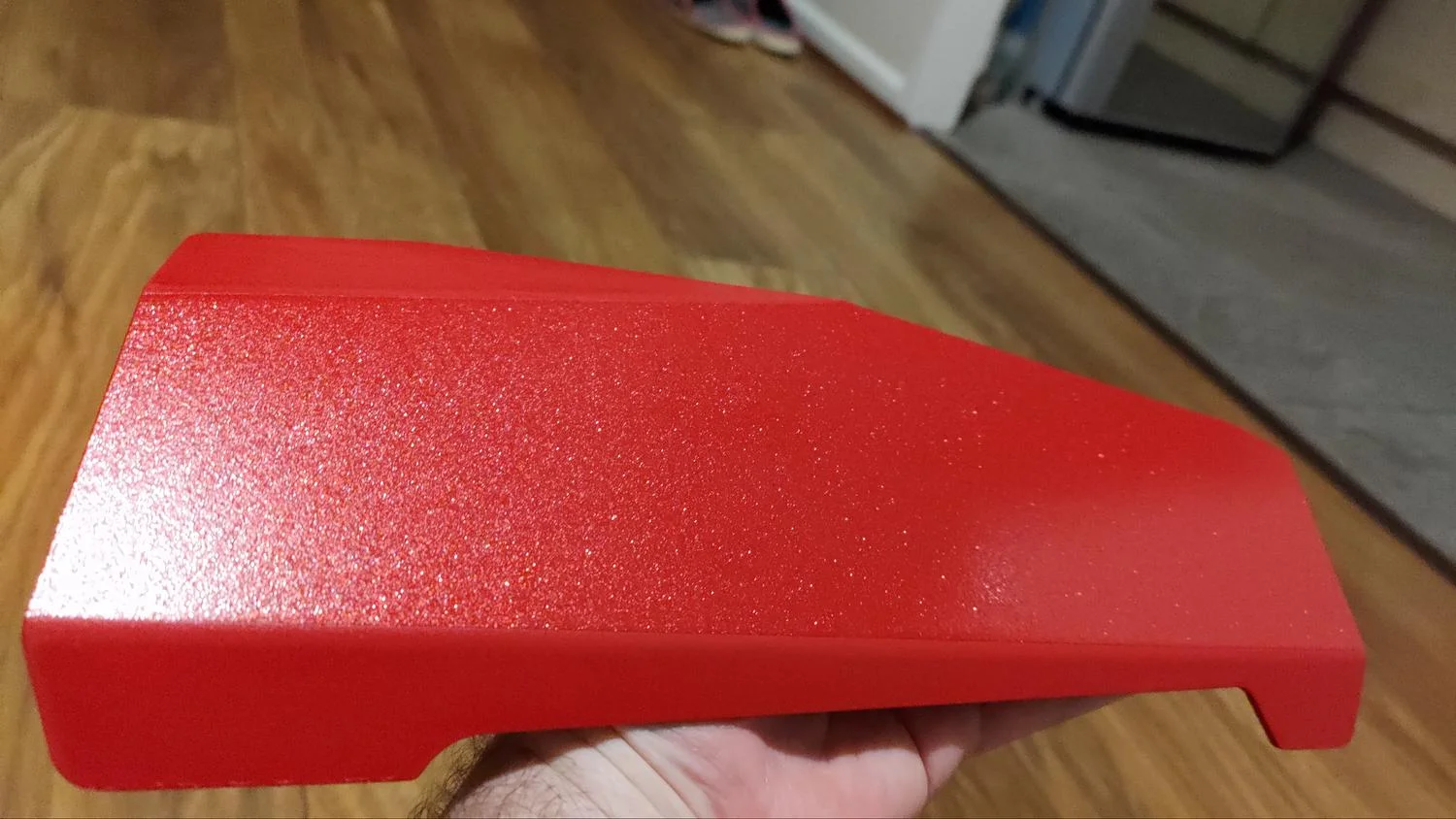

Remember, at this stage it will be very hazy. That's nothing to worry about. That means we have a key for the next stage. I now need to let it cure for 24 hours, before beginning more masking etc.

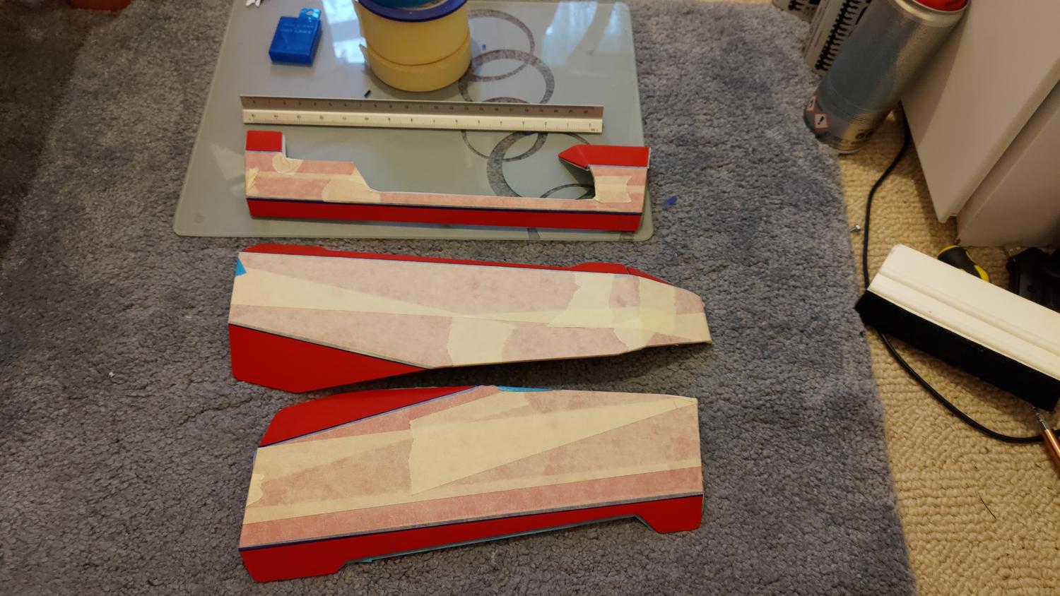

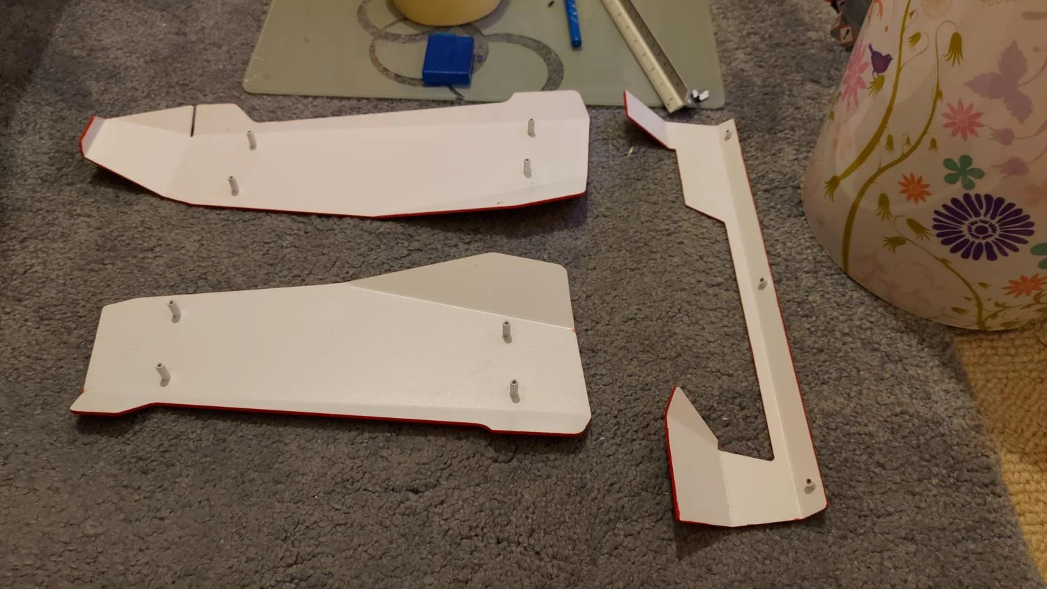

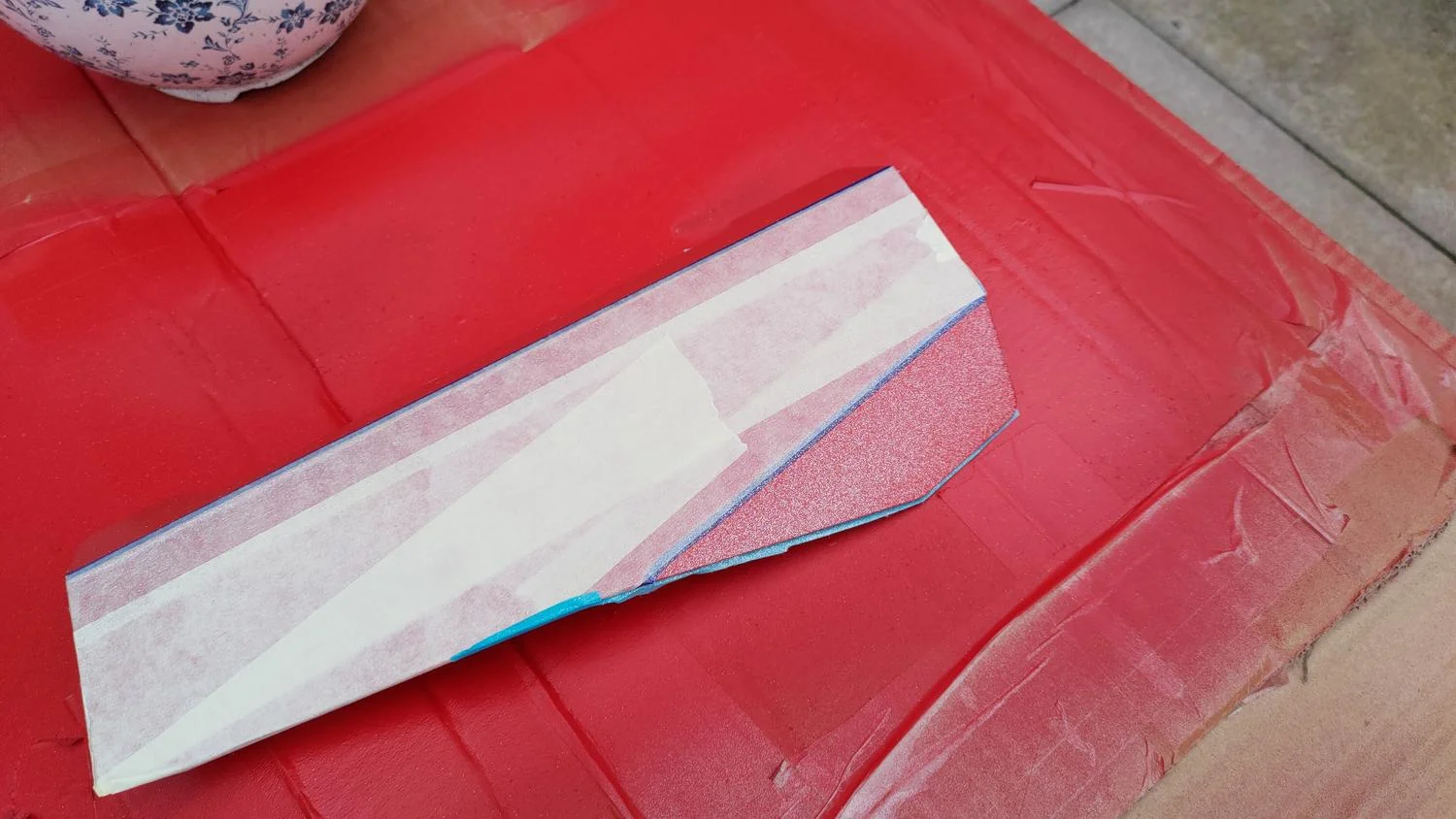

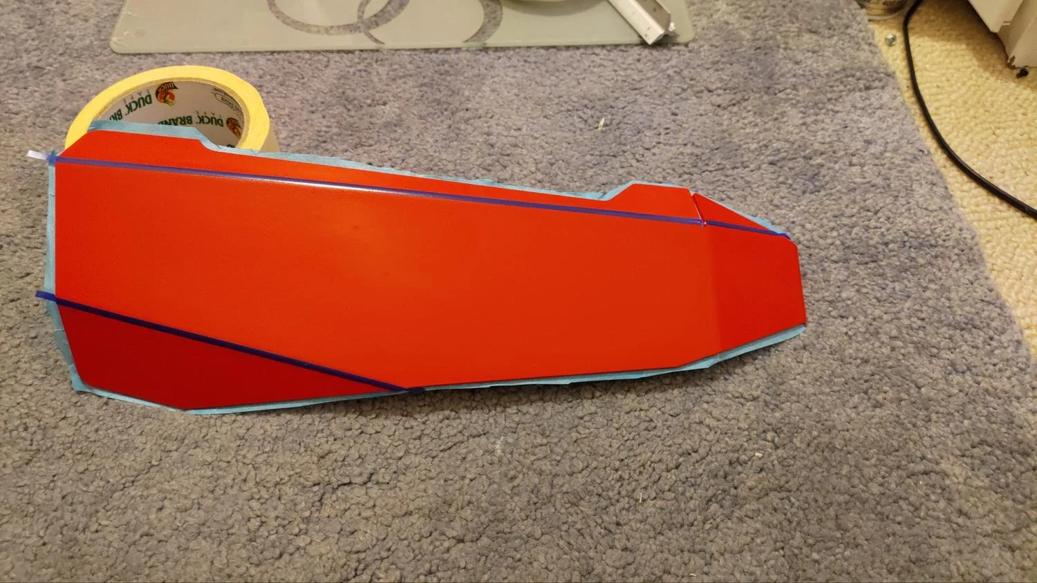

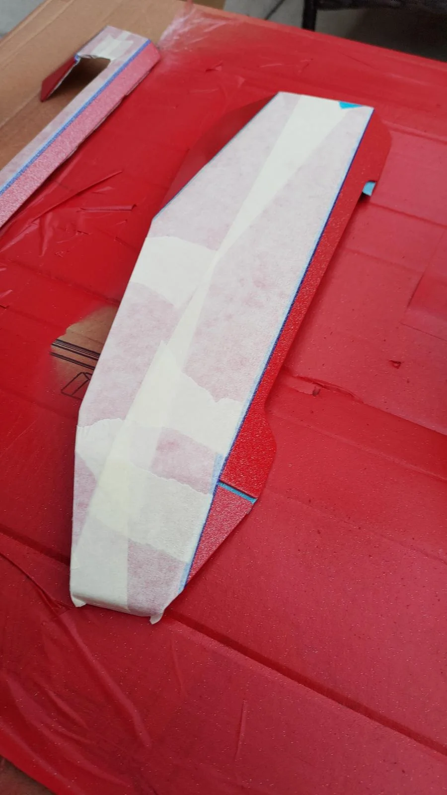

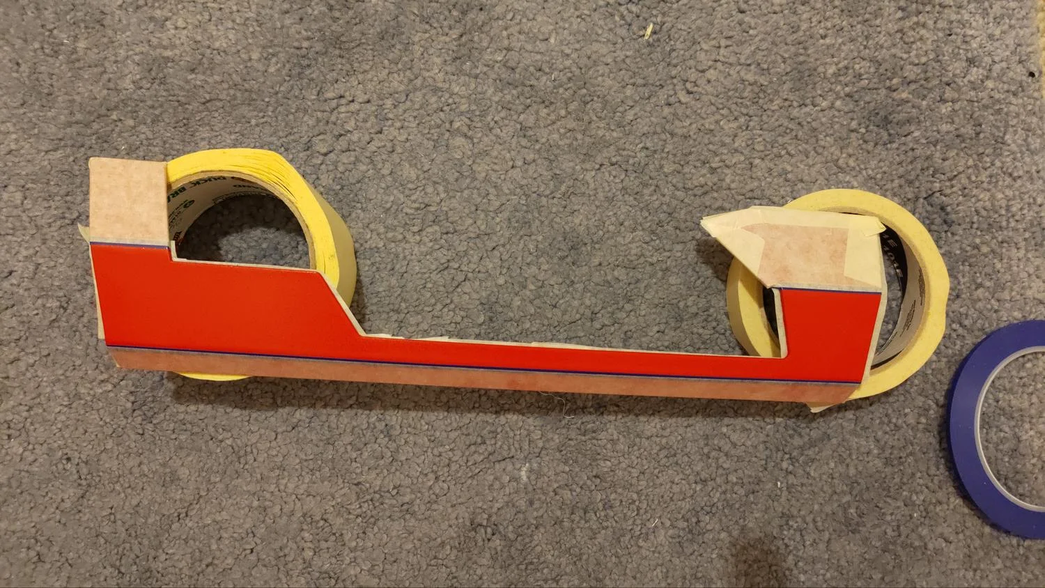

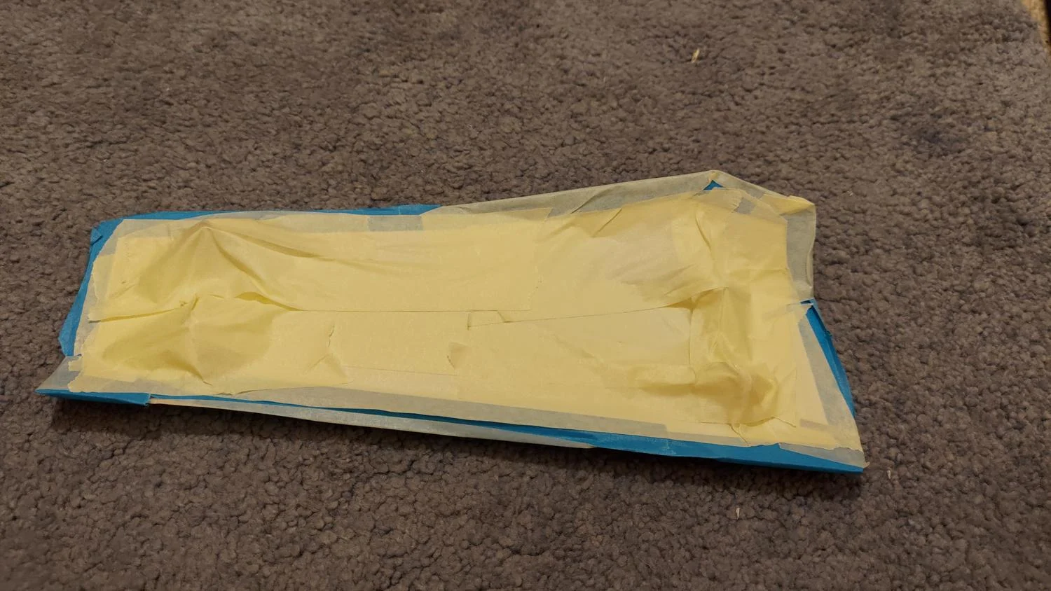

Tonight I did the first fine line layer mask.
Then masked off the rest of that panel.
Leaving exposed what will get the 2nd round of paint. Did the same with the other side panel.
Then onto the front piece.

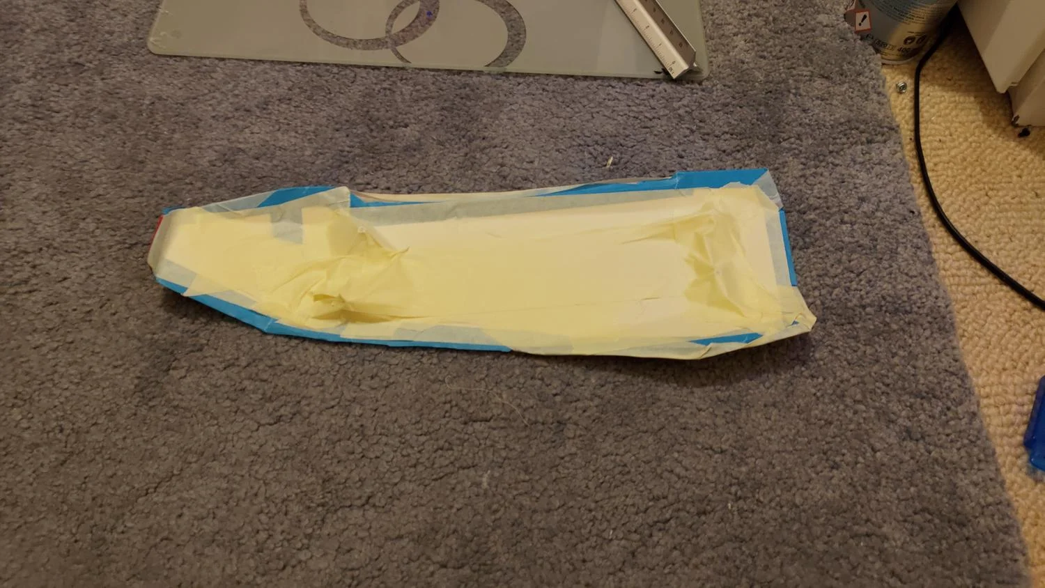

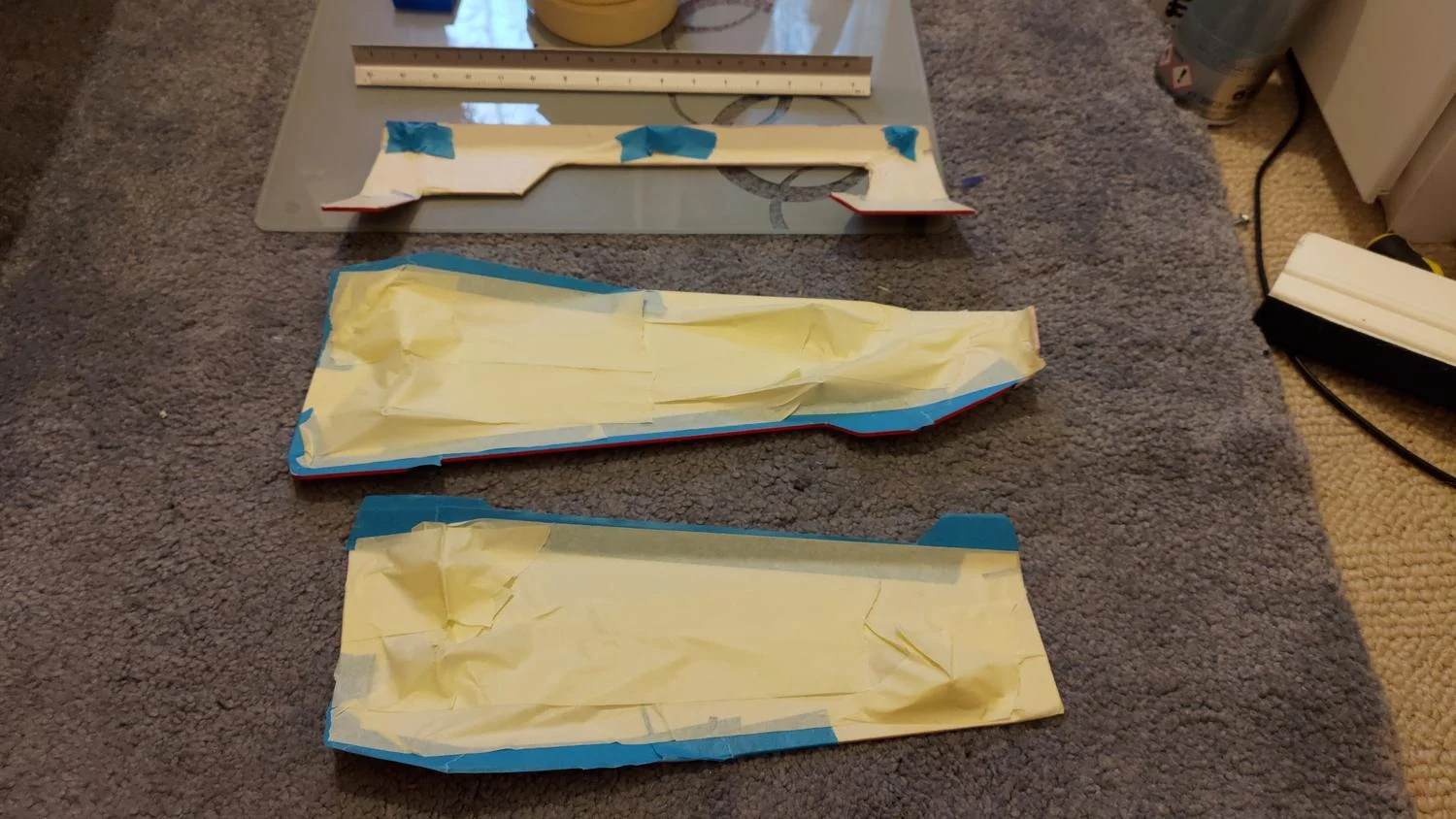

Then mask the backs again.

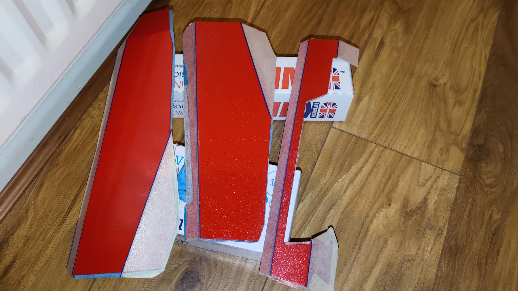

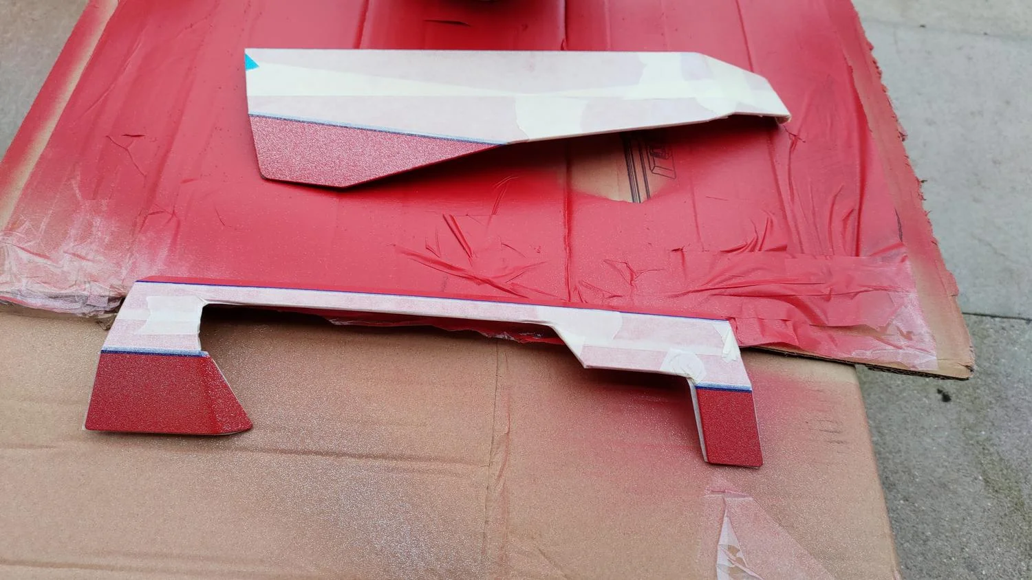

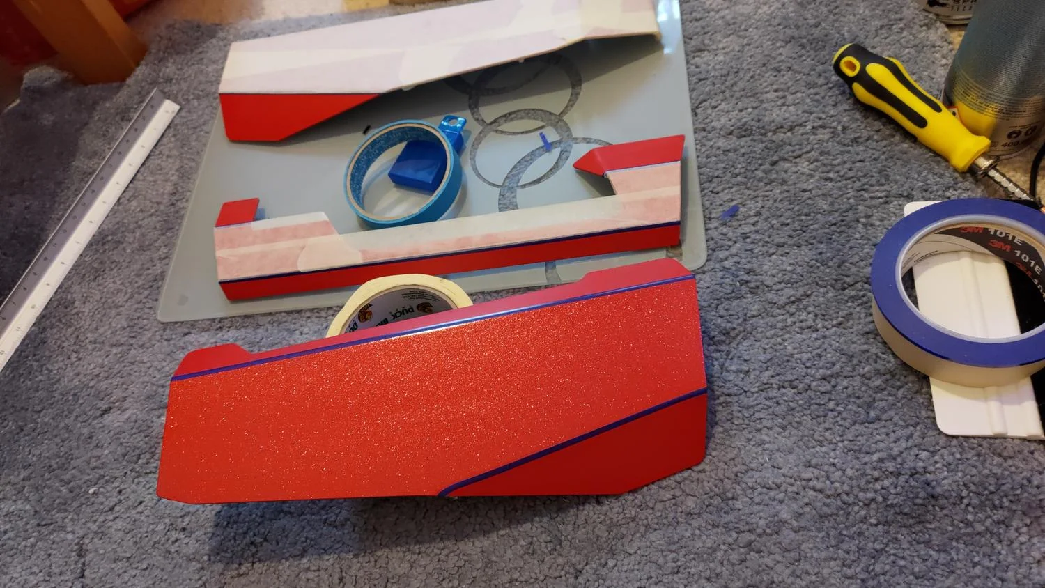

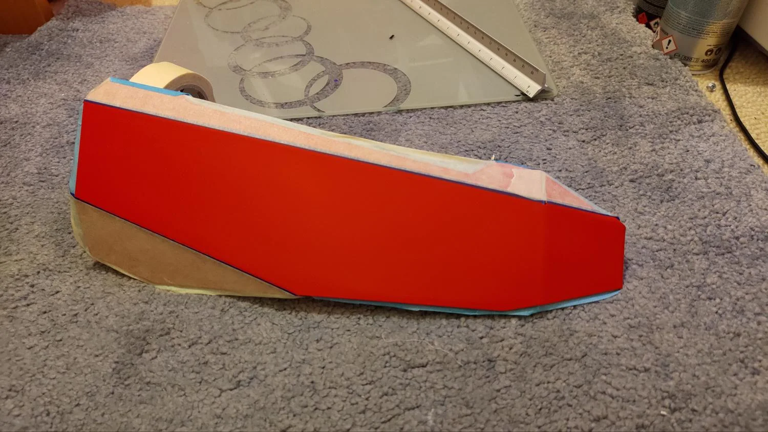

Tomorrow I will put down the first FX layer.
Decided to pull a late night. Given that like, 45 seconds are in actual painting and the rest in masking cleaning and prep.

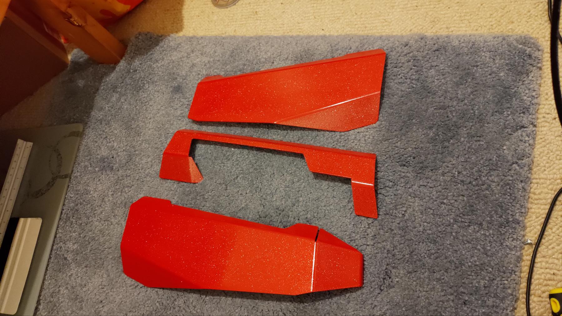

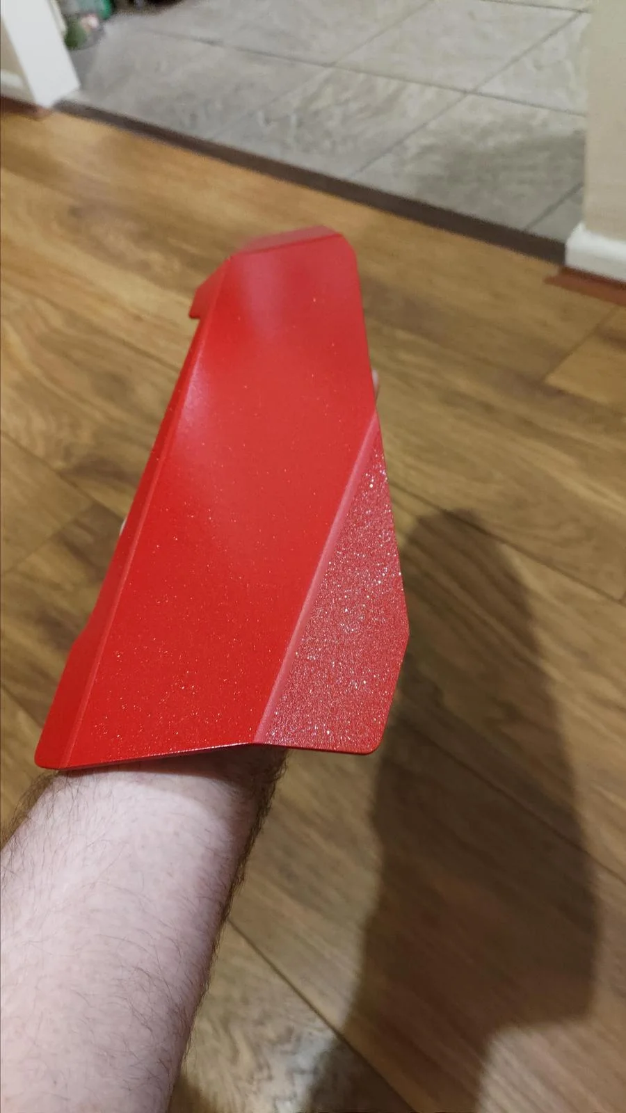

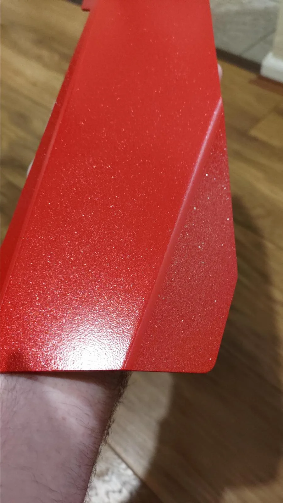

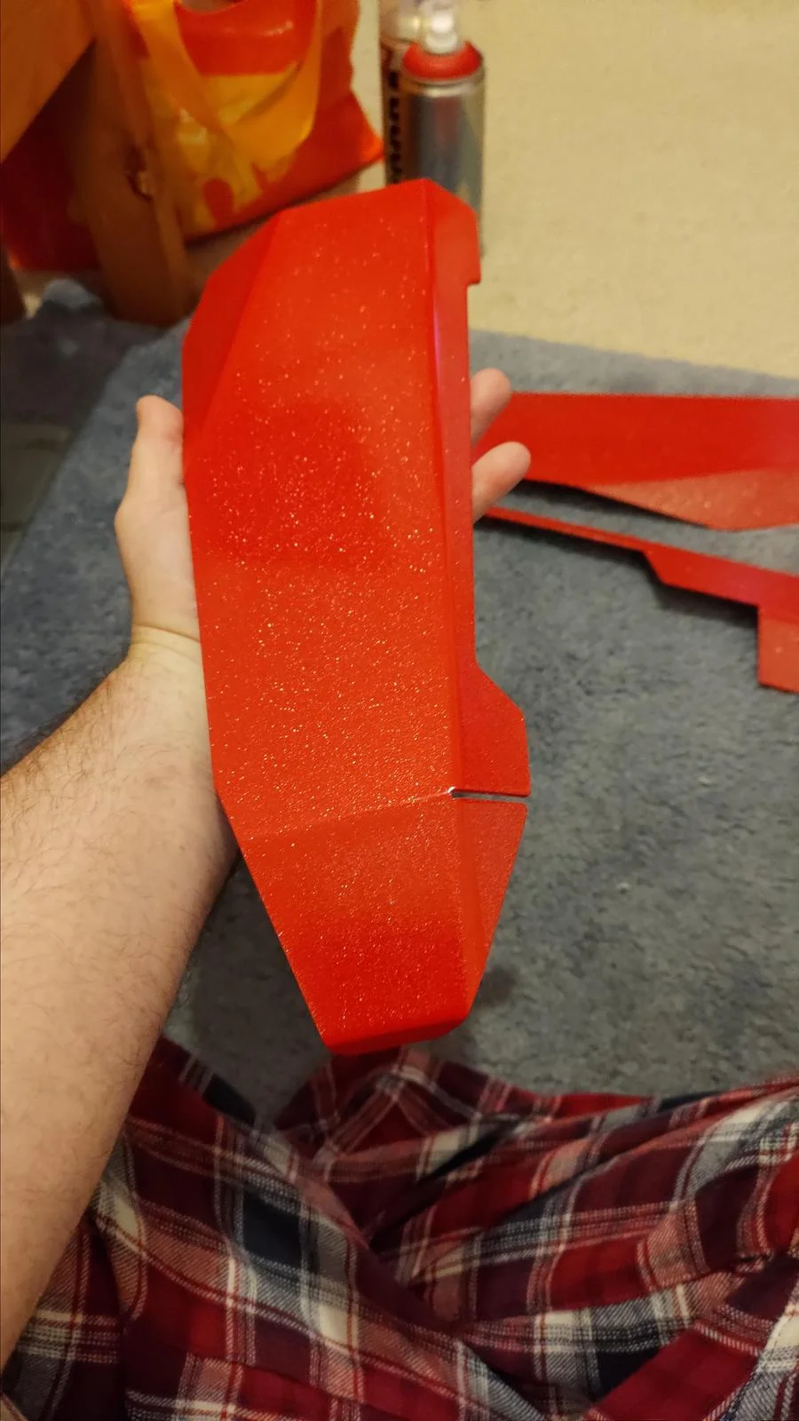

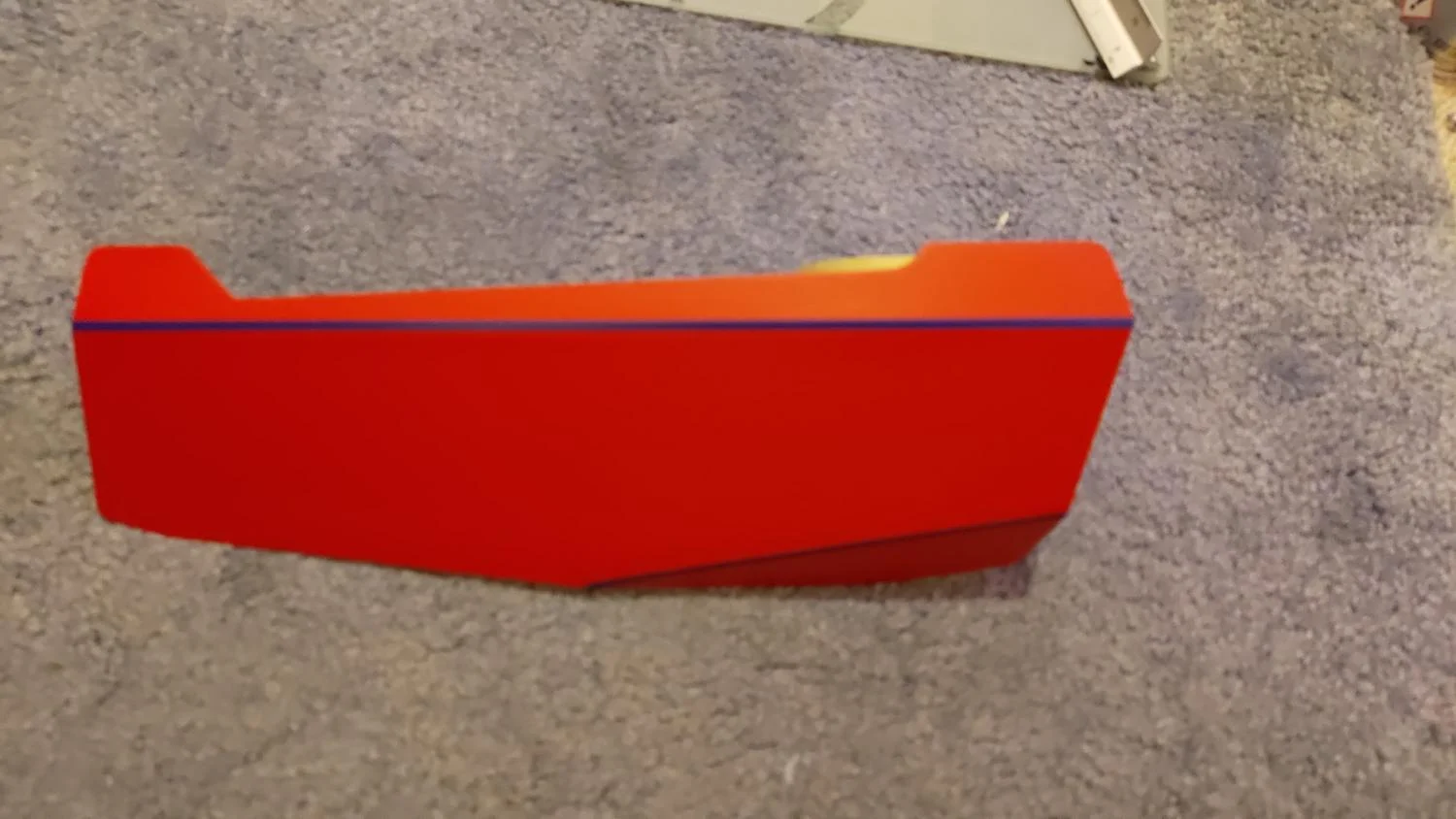

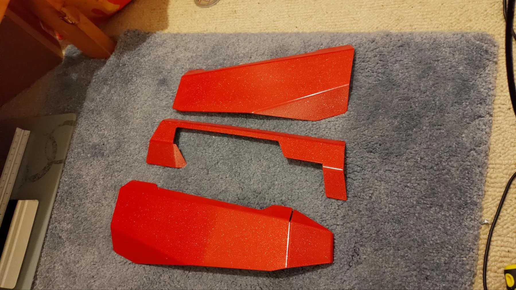

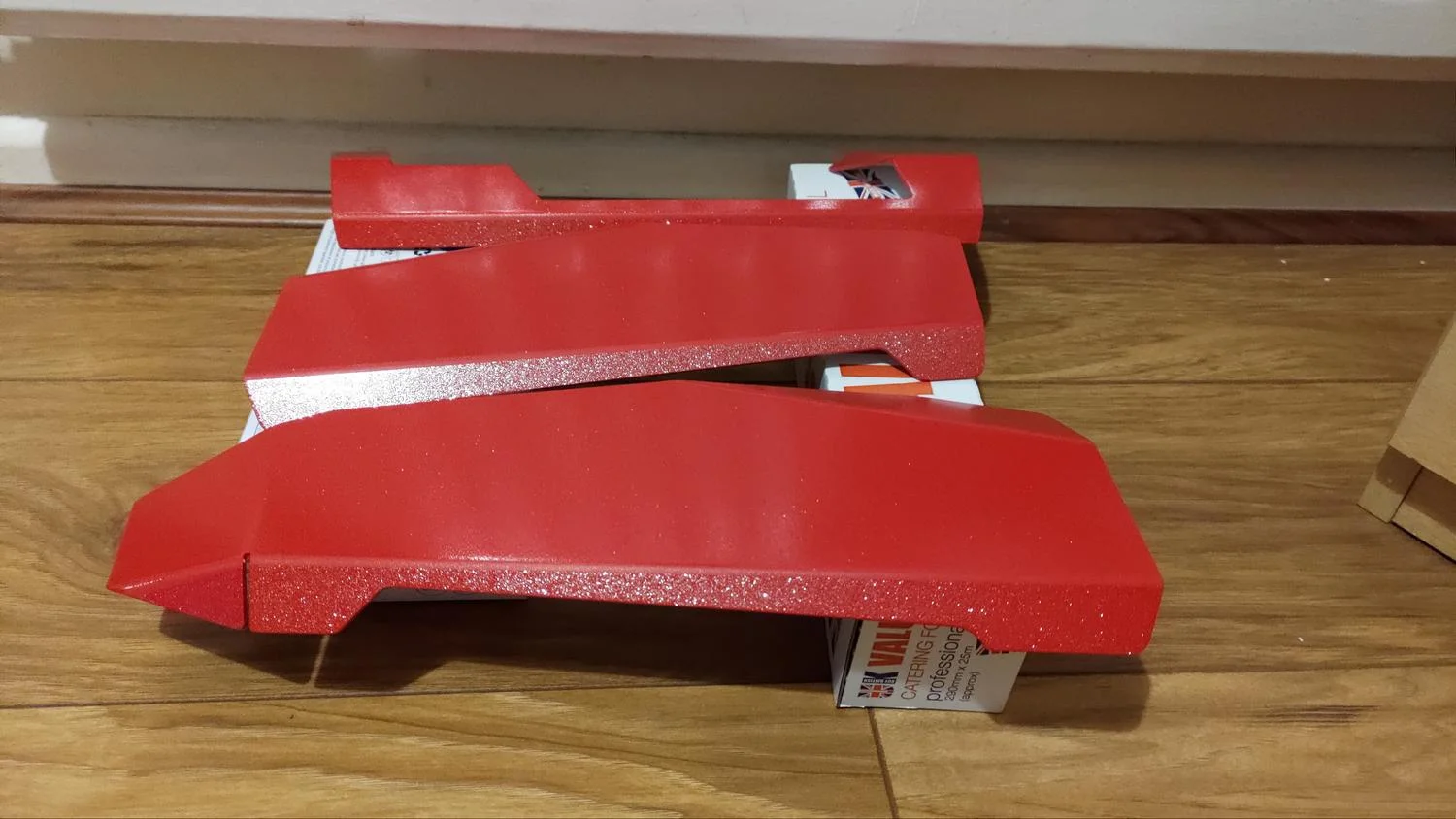

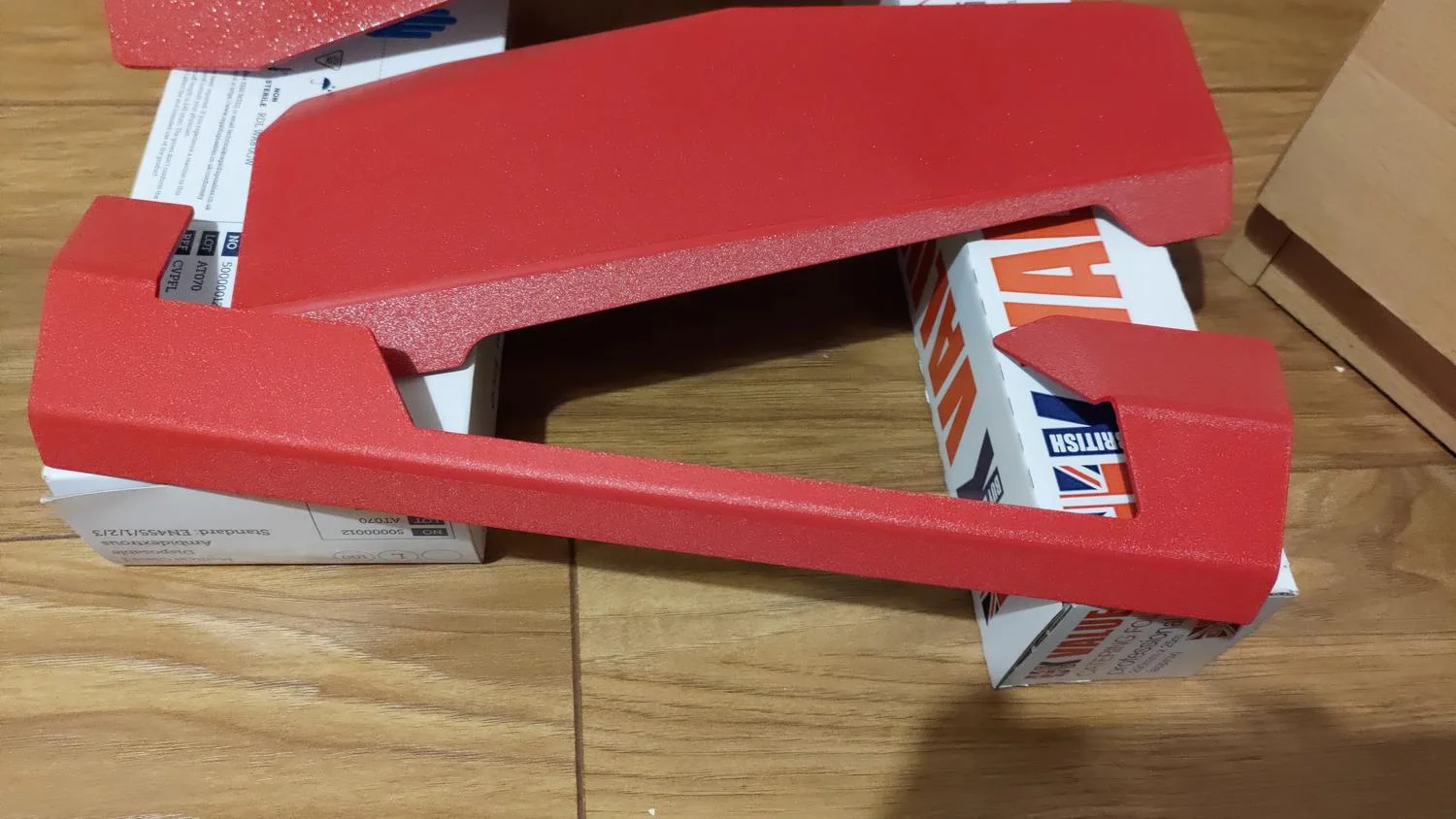

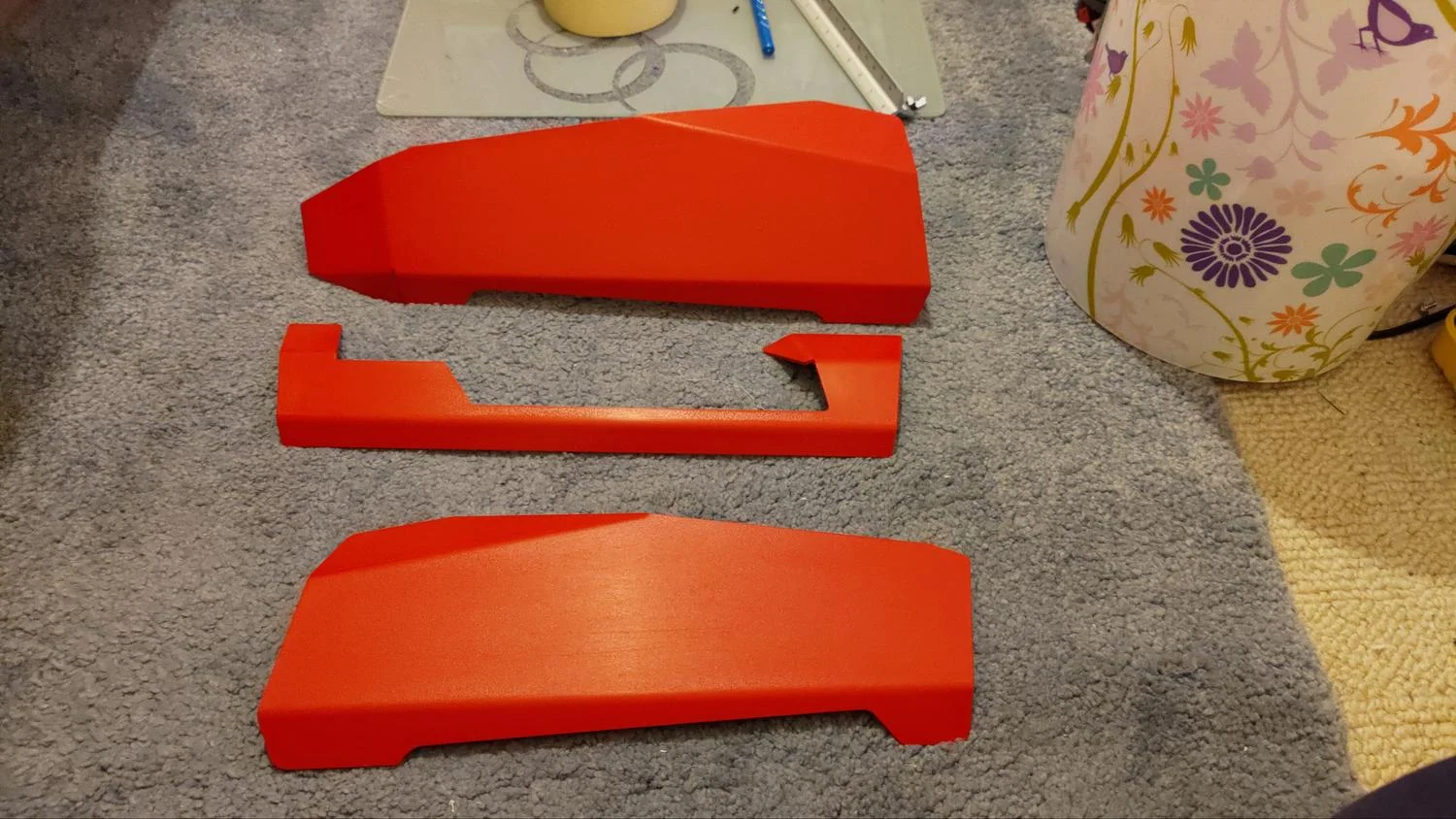

That's the first effects layer. The red flake. The bent pieces of the panels will be getting silver flake, which should make it shape shift. Will leave a straight red line between the two.

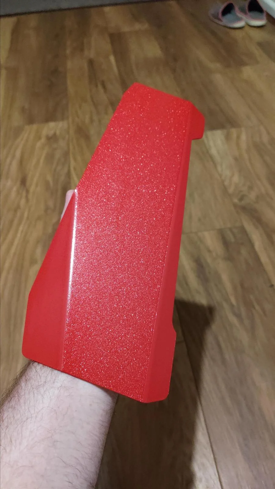

I had an issue with the clear coat. I know that Kobra sell this in two types. Matt and gloss clears. I think someone put the wrong cap on this one.
I've been using this stuff for two years in all types of weather and it has never done that before. There wasn't even any orange peel, so the application was perfect. At first I panicked and started wet sanding too early. This achieved two things. 1, it made me realise I could polish it glossy and 2, I put two fingerprints on one panel that took an age to polish out today. They are now done, though. Just a light polish along one edge needed (I must have missed it) and we're good.

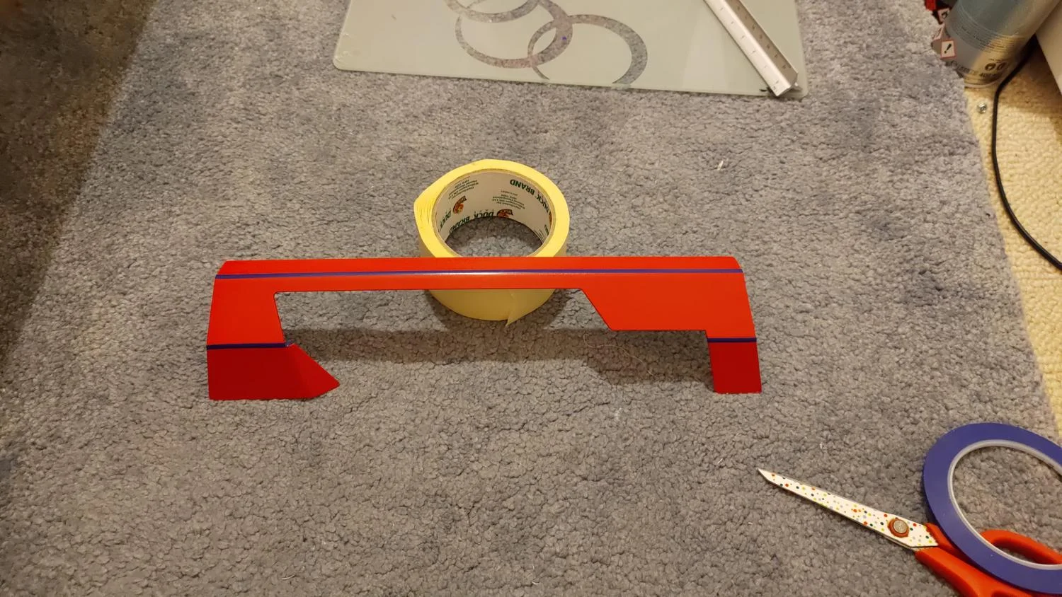

The flat red line now has much more definition. Very happy I did that.
Onto the elephant in the room. I still need to repair the scratch. I sanded it back ready for blending. I also had a mishap, though I am not claiming responsibility, given that 1. Both panels had fallen off the case in transit and were loose in the box and 2. All I did was pull off some masking tape. I reckon it was already bent/cracked.

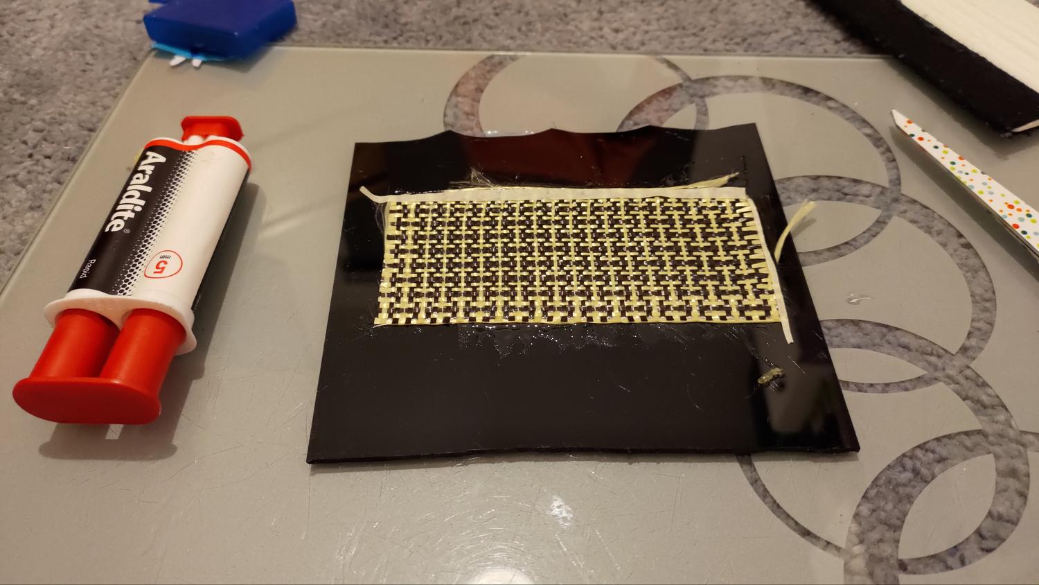

Then I remembered that about two years ago I had an idea for stabilising Kevlar into a sheet so I could make shapes with it etc. So I went and dug that out. It's woven Kevlar into carbon. I didn't realise until today what a pain it is to cut. Soon figured out you need to hold the edges with tape, but man even my really sharp scissors struggled. What I did then was epoxy it down onto a piece of 1mm acrylic that I had spare.
I will then create edges with blu tak or something and pour in some clear resin. Well, I say clear, but I will probably tint it red.

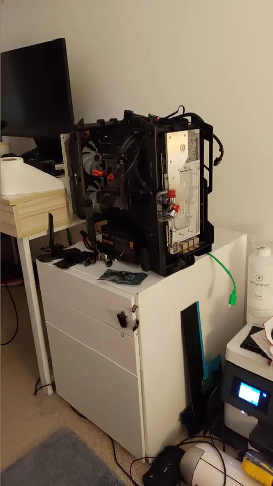

I got the blocks mounted on Friday evening.
Obviously this took the rig out of action. I needed a couple of days of just TV really. Any way moving on. Final order has been placed for what I will need to get it functional as a loop.

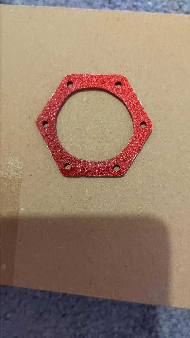

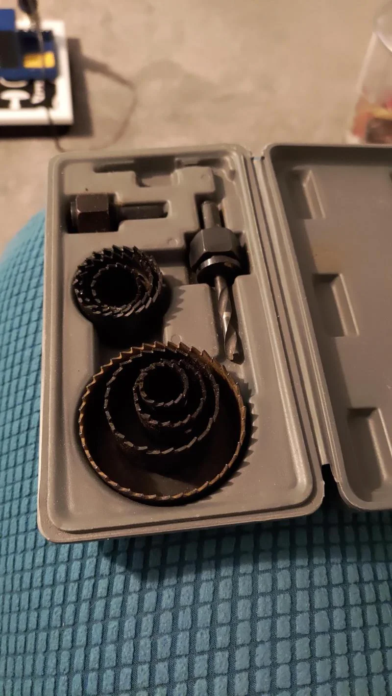

I found my small hole saw set. Cool.
This means I can remake the circle adapter (this thing, well it's more of a spacer)
With the correct sized hole in. I also soldered up the ring LEDs.
So that's done too.

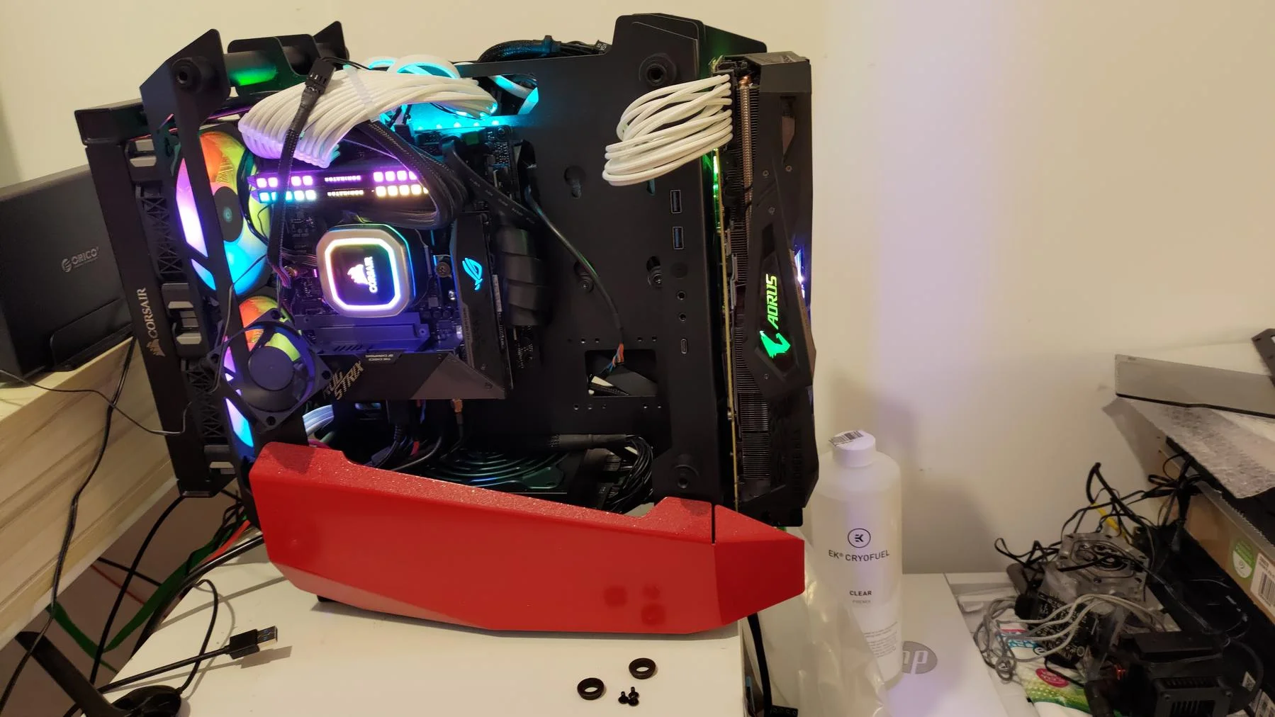

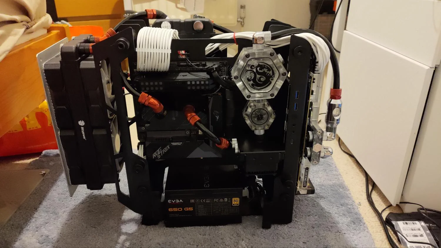

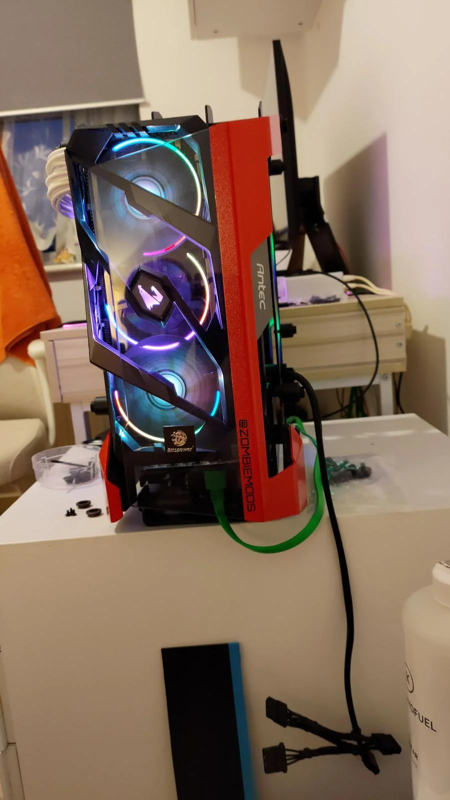

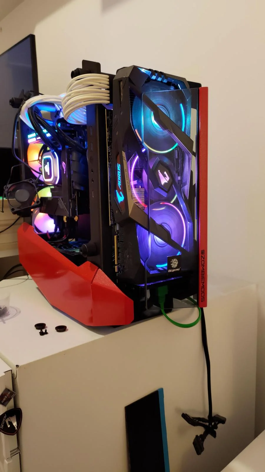

I started at around 7pm. Might have even been earlier. Looped up the rig.
The first thing I realised was that there was a capacitor on the new board right in the way of the pump outlet fitting. Because the pump top is quite big this meant I could not fit it how I had originally test fitted it.
I tried the pump every single way, but with the port coming out straight the glass would never fit back on and with it on the right it runs into the front IO board. TBH? this is a stupid mistake by Antec, and one I am really peed off about. I could not even relocate the pump, because there is literally one place you can put it. In the end I cannibalised some Corsair standoffs that come with an AIO and this brought the pump out away from the mobo tray enough so that the fitting cleared in the original position. At this point I looped it.
Then I realised I had made another mistake. The pump to SATA cable I bought (EK) is 12v only. God, what a racket. That's OK though, I can sort that out later. Ran the loop for about two hours with the hardware turned off. Noticed I had a leak. Guess what it was? yup, a straight rotary AGAIN. Managed to replace that with a straight extension (didn't matter because the fitting that goes into it is rotary) and tried again. Noticed another leak. This time... You guessed it ! exactly the same type of straight rotary. Only this time I had no replacement.
Thankfully it is the one going from the flow meter into the pump, and there is nothing under it. Plus it's a tiny drip. So then I powered on the rig. Nothing. NADA. Fans going absolutely crazy, no POST. Now at this point I **** myself. Like, totally **** myself, and figured I had bricked the GPU somehow which at this point in time would be irreplaceable. However, I noticed that the RAM RGB was not working. At which point I realised I had seen this before. Once I over tightened the clamp pressure on a CPU block and saw the same symptoms. So, I took the board out after draining it and added springs to the back as I should have done originally. Bingo bongo, it boots.
However. Now I have other issues. Firstly one of the RGB connectors on the hub has snapped (they really are the worst headers I have ever encountered) so the pull fans on the rear won't light up. This isn't a major issue as there is another header, however it means I need to completely remove them all as one of the daisy chains has pulled out also FFS.

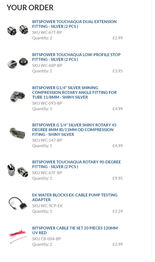

So I have ordered some more bits. Firstly to completely remove the sh@tty straight rotary and fit something that won't friggin leak. I also get a free drain port, which I will no doubt need.
Bitspower one was out of stock. Plus it was 3x as much as that. I've ordered this to create a 7v feed to the pump. I really can't be assed paying AC for their software every year and fitting an enormous controller just to run the pump at 7v.
And these. Because the ones that came on it all fell off and have trashed the top of my pedestal.

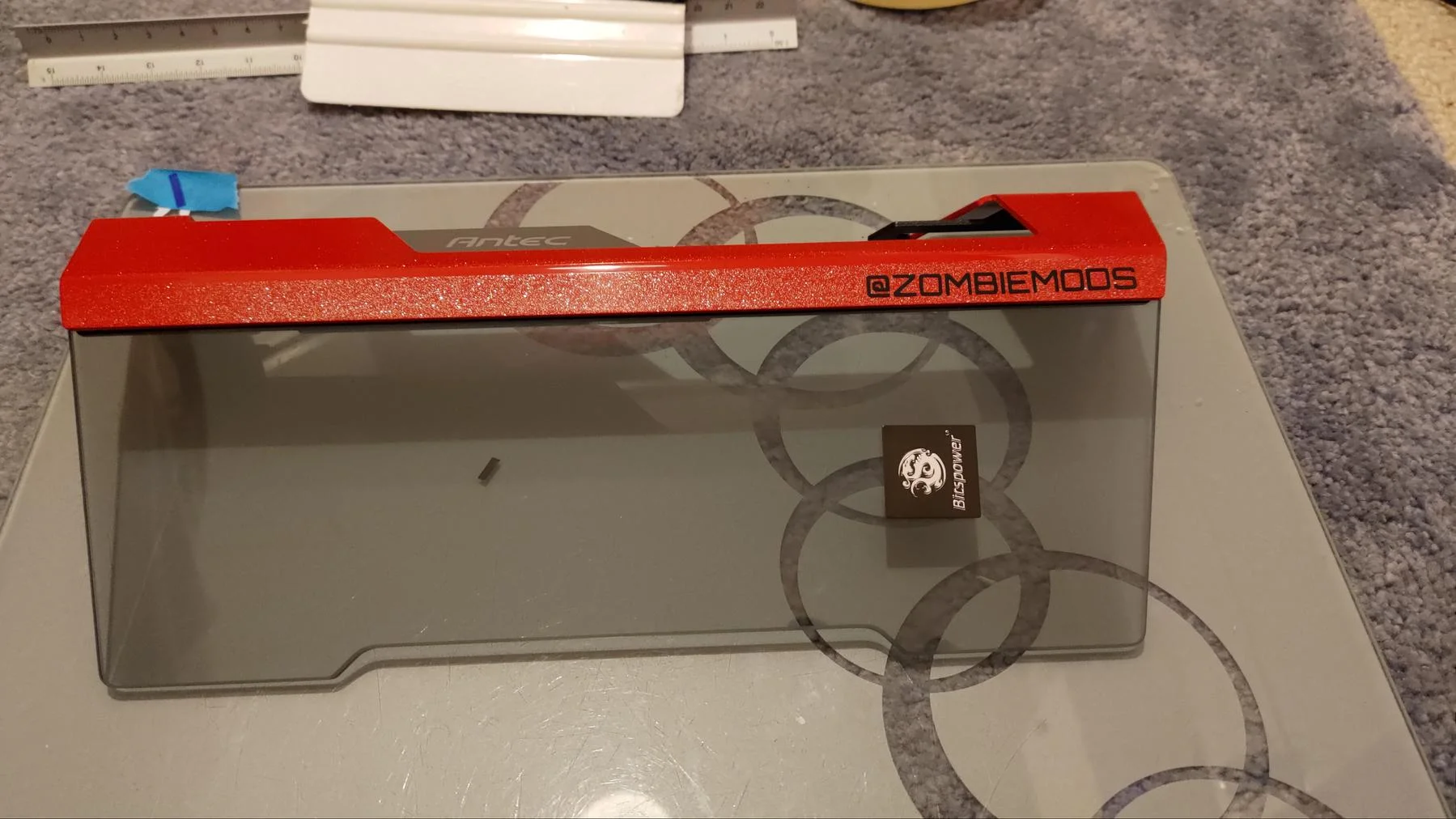

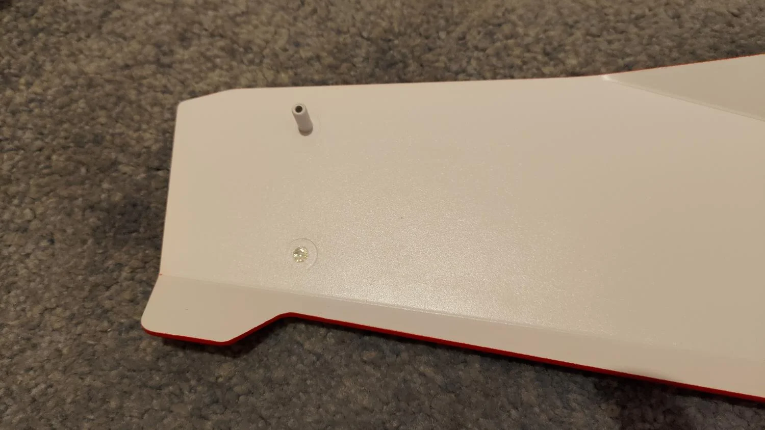

OK. So the final problem. Because I had to space the pump away from the mobo tray the glass no longer ****** fits. Seriously, you couldn't make it up. So I have ordered these.
I will show what they are for when they are fitted. No point trying to explain it.
