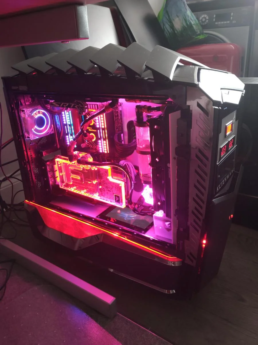

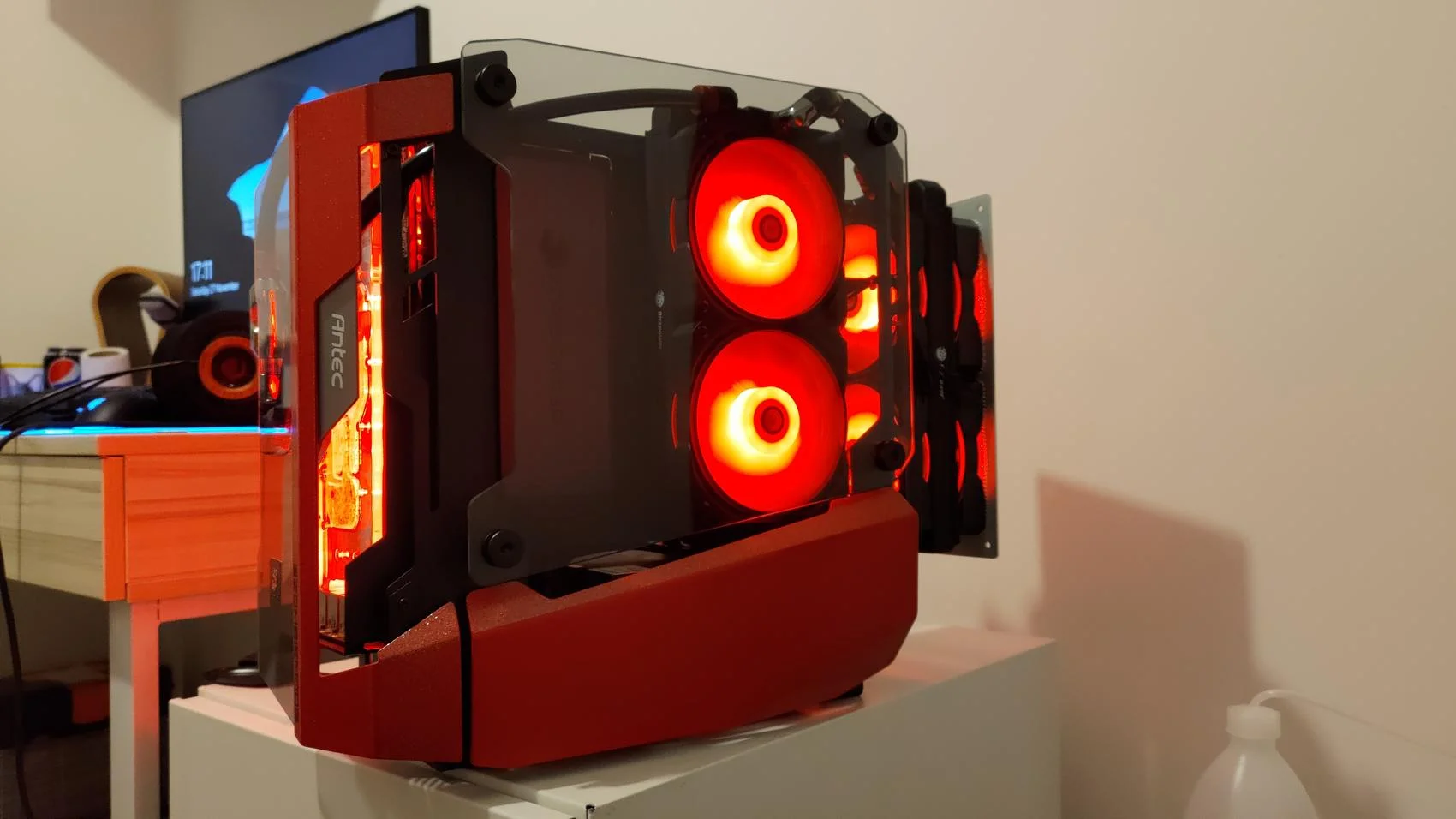

The last build I did that was even slightly extreme was the Stryker build last winter. I like to do PC stuff in that time, as most of it can be done in the warm. Sadly again I needed the rig working whilst I was doing this, and as such a custom paint job was about the best I could do.
TBH? it was pretty cool. The paint came out really well. The only problem was that it wasn't cool. The temps on it were bad. Like, really bad. I never quite worked out why, but I think it was the radiator loaded in the side.
It just couldn't breathe, and was not cooling. It also blew all of that hot air into the board, which made the CPU really hot even at idle. As such the GPU suffered. The thing is, I have had these rads and pump in another build and it was proper cucumber.
The GPU never went over 46c. In the ITX build? it was struggling to stay under 70. So something was very wrong in there. Like I say, I think it was simply the rad in the side turning into a heater rather than a heat exchanger.

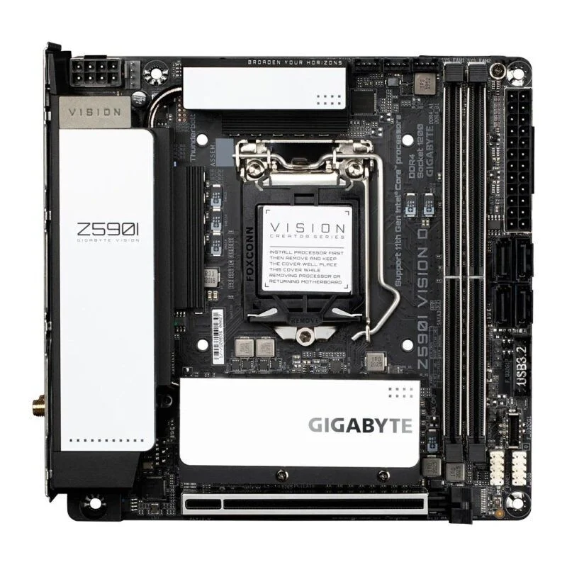

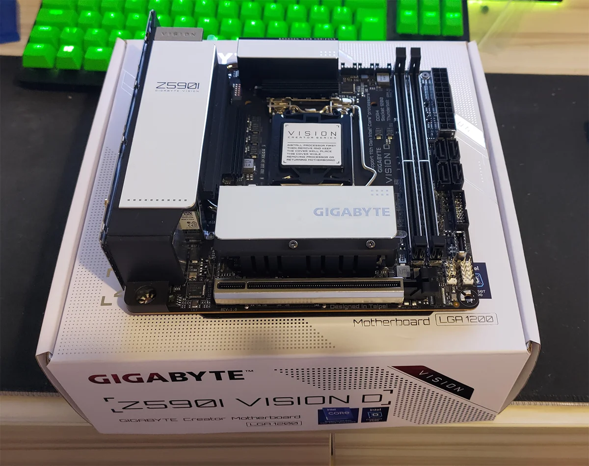

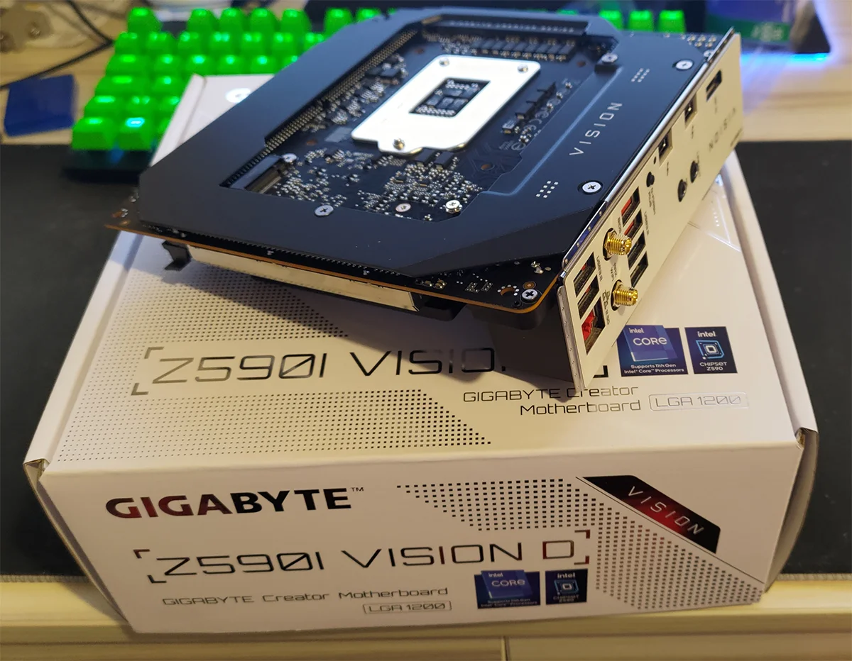

I then utilised Black Friday to buy some hardware for the second box. I chose this board specifically because it has Thunderbolt. Meaning if in the future I want to add on more? I can grab an external GPU box.

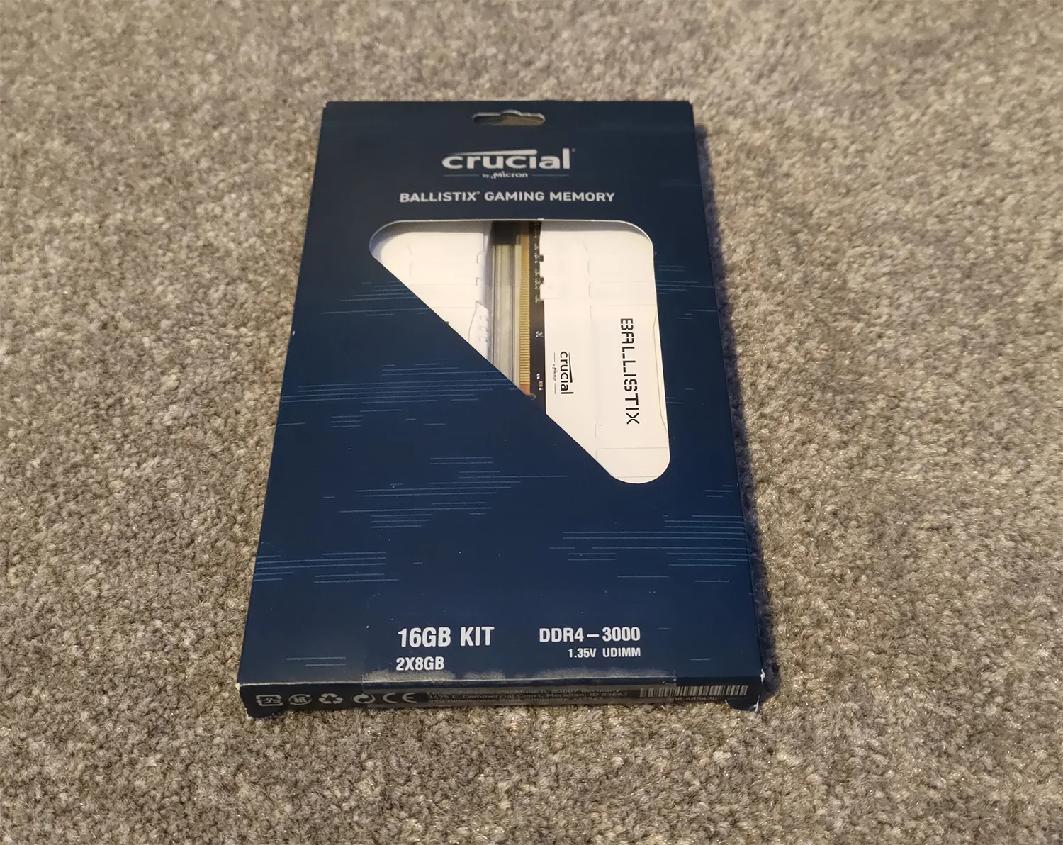

I have plenty of DDR4. I even have some in white.

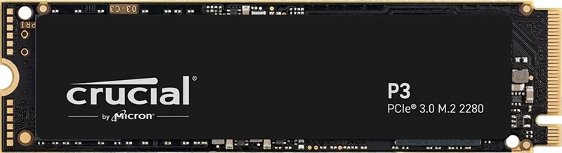

I just pulled the trigger. I was going to wait, but I think it ends soon. Waiting would have cost me, a lot, so I grabbed them now.
They were the cheapest available @ £34.99 each. 500gb, like. Oddly the model below also costs that. These do 3400R. The model below does 2400. Still, I am not complaining.
Any other storage will be TB.

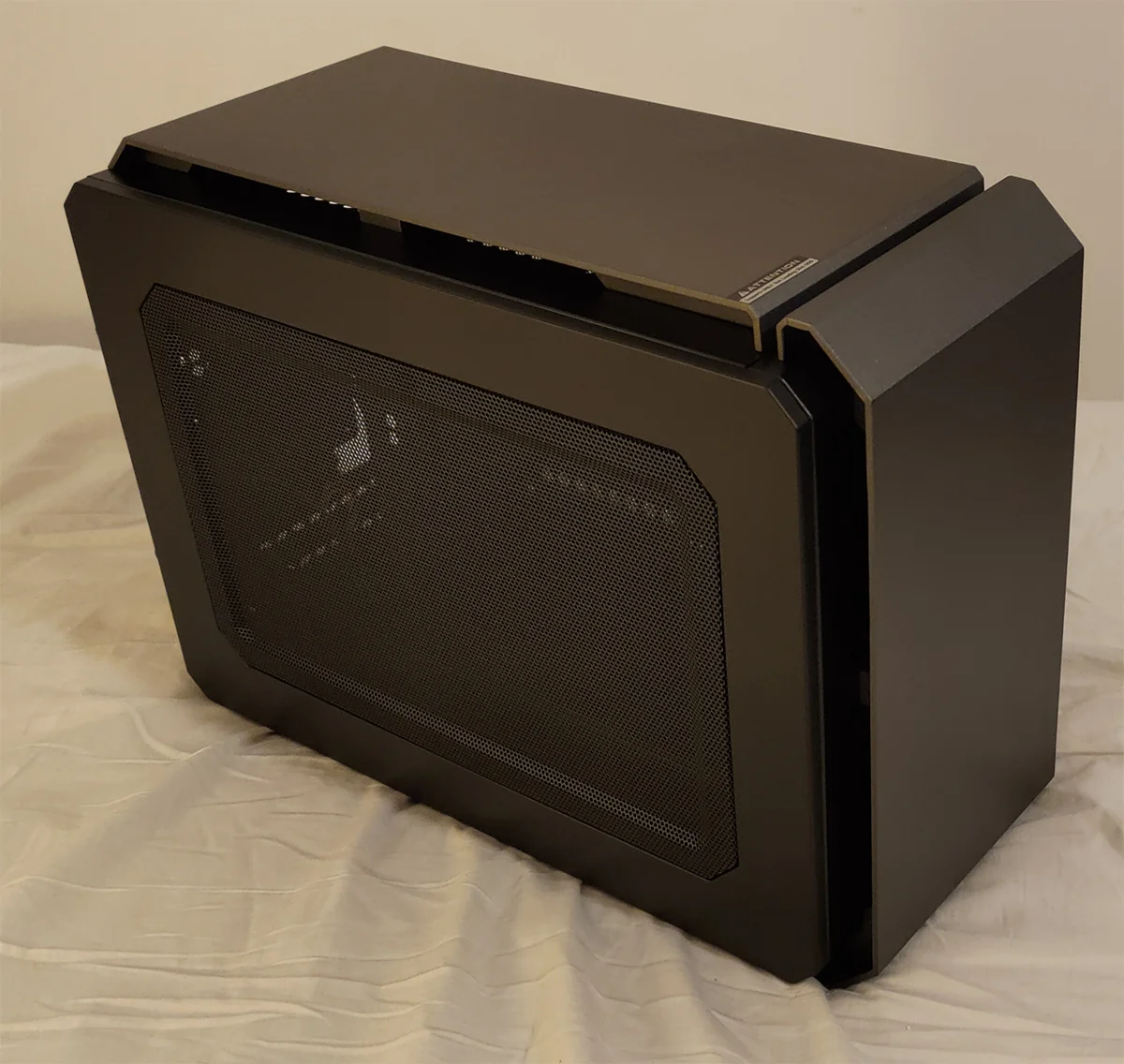

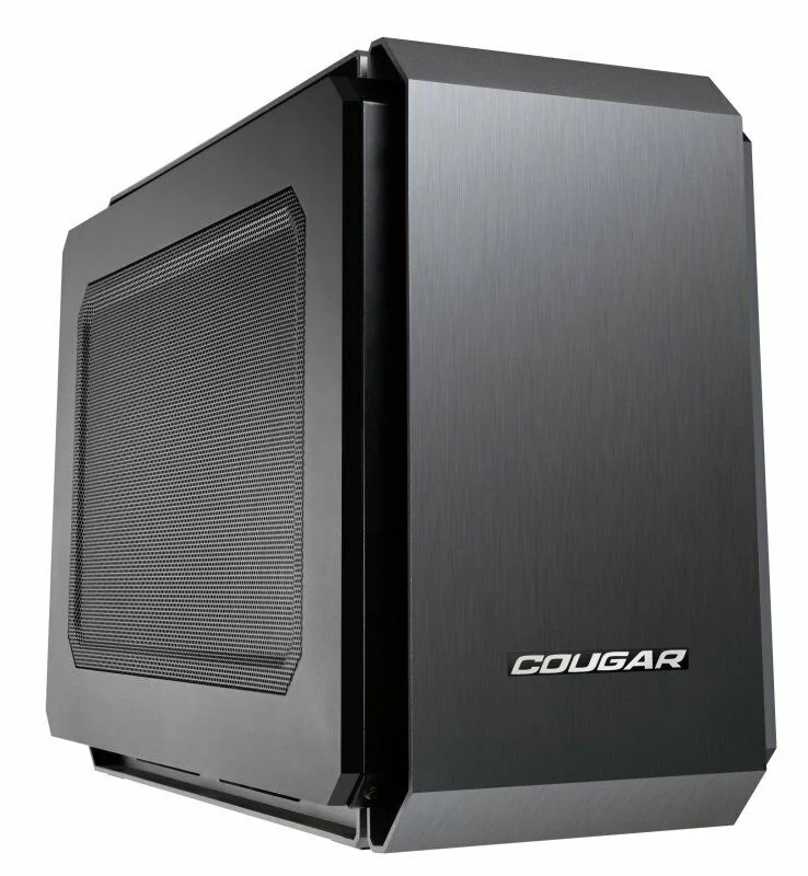

Update one point five. The case.
So obviously it arrived. I should have left it until I return, but you know how that goes. It doesn't.
So I got it out. I then began removing the detritus. Which continued. I was also enormously happy to find that the badge on the front was not mounted. IE, it wasn't pins with holes drilled into the case. It was just literally a sticky badge. Good, off it came.
And said detritus.
I must mention that it is very tinny and flimsy. However, given I will have no interaction with it once it is done, being a "dumb" box it doesn't matter, because it looks friggin awesome.
It still needs to be modded a little more extensively. I need to drill out 6 rivets so I can remove the PSU holding plate. It gets in the way of the rad and fans in the top. Once that is out though? yeah, very simple mod.

So today the SSDs arrived.

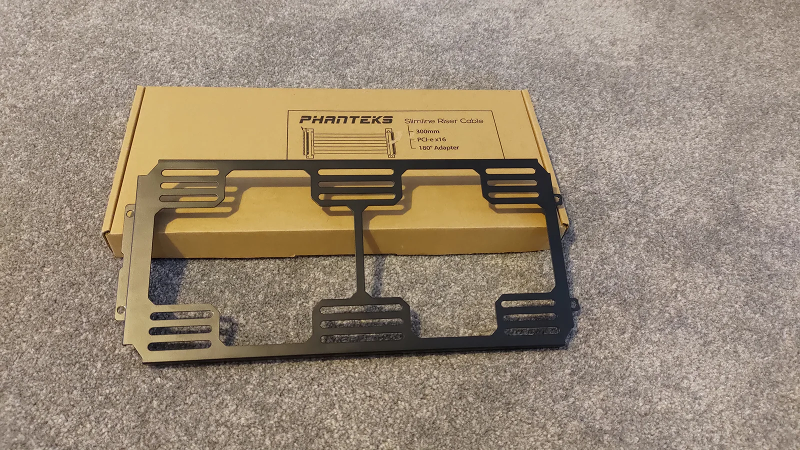

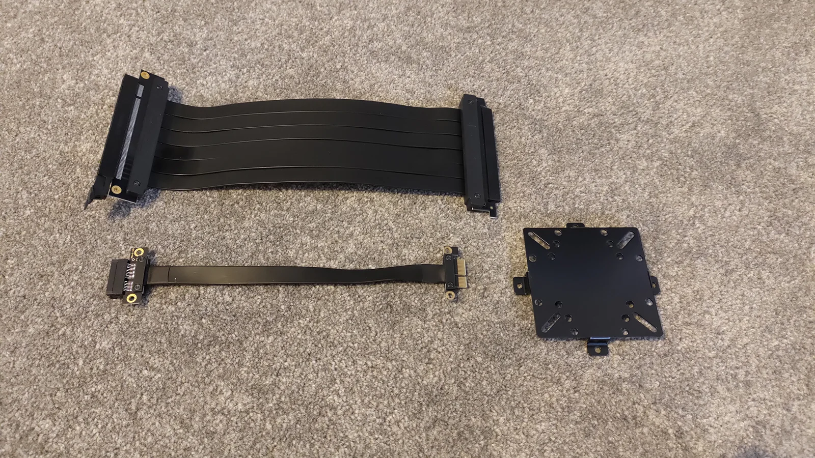

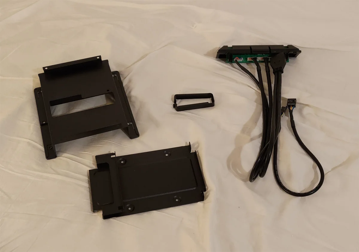

I came home, and had a dig in the stash. Soon found some goodies.

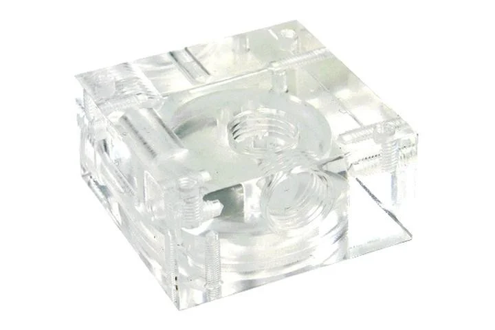

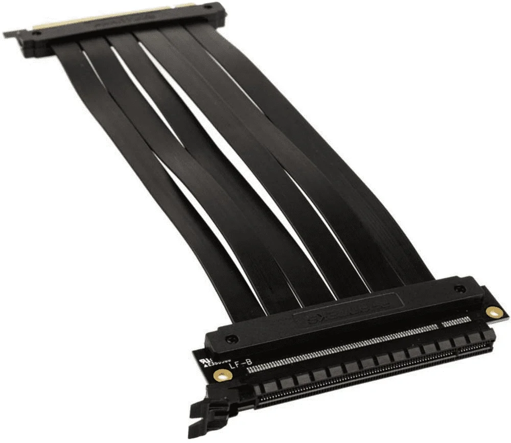

Most importantly the PCIE 16 ribbon and DDC pump bracket from my Lian Li 012.
I also have this left over from Mini Me (Q58) and I think I can use it.

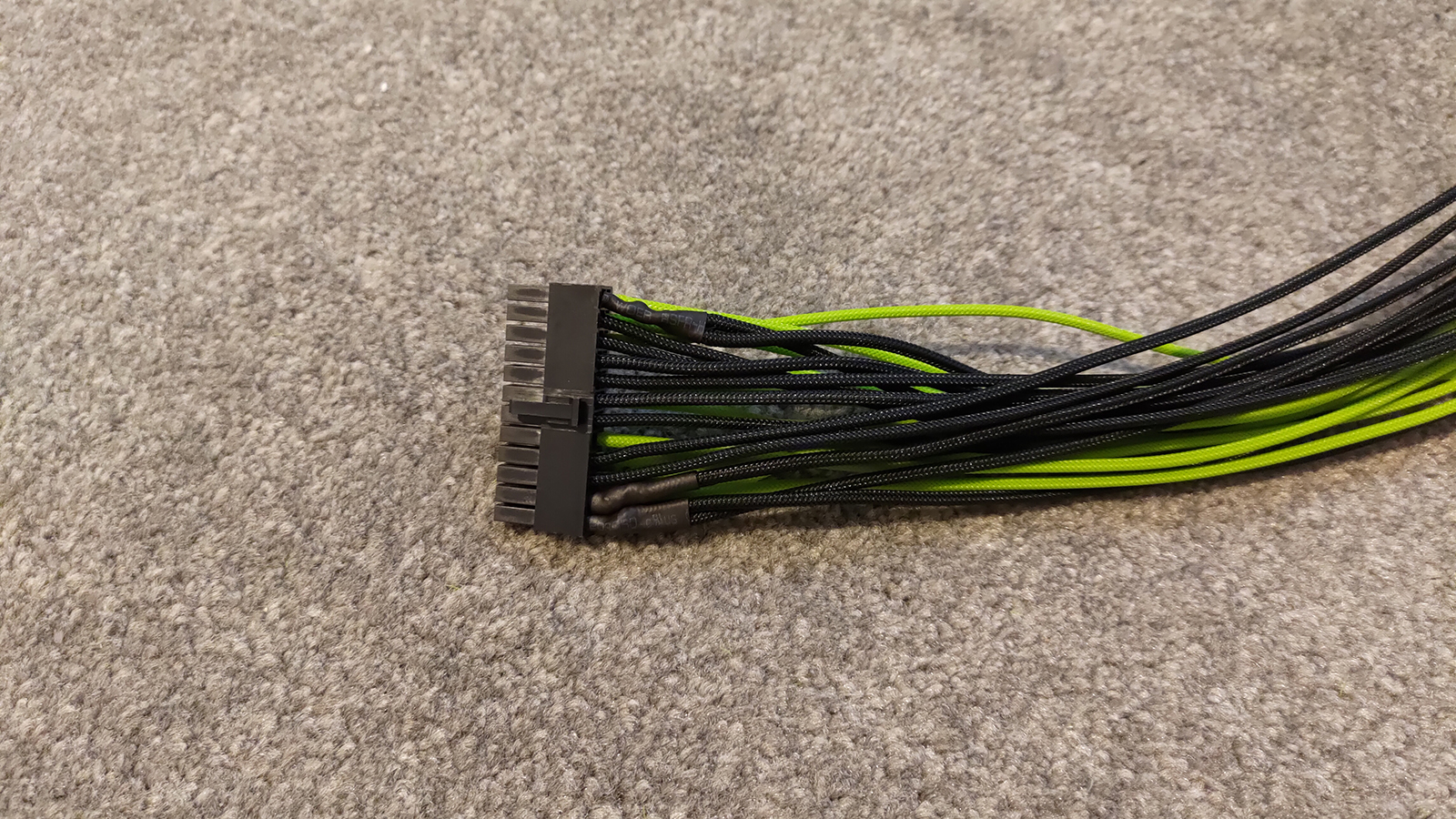

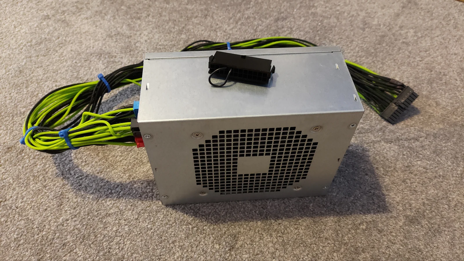

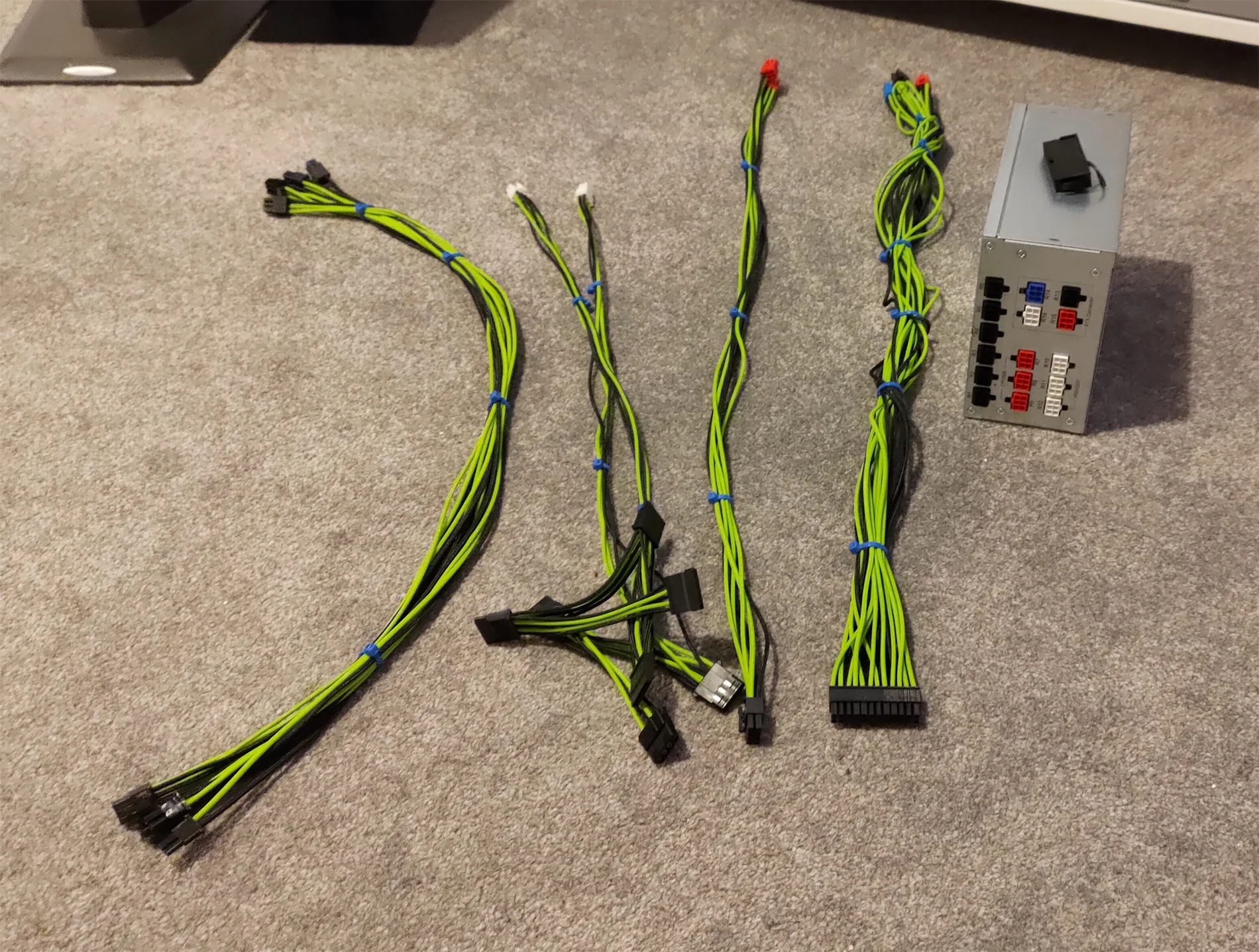

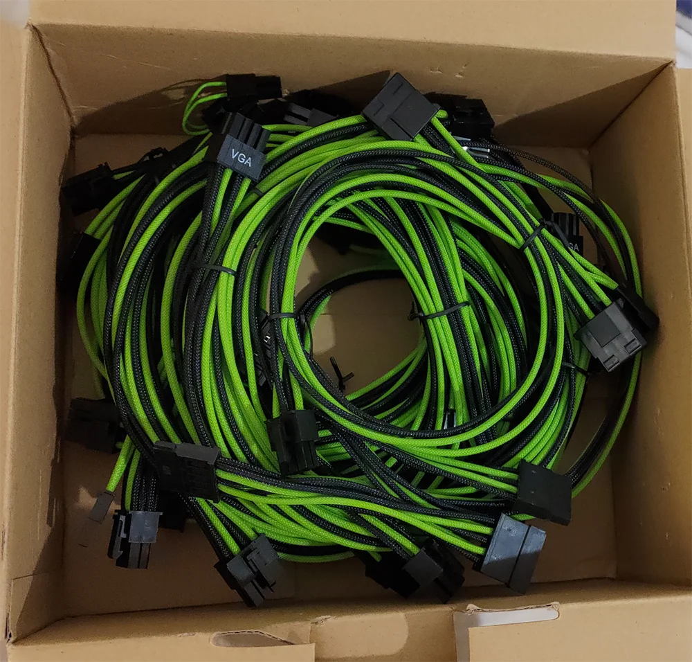

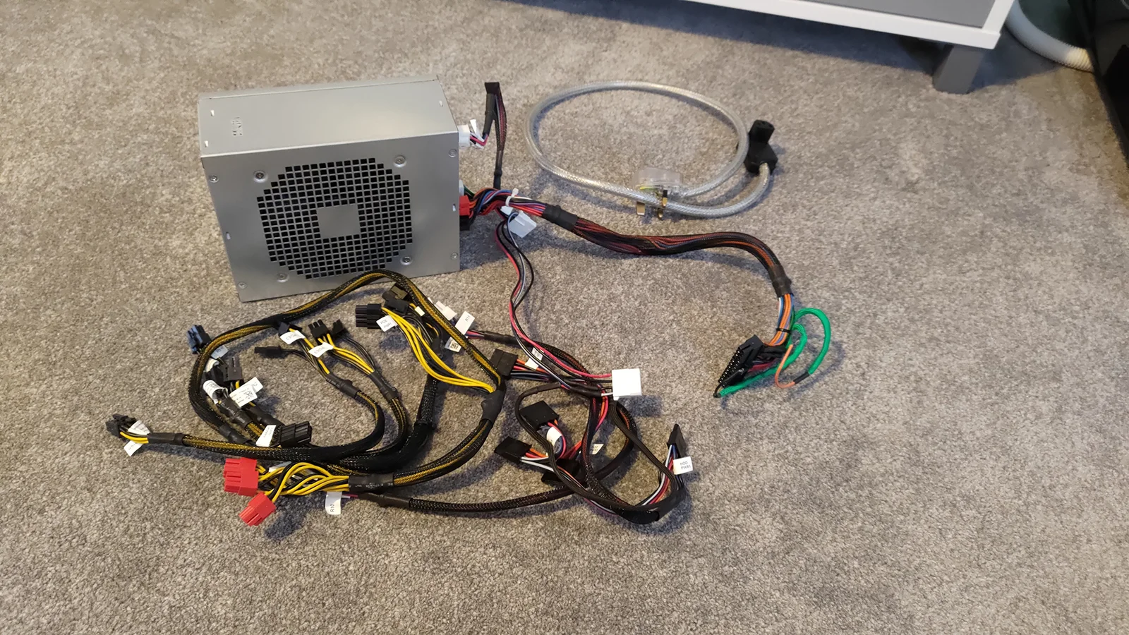

OK, so over to our victim. One 850w Dell 80+ Bronze PSU.

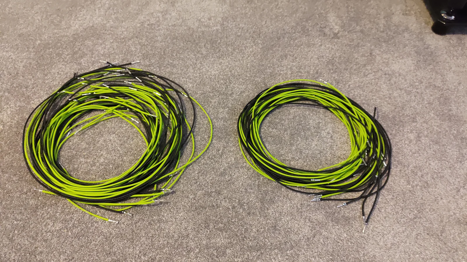

It's not pretty. I also hacked in two wires so I could jump start it etc. So let's fix it. First we sit and depin all of the Super Flower cables.

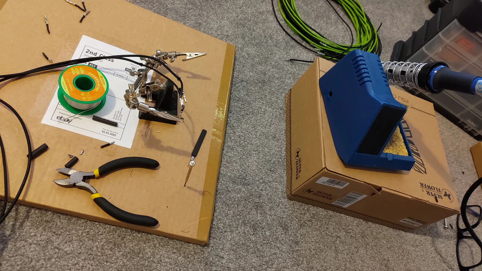

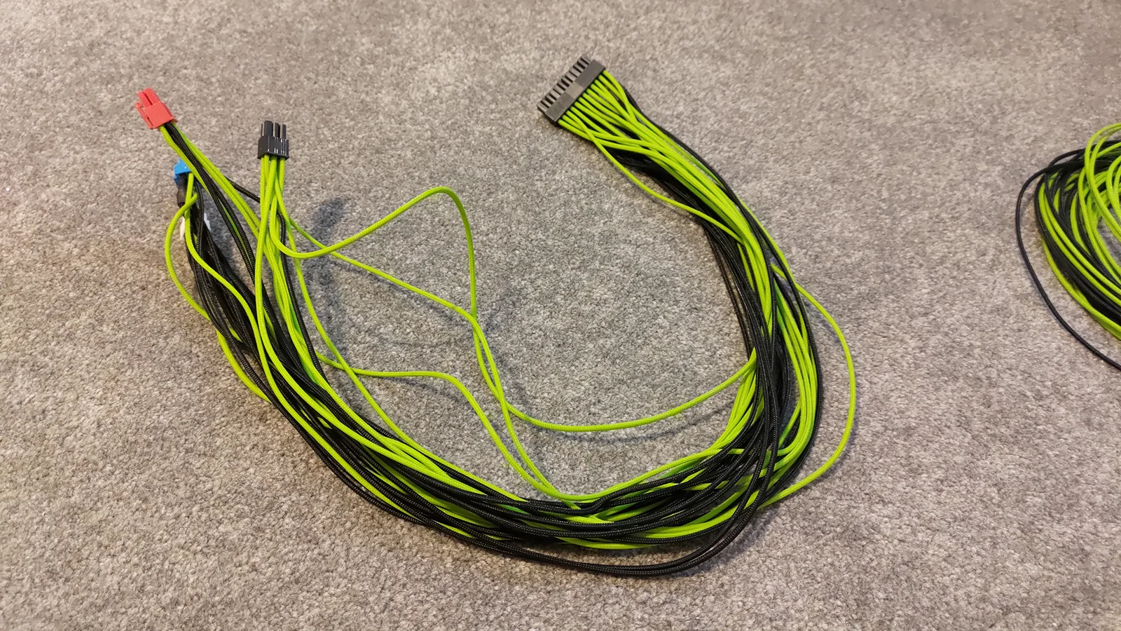

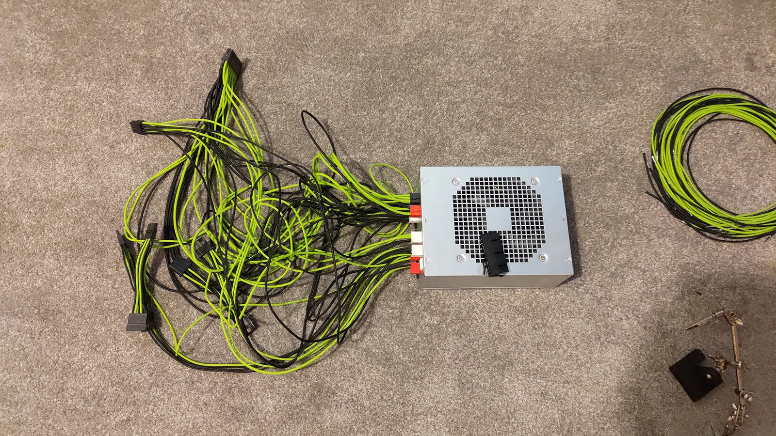

And then we start gleefully swapping them..... Until we hit a road block. They are not all straight cables. Some are doubled FFS. Now I had already decided to do one half of a connector green, and the other black. Little did I realise this would work out in my favour as I will explain shortly. So there was lots of this.
And eventually we were chicken on a bear.
I will cable tie it together in increments to make it stay in the new shape. Now, let us go back to what I was saying about how I got lucky. I decided to do the green first. No cable in the green row is doubled. They are all on the black half. Meaning I could do this.
Without completely ruining how it looks. Obviously I do not have bright green heat shrink....
And with that I am quite happy. My hands are not. Very sore.
I shall pick up tomorrow on the other cables, as I noticed a lot of those are doubled too. Oh joy !
If it's 80+ Bronze it can't be that old...so how have Dell managed to make it look like it's from the 80's? ...and more importantly perhaps, why?!
Looking a lot better already. :D
2015. That was when I bought the Area 51. That said it's had about two hours use total in all that time.
It's getting custom paint, so don't fret dear boy.

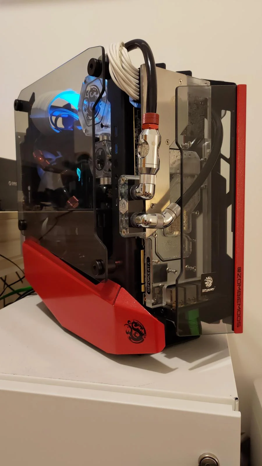

I still have that chassis. One day I will get the carcass powder coated and do it better. Mind you what am I saying? I still have every case I've built in lmao.
Update two point five. We have finished wiring.
It is messy. However, I have now designed the case layout in my head and you will not see any of it. Well OK, you will see the GPU cables but they are perfect as I realised the doubled cables in those were grounds, so I made two 8 pins going into 4 connectors (the PSU had 4 8 pins). So no doubling was required on those.

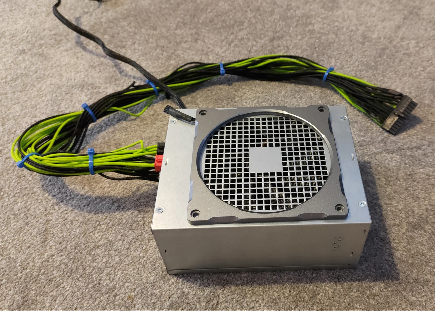

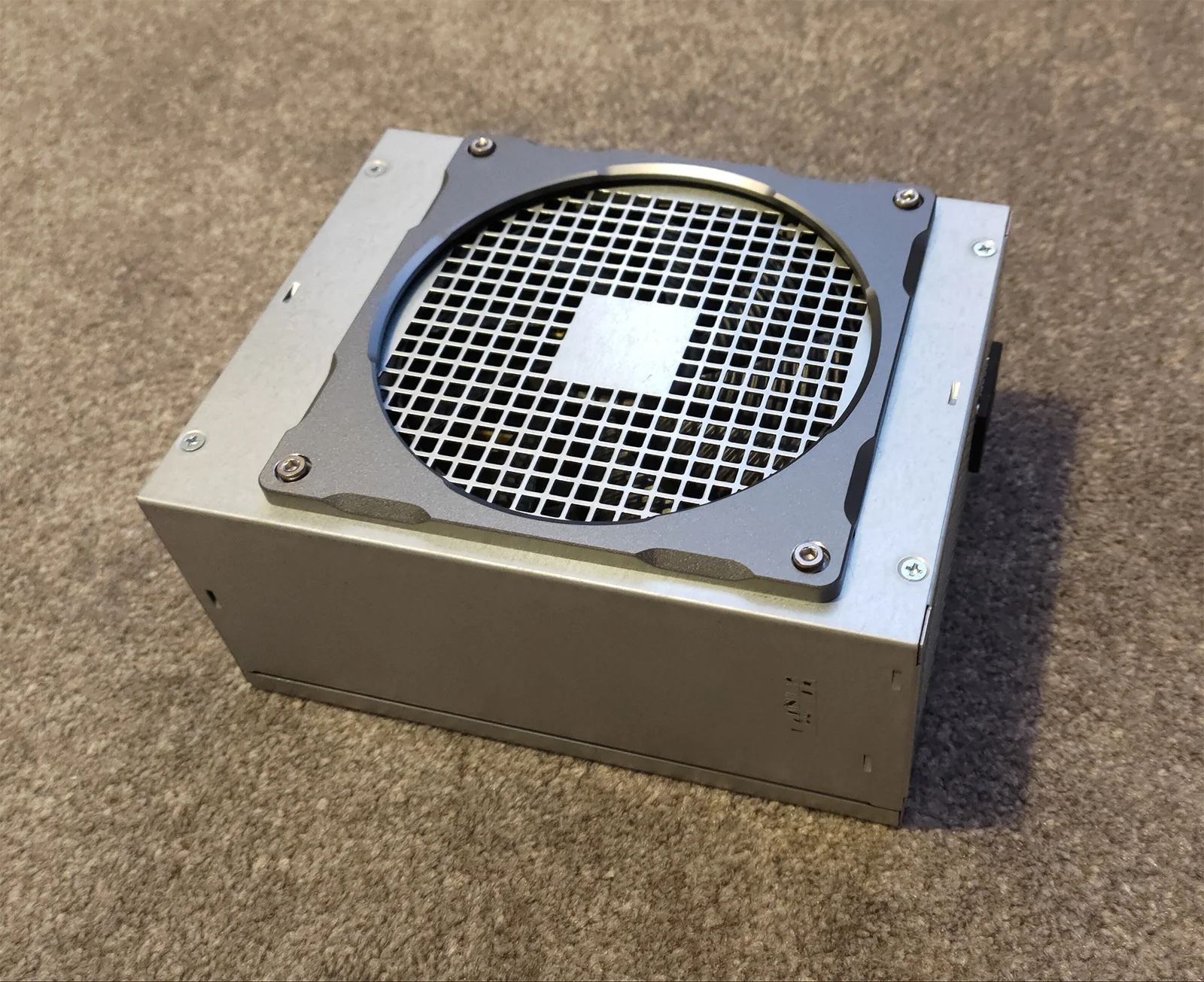

Update two point seven five. More PSU antics.

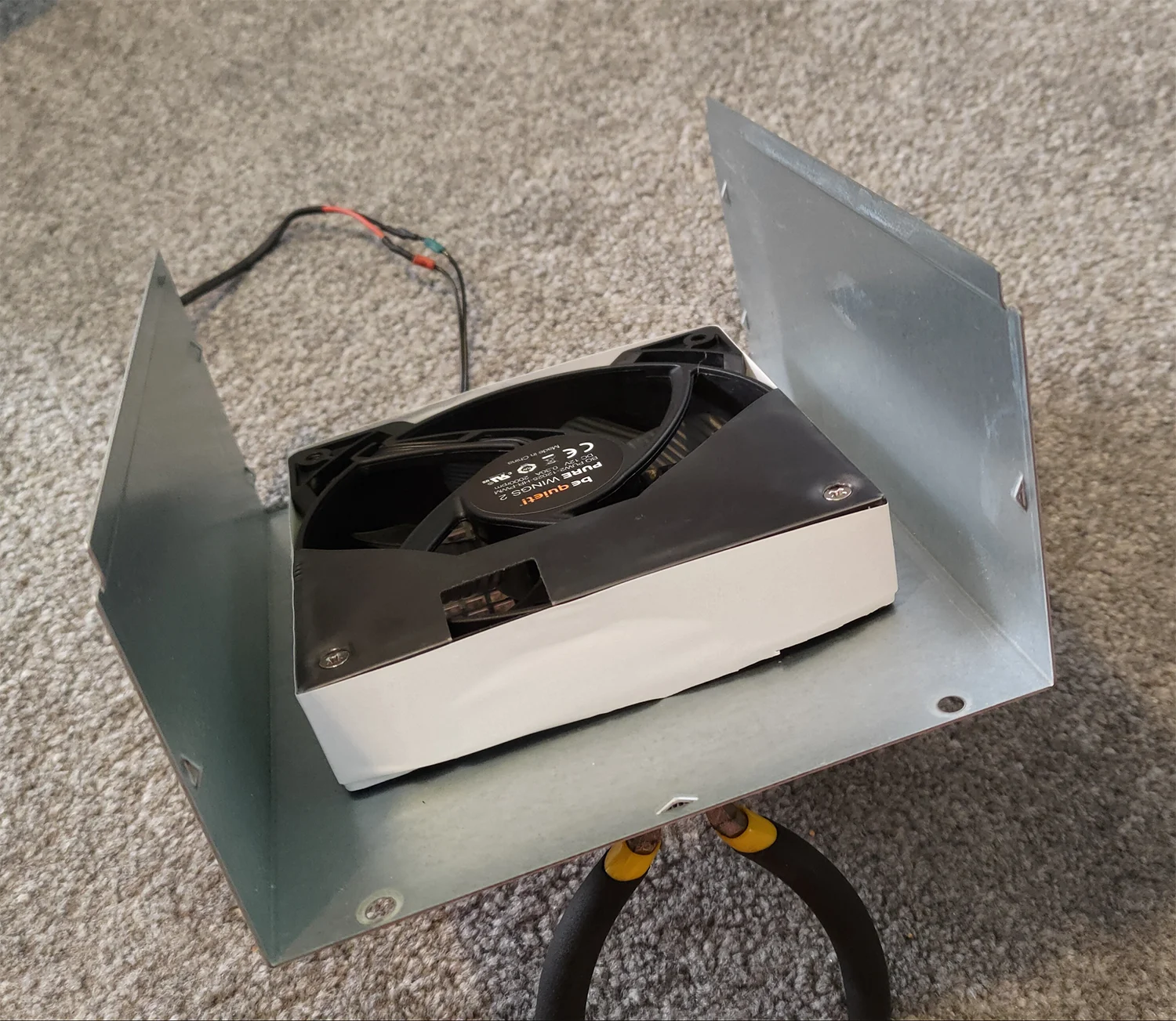

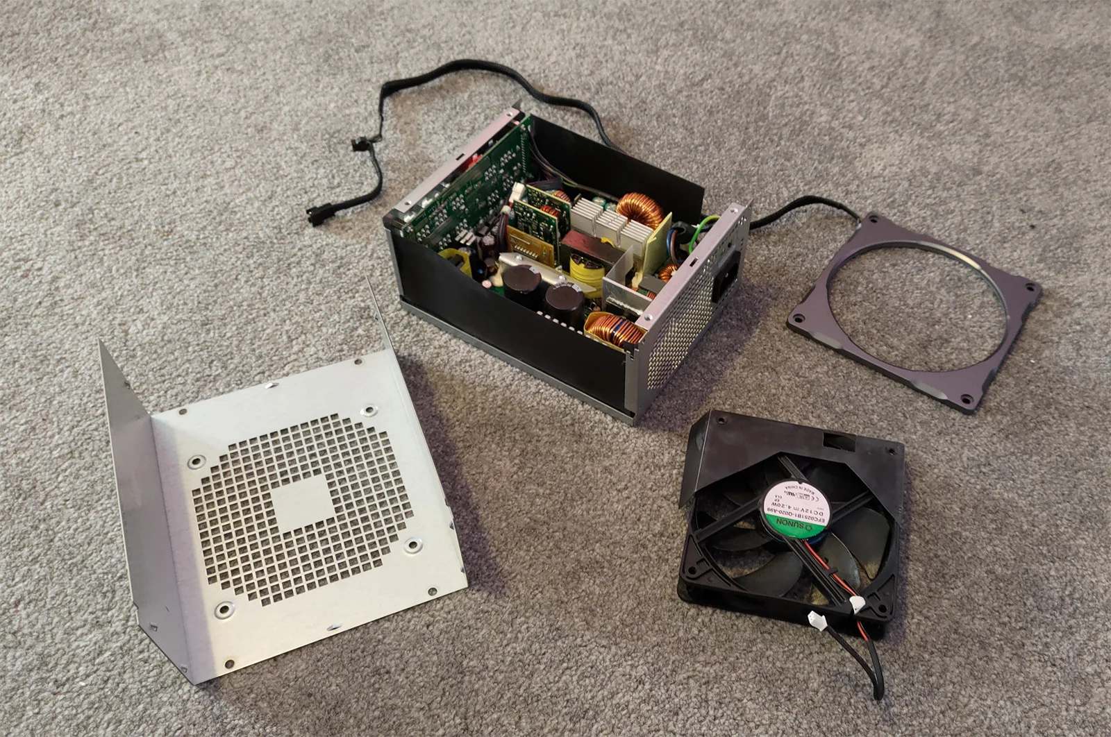

There were two ways you knew this unit was on. One, it clicks loudly when it starts (relay) and secondly you could hear the whoosh. It never bothered me, because within two days of buying that new PC in 2015 Tom Logan sent me a AX1200. So when I said it has had about two hour's of use at best? I meant it. I have only used it for firing up pumps when building loops independently of the hardware.
OK, so I took it apart. DISCLAIMER. DO NOT TAKE PSUs APART IT IS VERY DANGEROUS. They store voltage for a long time after being powered down, which in my case was just yesterday. YOU HAVE BEEN WARNED.

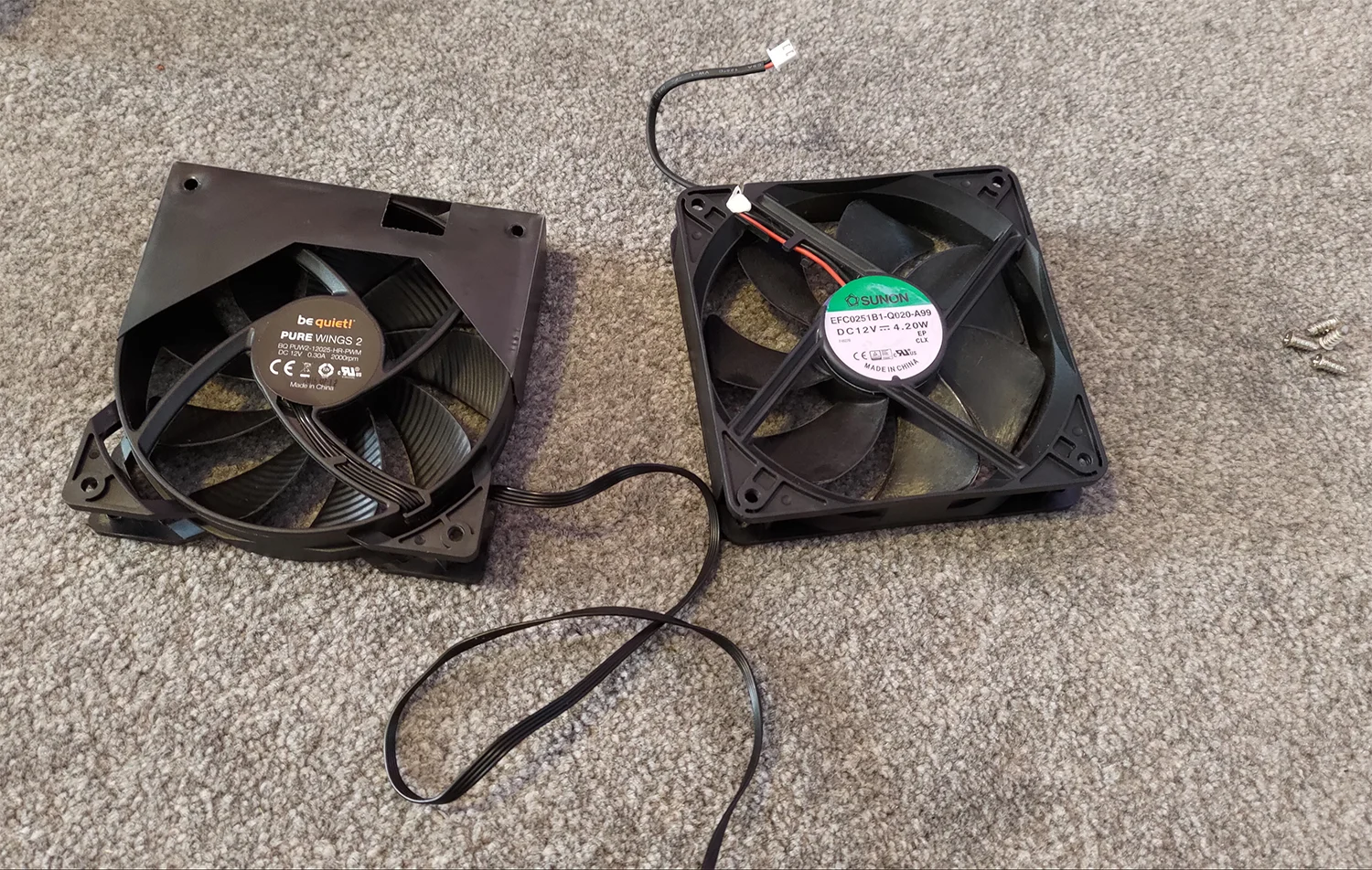

First thing I noticed was that the fan had a plastic air guide on, but also teflon tape all around the outside. So, I replicated that.
Adding my own tape around the chassis of the fan.
I then put it back together and tested again. Ahhhh, bliss. You literally have to pick it up and put it to your ear now.
BTW that Deluxe Halo (alu) hanging around in the pics is going here, sans the RGB.
I just want to make the body of the PSU look a bit more interesting. It will be getting painted, so bear that in mind.

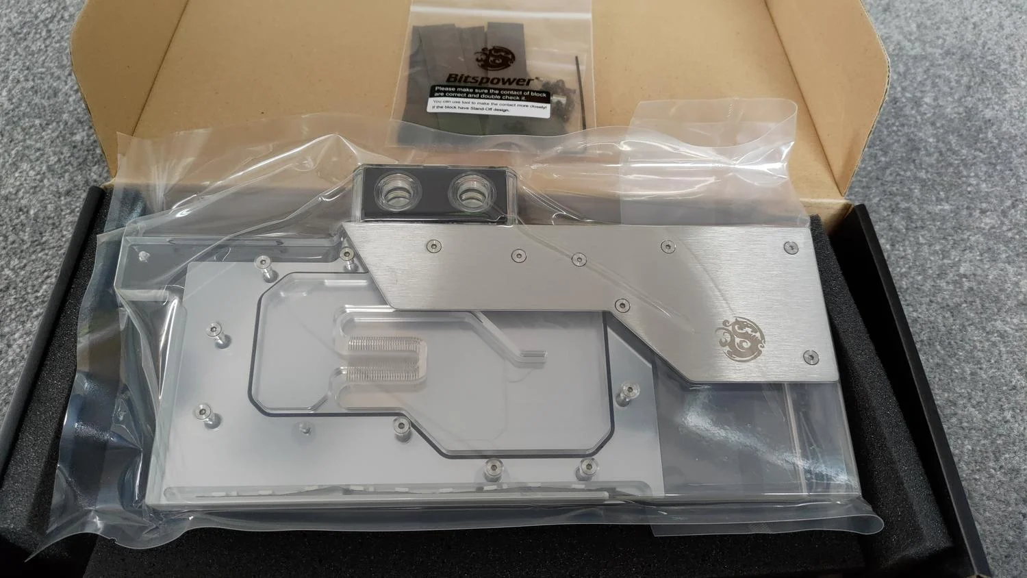

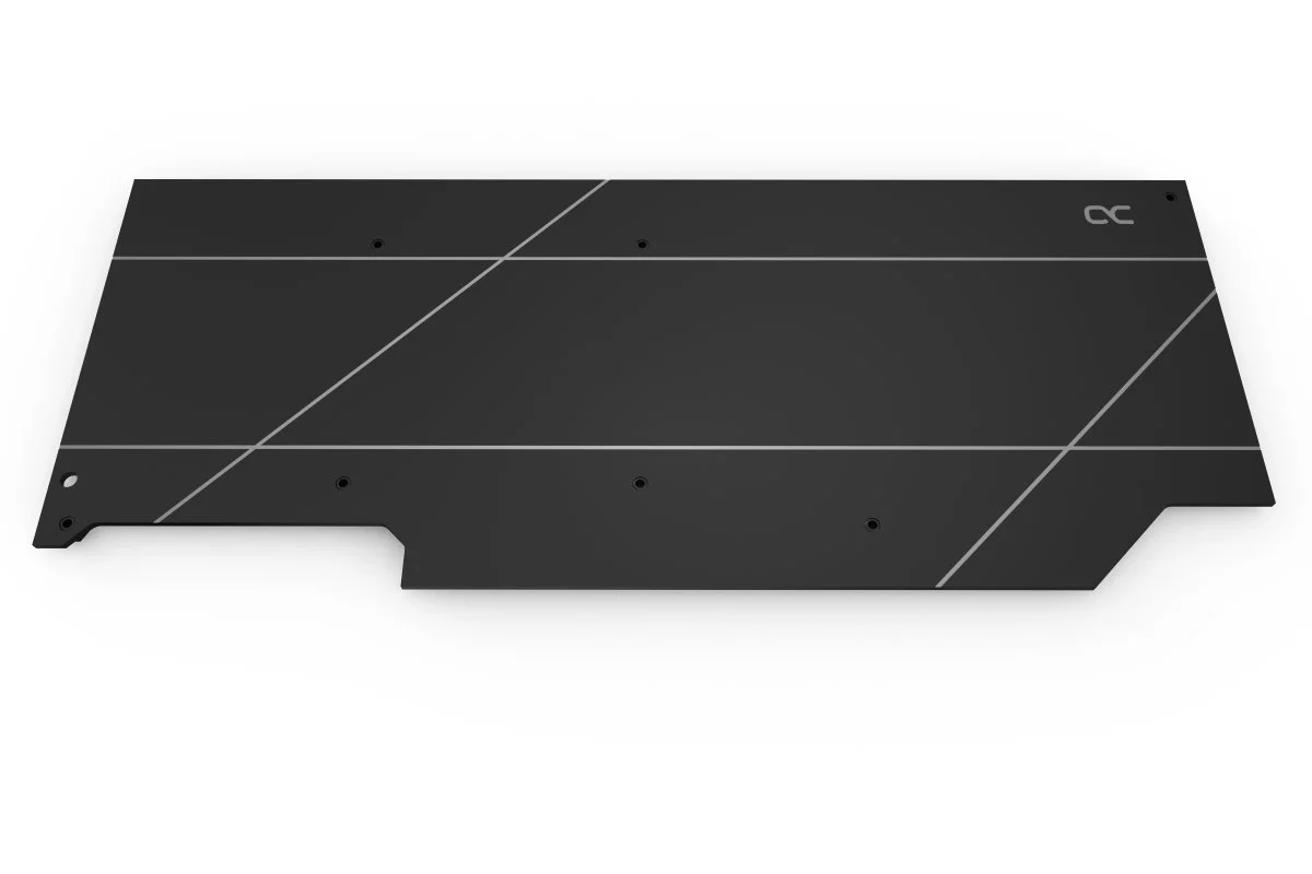

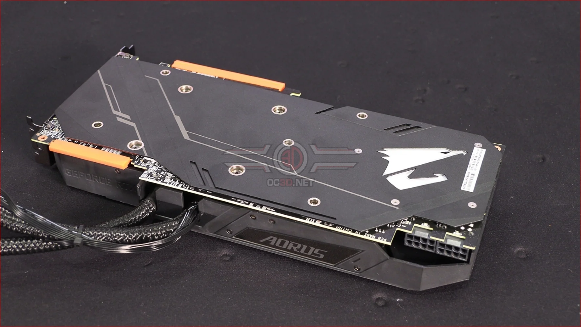

OK so it is time to talk about the GPU. I originally bought it cheap about two weeks before the 3080 launched. Seller told me it had VRAM issues, which was fine considering how cheap it was. I never found those issues in the original loop. It all worked fine. In the small rig though it was getting too hot, and thus displaying issues.
A lot of the problem was the back of the card. It doesn't matter how much cooling I threw at it the back of the card was soaking up heat. Which does not help the VRAM at all.

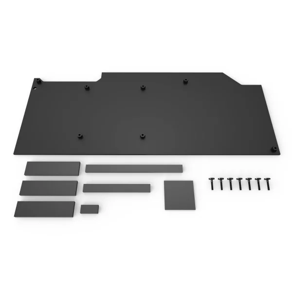

So, as I posted, I bought a new back plate.
And I will now explain why. The one on the card is stupid. Has RGB, etc. It is also angled and not flat.
So now you are probably wondering why I care. Well, the answer is simple. I need a flat back plate. I need it because when I bought the card it had this on it.

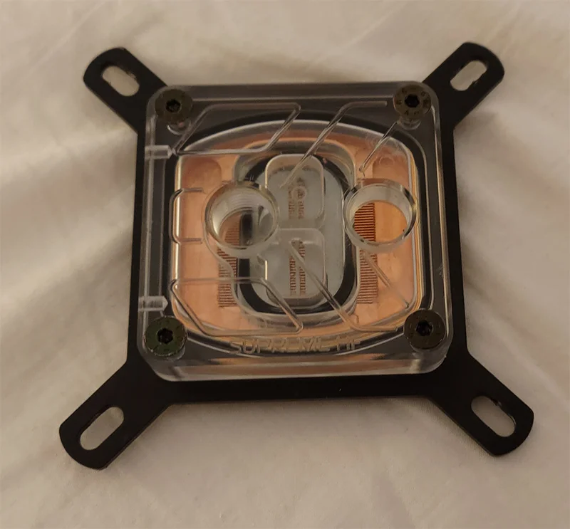

And everything else in the rig was Bitspower. So I fancied treating myself. To this.
But also because it saved me taking the Barrow apart and cleaning it out etc etc. I was being lazy, in the best way :D
So, when I was digging through the cupboards doing my almighty clearout a couple of weeks back (which is ongoing) I found it. The Barrow one. Which got my brain going. What if I had the cold plate milled flat, and then attached it to a back plate?
Water jacket. It will also alleviate the biggest problem the card has, heat. Plus it also allows me to cram it into the smallest enclosure possible without worrying about it frying.
The Alphacool cost me a tenner, and comes with pads to surround where the VRAM and core etc go.
The only hard part? is how to attach it. I have a feeling I will be buying some thermal epoxy....
I am also going to have the total waste of acrylic machined off it too, so even flipped it can be centred on the hot part.

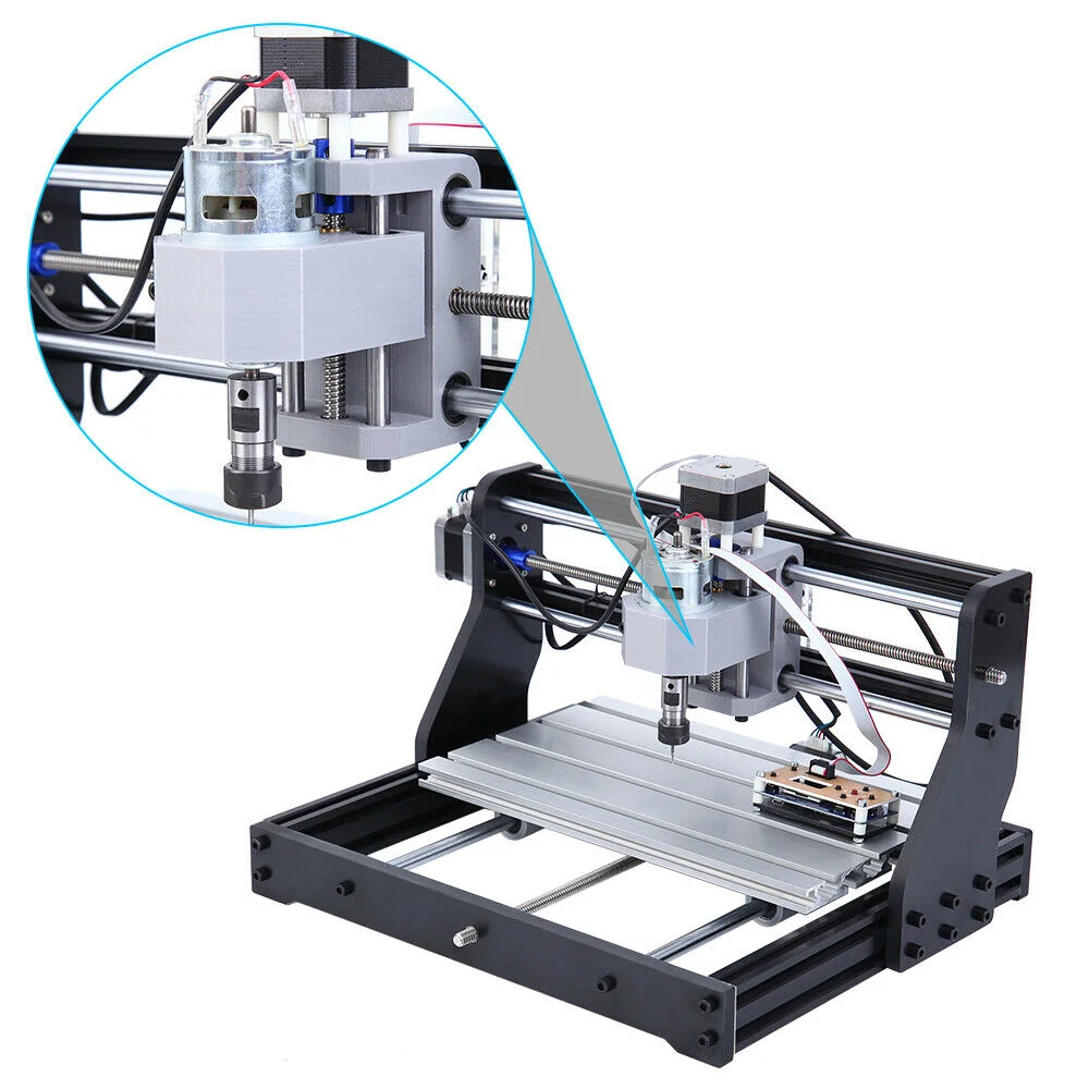

Update four, Computerized Numerical Control.
It is the one thing I have always wanted to do, but at the same time could never justify what it would cost. There were no hobbyist units when I did my last serious mod, and they were hundreds if not thousands of pounds.
It wasn't just the cost putting me off either. It was learning something I have absolutely bloody no idea how to do - 3D.
I tried to pick up Fusion and other 3D apps but the knowledge of entry is extremely steep. I never grew up in that world, and my days of spending 20+ hours sat in front of a PC are over. I just can't do it.
What I do know is Photoshop. Like, every dark deep nook and cranny. As such this has always kept me away from 3D apps and learning them.
Couple with that I have a lot of experience and knowledge in creating X and Y code, because I used to partake in a hobby that required a lot of it. So I already understand the axis part very well. Thus, I decided to spend a lot of time trying to find what was right for me. I have now found it.
The CNC I am most interested in is also the most afforable. This one.
Now most would balk at that. "It's too small, the motor is slow and weak" and etc. And TBH? they would have a point, if thinking big. I tend not to, and like to buy items based on use case and what I require. Same as the software side I guess. So I have now spent a week studying them, and the pros and cons, and what software is available. And today? I found the killer combo.
Oddly enough I stumbled upon it whilst watching a video with 0 relation. The software side of things was still concerning me greatly. I did not want to have to learn how to reinvent a wheel I spent 20 years creating (IE my knowledge of Photoshop). As such? until last night I was still terrified. Then last night I watched a video about a guy making motherboard boxes with slide out trays out of wood (with a laser). I mean, I guess it was somewhat related, but the chord was struck when he pointed out -
"Sorry, no Gcode for these because I drew them as PNG in Photoshop".
Eh? come again?

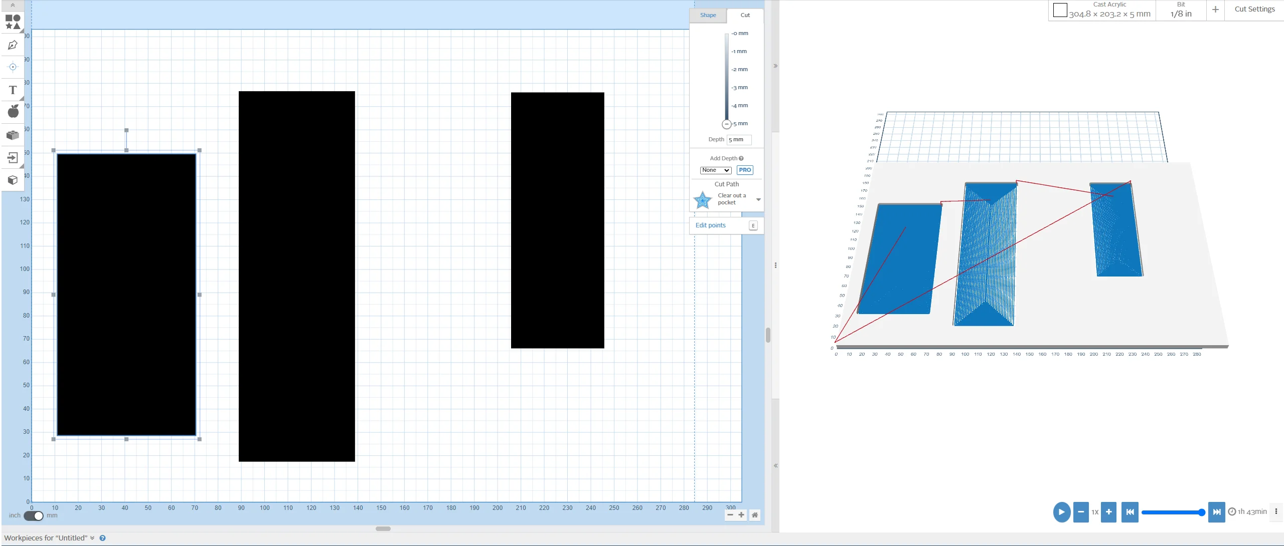

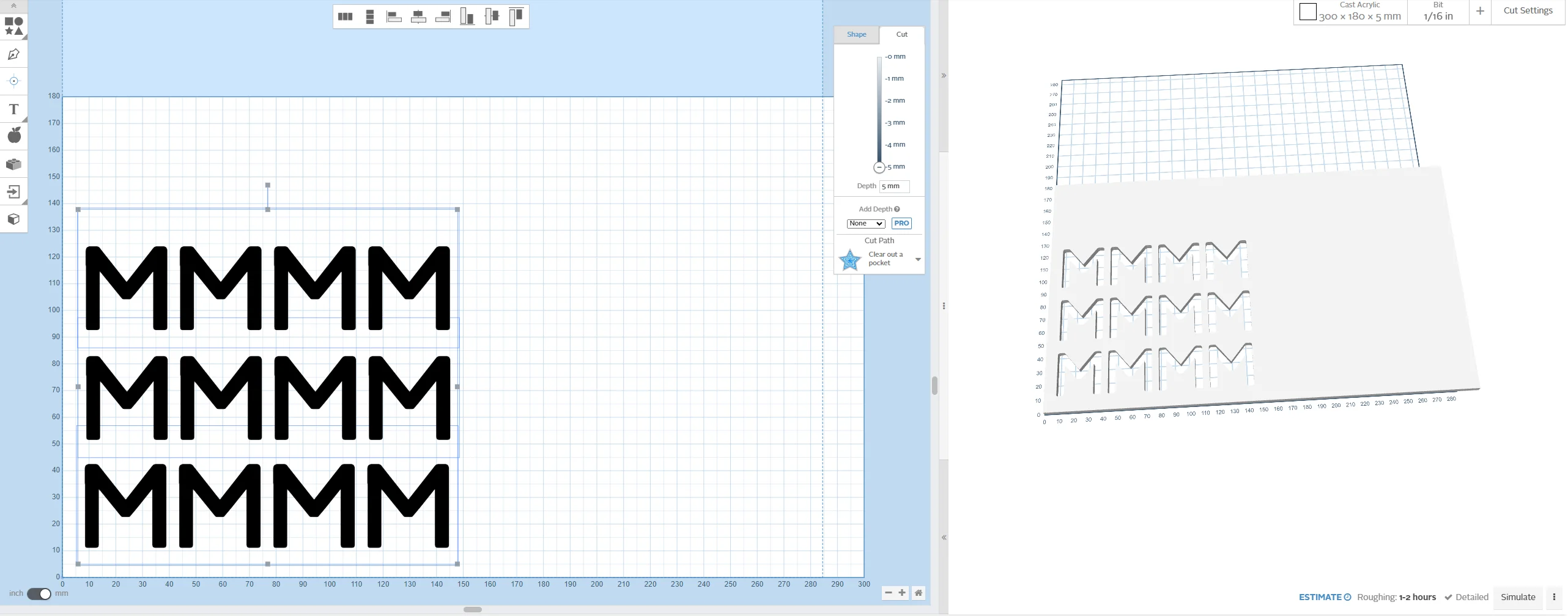

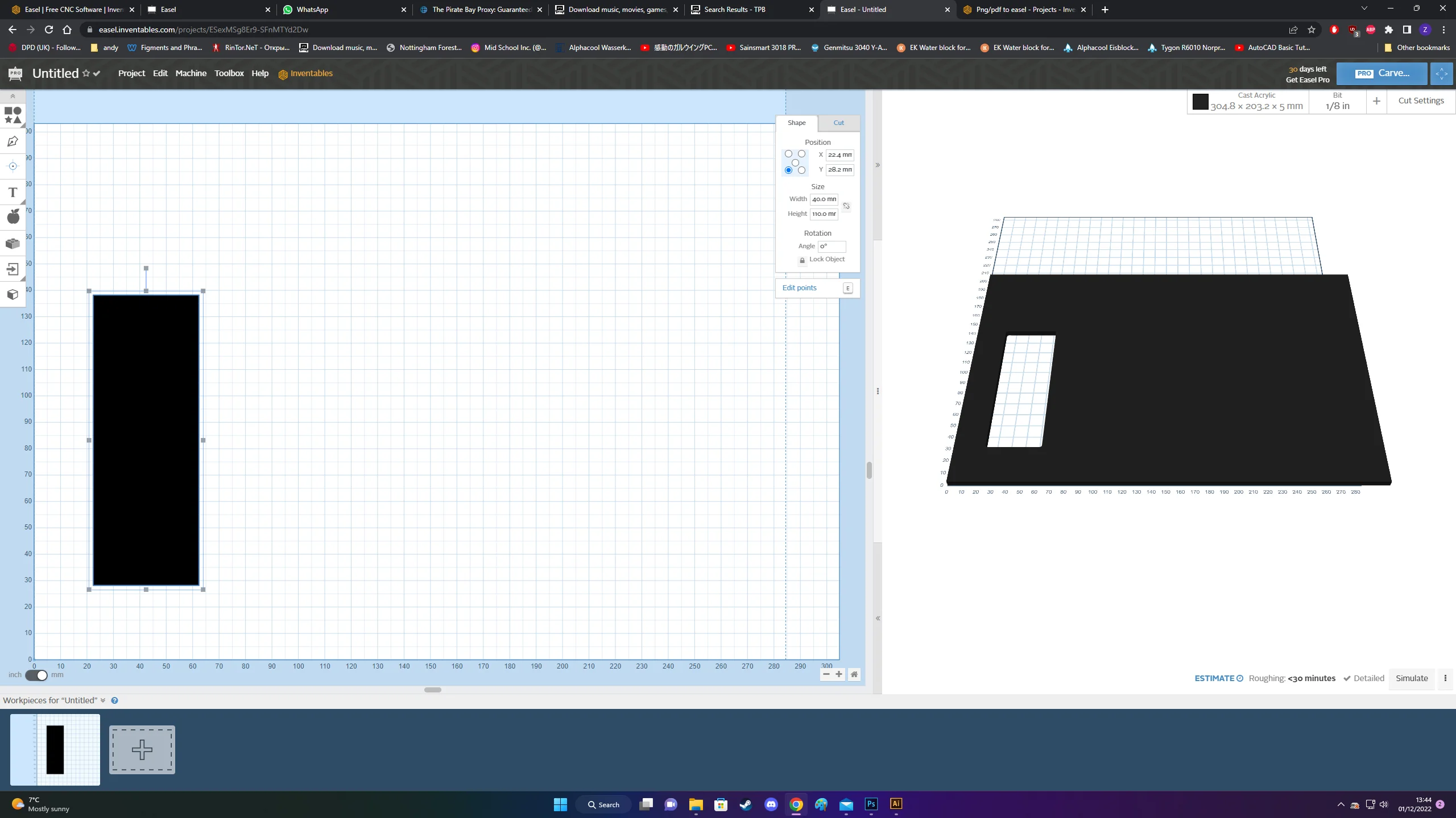

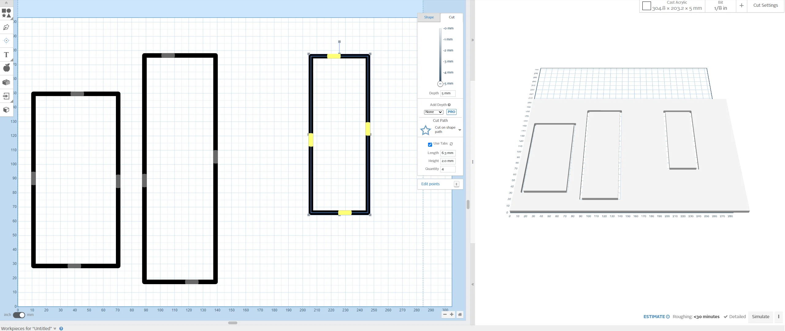

The software I had decided to use is called Easel. So today I installed it and hoped it would just open a PNG I had created in Photoshop. It doesn't. **** !. However, I then realised that it did open SVG files. As such I drew a quick knockup in PS, then opened it in Illustrator (which I really don't know how to use I just know how to convert into vector with it) and...
BANG.
Disclaimer. Before you go into a rant about how it is crap, rubbish, etc. Bear this in mind. About ten years ago I bought THE CHEAPEST plotter for cutting vinyl on the market. I am still hammering it to this day.
I do not want it to do anything more than I have planned for it. Meaning, I want to cut out PSU mounting holes, IO holes, and holes for a GPU back plate. I also want to cut fan grille designs into acrylic. I will be using convection to cool the second box, which will be almost passive. This means that even if I were to use 140mm fans? this machine can do it. I am not bothered about speed, etc.
Everything I ever use it for will be acrylic. So yes, I know I will need a spoil board. I will make that myself. Good way to test it without wasting plastic.
Oh and I forgot. I will not be using this machine to cut the panels. They are too large. I am quite good at cutting straight lines into acrylic any way, and have the tools to do so. What I hated about using my hands was that you could never cut inner cuts straight, due to the way you need to angle the cutting bit in the Dremel to cut through the material. That is where this comes in !
It's crap! It's rubbish!...When can I send things to you to cut?! :D
The 12th. OF NEVAH !
Starting to get my head around it now after earlier's cluster mess.
As I explained in the Email I could not understand why, when I hit the "simulate" button, that it was going to take nearly two hours to cut out three holes. Then I started reading about tool paths. It seems had I not realised this it would have literally turned every piece of the acrylic inside the holes into dust :D
Once I learned you can cut inside the shape path? about 17 mins it will take.
