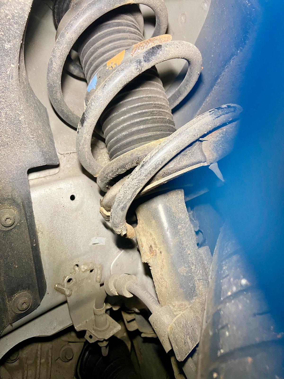

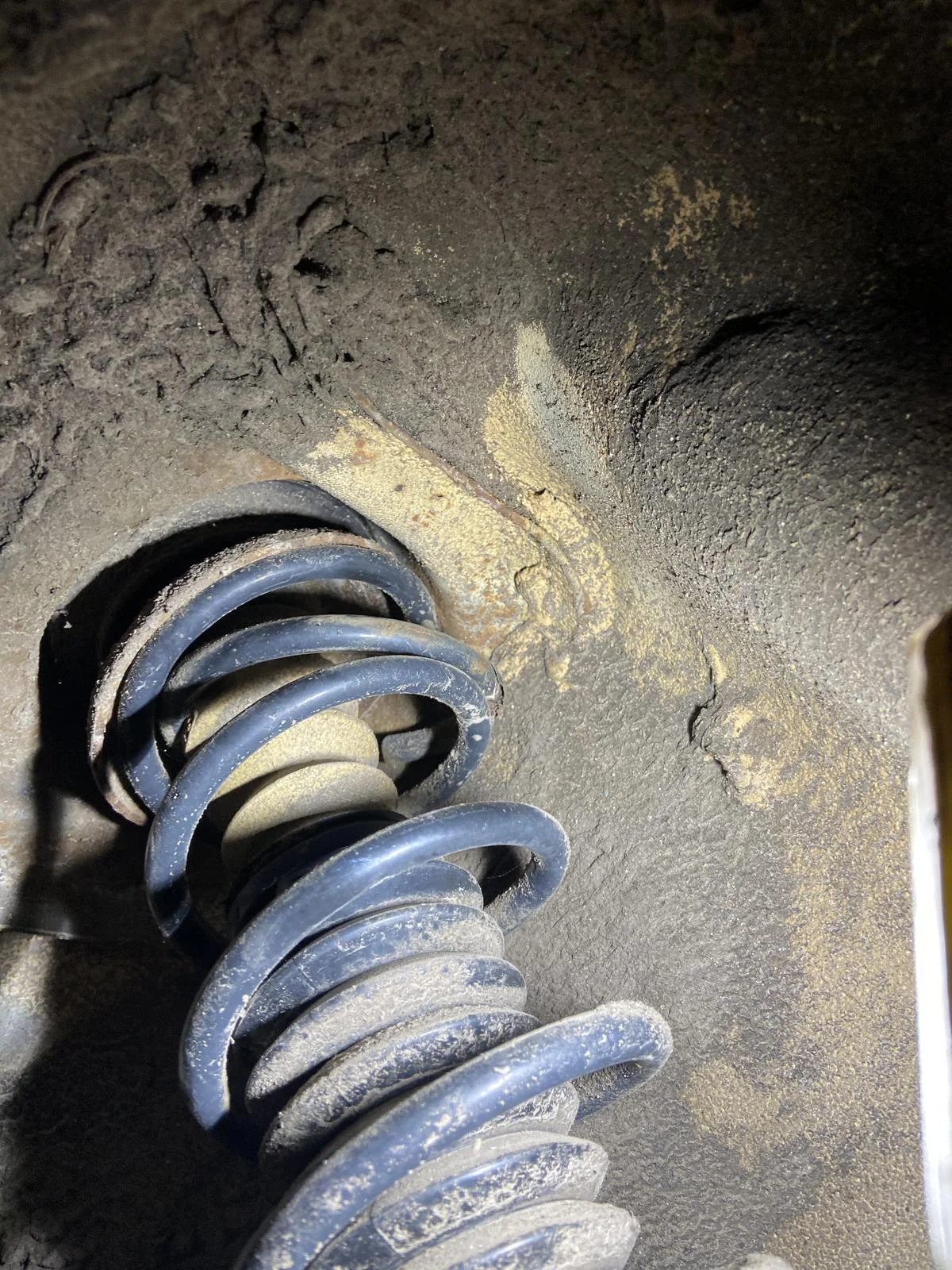

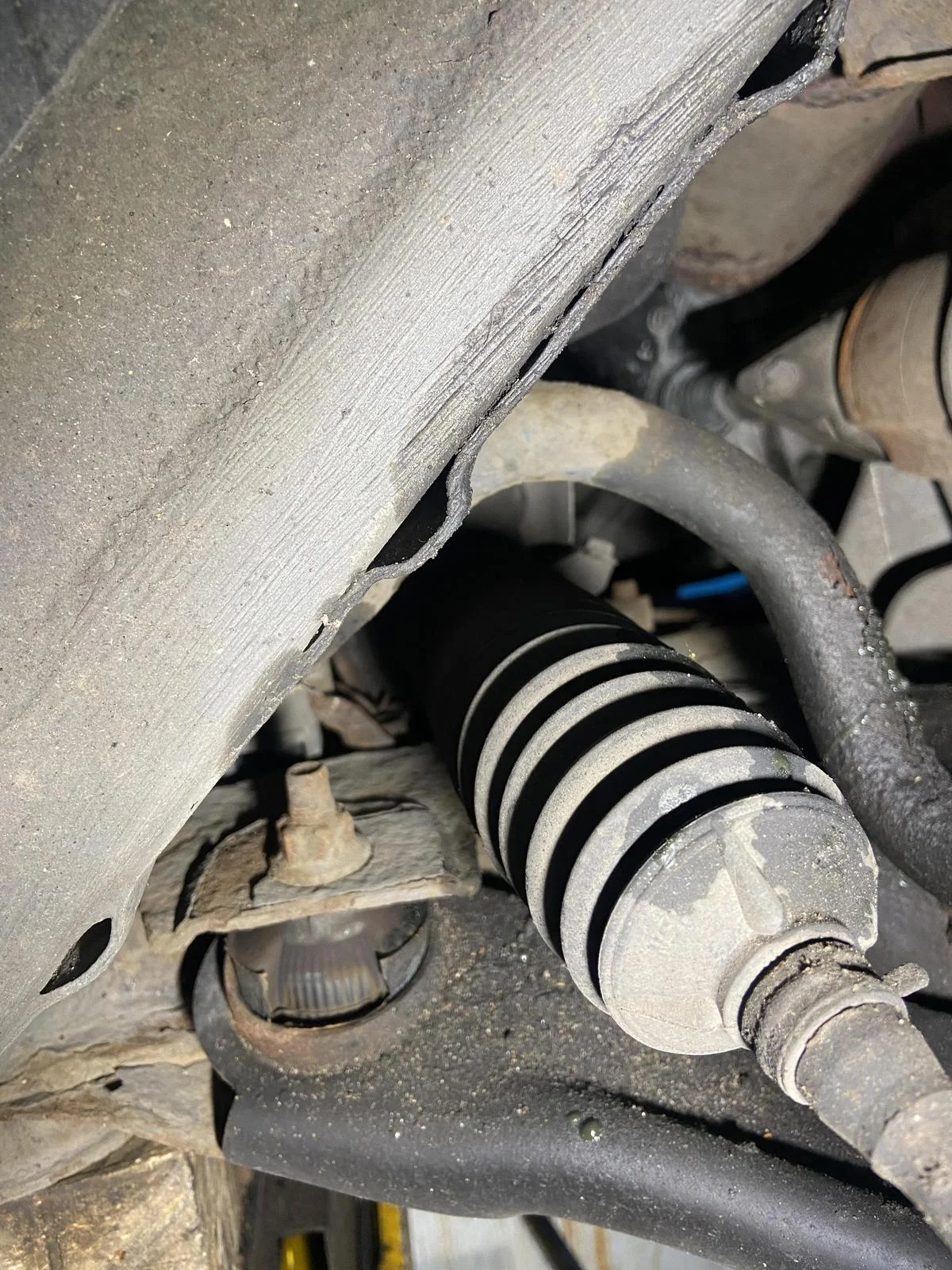

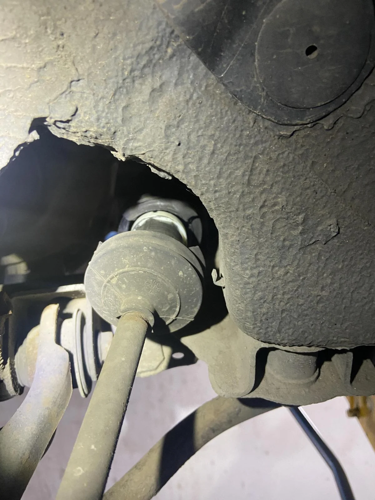

For example, these are some pics from cars I tested today..
Fairly obvious the problems above.

Steering rack gaitor completely split and welcoming in road grime and god knows what else.
Lower suspension arm bush almost completely seperated from the arm, and the other side was the same.
Also one of the bottom ball joints had excessive play, as well as both CV boots on the O/S being split and spewing grease, and rear pads about to go metal to metal.

I don't think split gaiters and snapped springs are going to cause a huge accident as such, car might drive weird but overall catastrophic failure would be very unlucky.
When it comes to tyres though, those should be assessed annually. The state some people leave them in within 12 months is bad enough, allowing another 12 months plus our usual weather... Gonna be the cause of even more unecessary accidents in my opinion.
Snapped spring can easily drop off the spring cup, casuing that corner to suddenly drop with possible loss of control, or it could (and quite often does) drop and dig into the tyre causing quite a rapid deflation of the tyre.
Rack gaiters, not generally going to cause issues for a long time but water and grit in the rack isn't going to do it any favours. Unlikely to cause any sudden problems, but it's still something that should be functioning correctly.
