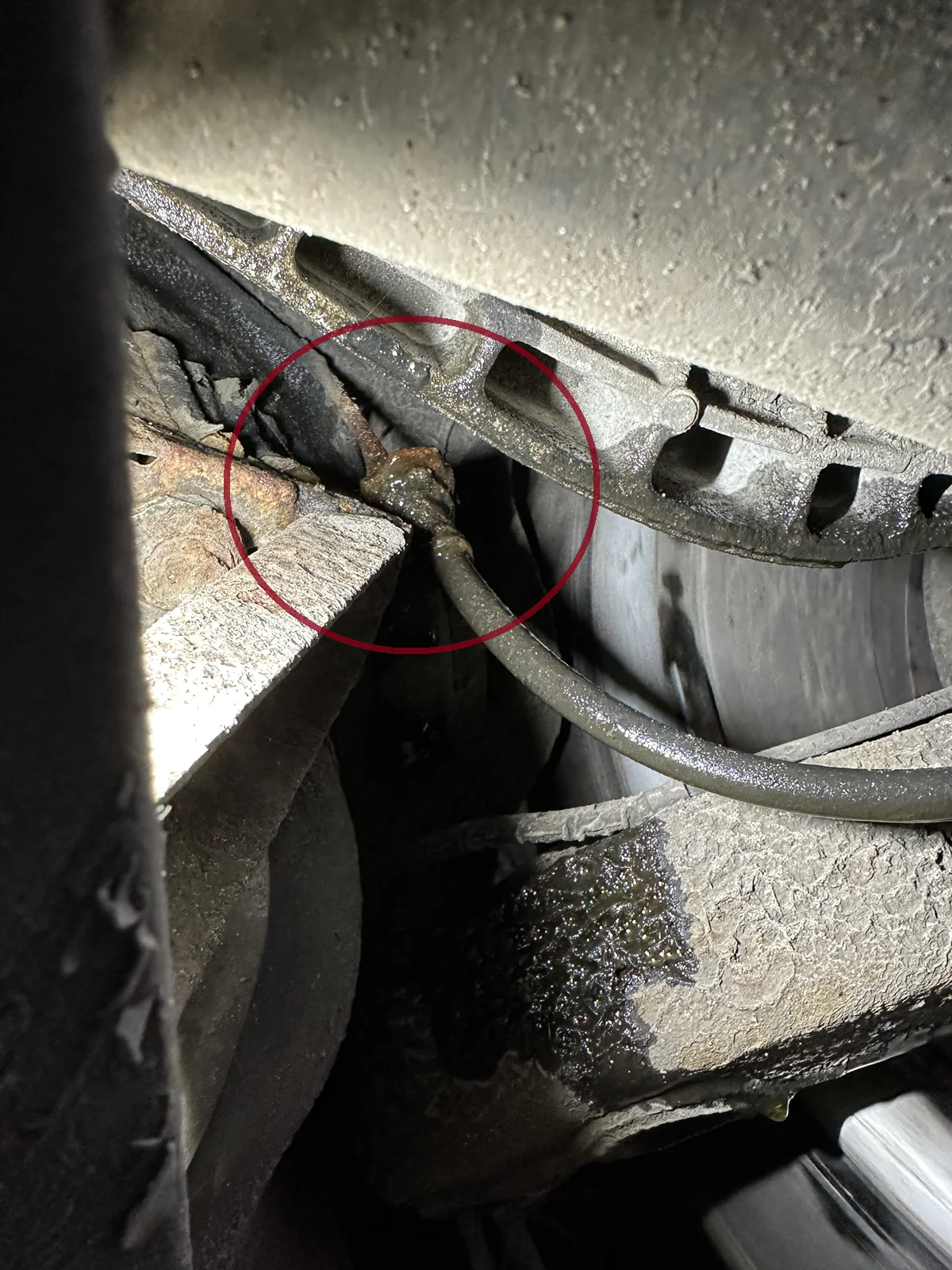

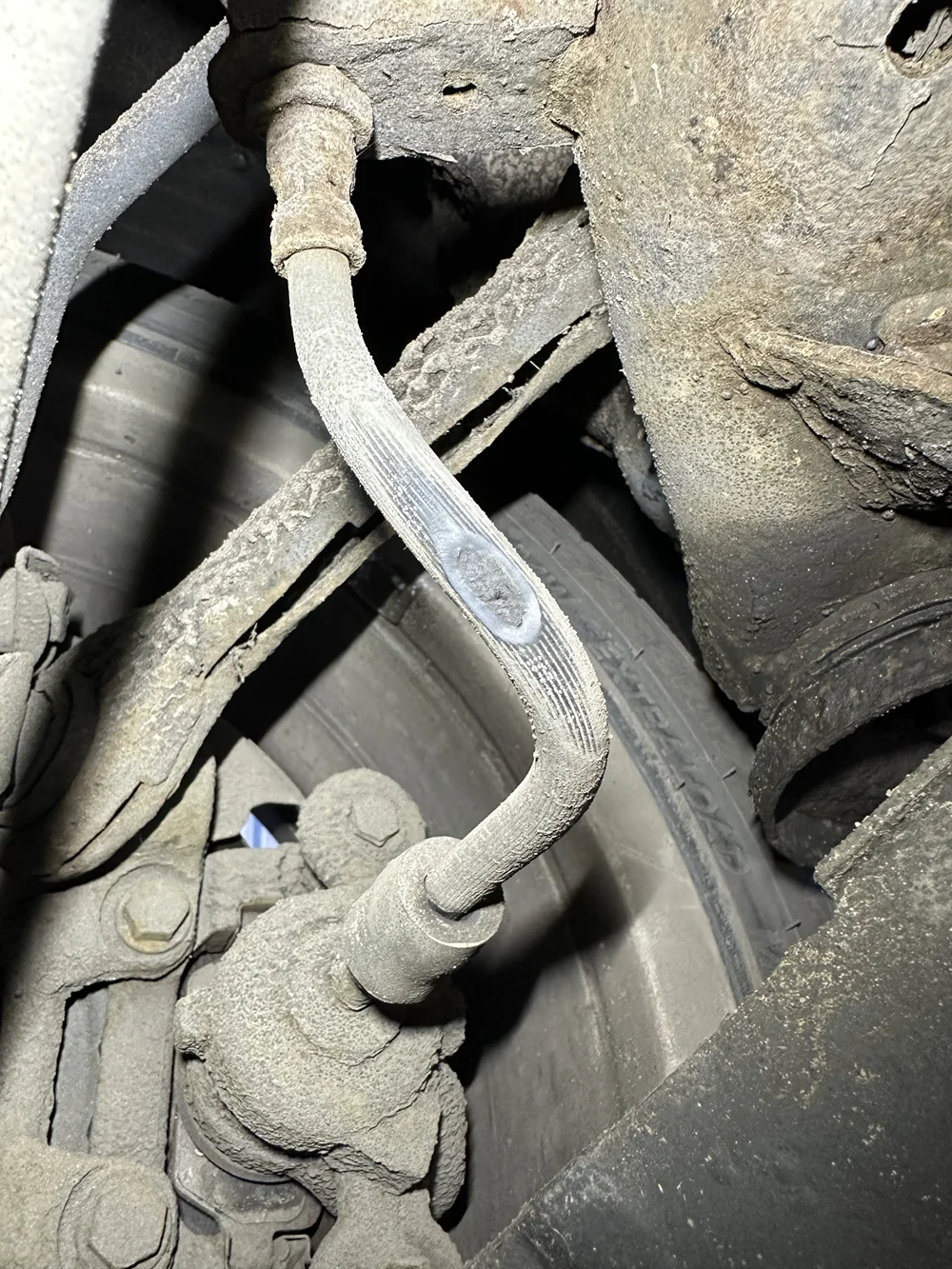

Had an old 3 series cab in today, and the first thing I noticed when driving it into the MOT bay was the brake warning light on, which one might assume could possibly give some concern to the driver, but obviously not in this case.
Anyway, I logged in and had a quick nose underneath before starting the test, and there was bit of an issue with the OSR brake pipe which had decided it didn't want to contain brake fluid anymore..
I did ask the customer whether he'd noticed any problems and whether he'd like me to continue carrying out the test (he hadn't and yes he would).

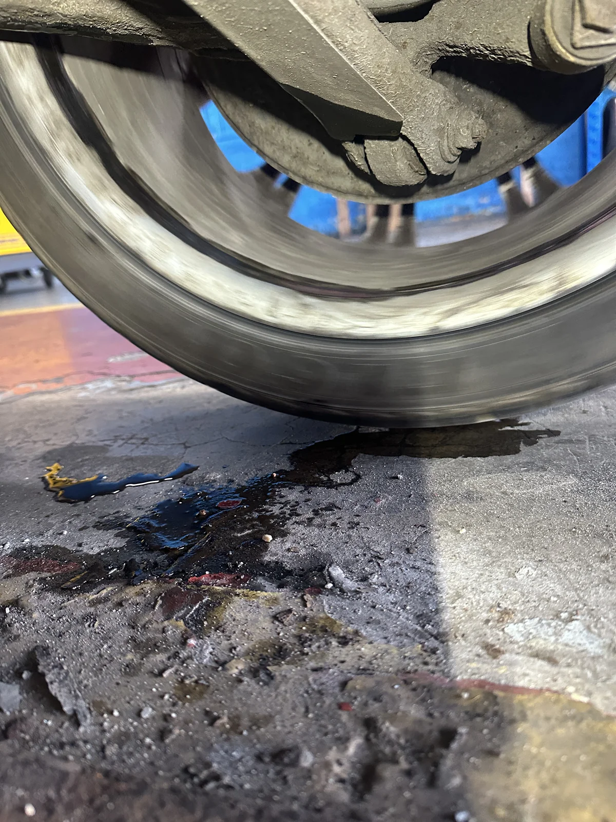

This is how much brake fluid had made a break for freedom after a short while, it's just dripping out..
Doesn't look like much, but considering how little fluid a brake system holds, it's not ideal after a few minutes.
The rest of the rear brake pipes were at the point of failing (MOT advisories since 2019) and did indeed fail the test today.
We did quote for the repairs (not a nice job, the fuel tank needs dropping as well as all the other stuff) and offered the customer to leave the car with us until he could get it recovered home, but nope he decided the best course of action was to drive it home whilst brake fluid was literally pouring out of his car (he lived quite a few miles away).

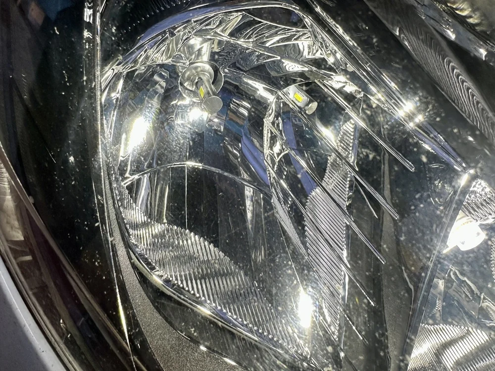

Some more silliness.
LED bulbs in an incompatible lamp.
There was absolutely zero beam pattern (just a blur of light) and god help anyone driving towards that car at night..

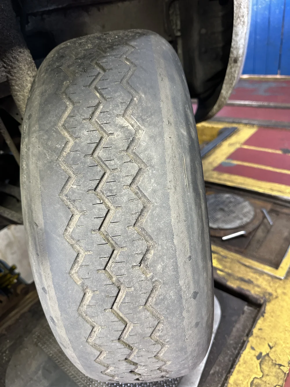

That wouldn't have lasted much longer, and lucky it came in when it did..

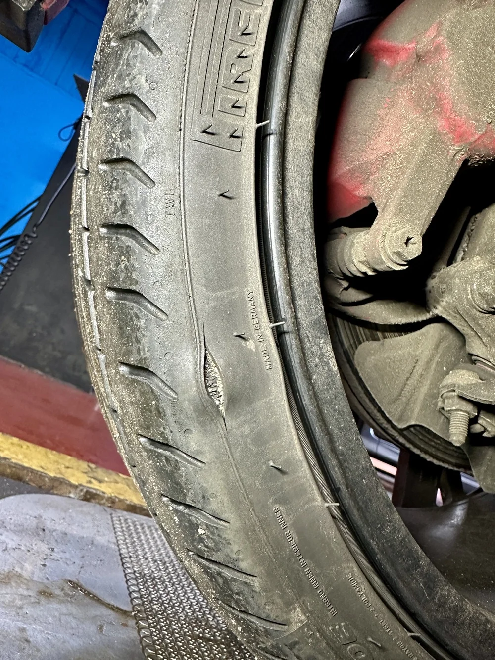

and speaking of tyres, don't run them underinflated..

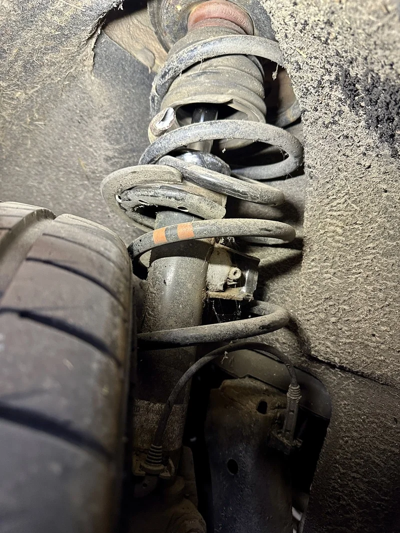

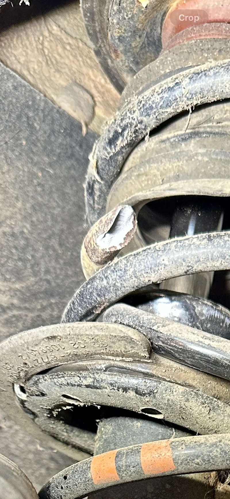

and the piece de resistance was this broken coil spring, which in itself isn't unusual, but in this case the car was so low on one side the tyre was rubbing on the wheel arch when driving over the smallest of bumps..
How the driver didn't notice is anyone's guess.

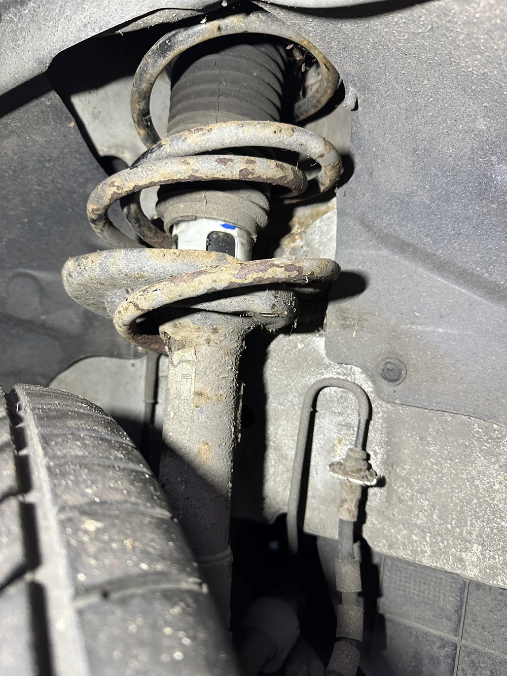

and just for fun, some bits of a Peugeot..
A lady pulled onto the forecourt today complaining of a noise then a burning smell..
Doesn't look too bad, but..
That'll be the burning smell, and it wouldn't have been long before the spring had worn through the tyre sidewall.
She did well by not ignoring it.
Just to add, when we put an advisory for "coil spring corroded", it's for a reason.
People always seem to blame potholes for snapped springs, but it's the corrosion that causes them to fail..

What causes the spring to come off the bottom stop, is it just that the straight bit of the spring snapped off and the rest is a corkscrew that just winds itself down?
Or the spring has a larger diameter in the middle. Also remember they are under a fair amount of tension, so if they break suddenly there will be some amount of force that pushes them down.
