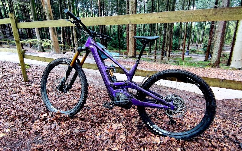

Changed it all out, now to go and bed in. First impressions though are a resounding WOW. I put in new pads too after the fact, some MTX reds and im properly impressed. The MDR-P is also rather tasty! I just need to modulate my trigger happy fingers a little now to save myself from going over the bars! :D
Like the new brakes! How do you find the mullet setup as I’m after a new full suspension mountain bike but unsure whether to both 29” or mullet (29”/27.5”)?

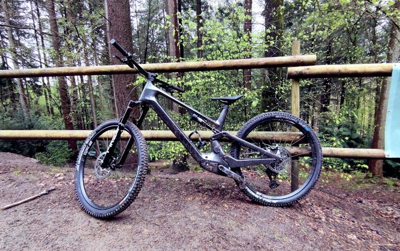

A 29er front and rear with a more conventional head tube angle and shorter suspension range in the region of 120-140mm I found on a 29er front and rear to work and feel really nice . This was a Scott Spark 930 fyi, and it was lovely to ride on the limited amount of time I had on it. I did feel that it wasn’t as well suited to climb as the Status with its 29/27.5 mullet, it just didn’t feel as grippy in the rear however I didn’t feel as tired whilst climbing on the Scott if that makes any sense.
The relaxed geo, mullet set up makes the status feel more closely related to a DH bike than a cross country bike if that comparison works for you, I appreciate it’s an Enduro bike but it’s hard to really describe how that translates in to rider feel.
I wouldn’t want to ride the Status for long trips on more flat gravel like surfaces though. It doesn’t have a lock out feature and it’s a bit wollowy which can and does take it out of you after a while.

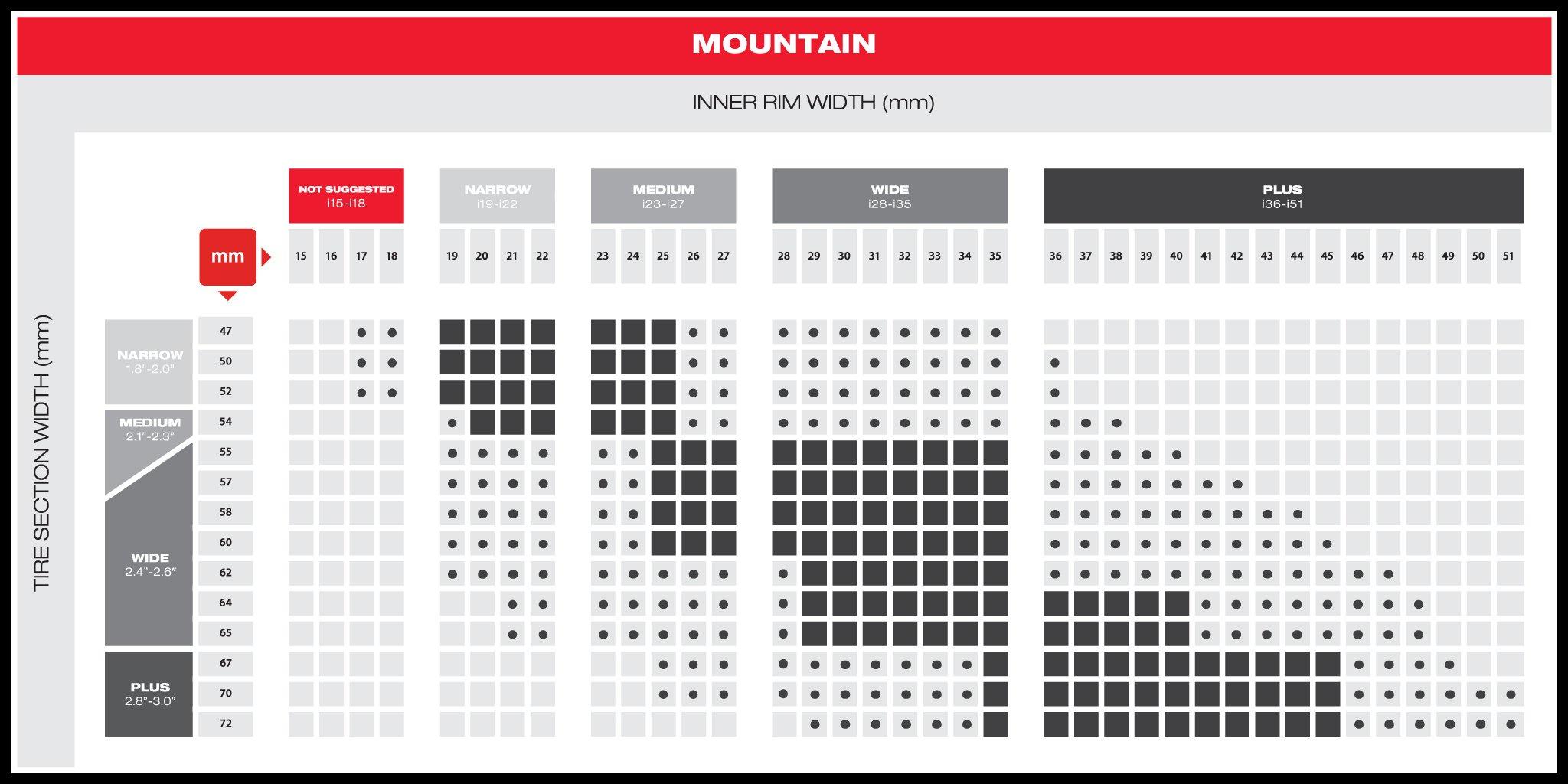

As you are on a hardtail, you may want a slightly wider profile tyre than normal. As an example, a Schwalbe 2.6" can give you some added comfort (and traction) but on really narrow rims, they will be a balloon.
Yea rim width basically dictates how wide a tyre your bike should run.
and most bikes will come with what the manufacturer considers the optimal widths anyway
Square = Optiomal , Circle = compatible
Source https://www.wtb.com/pages/tire-rim-fit-chart

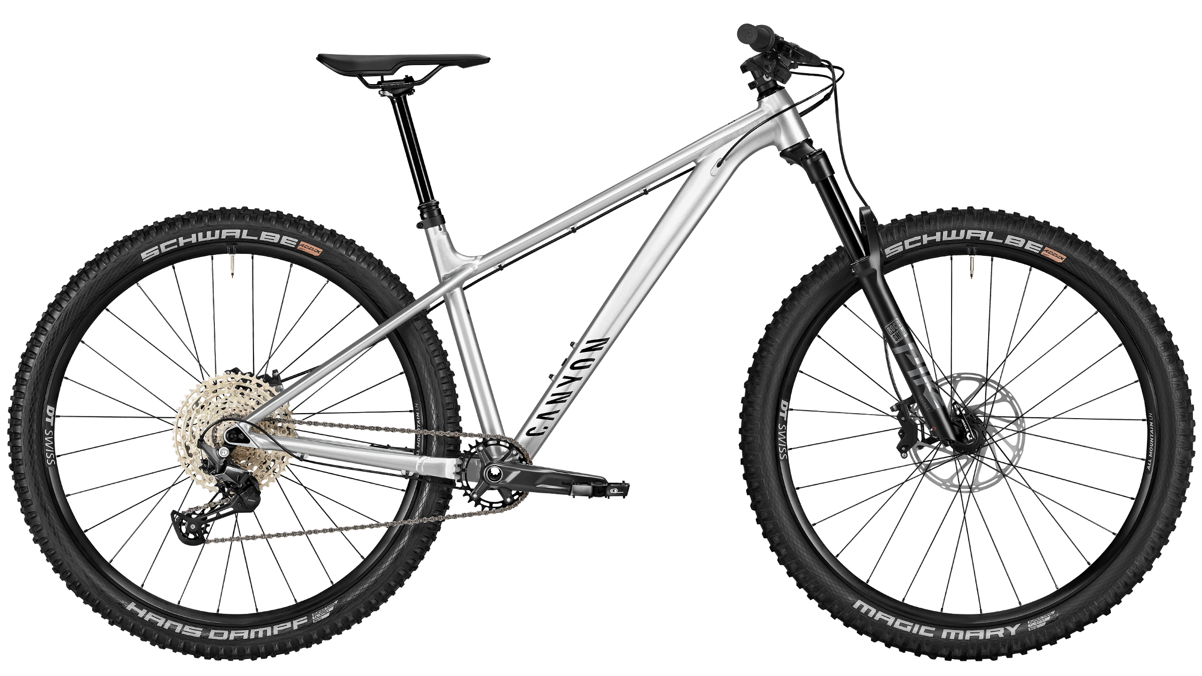

Quite excited to have just ordered my first Mtb in over 15 years!
I've been muddling on with an old Saracen, but it was knackered and I fancied a bit more adventurous cycling this year.
Went for a Canyon Stoic 3. Had a bit of a wobble on sizing, I'm 6'1" which puts me into their large frame but not by much, and my Saracen is a bit small, really, and I like how I can throw it about a bit. Stuck with large, though.
