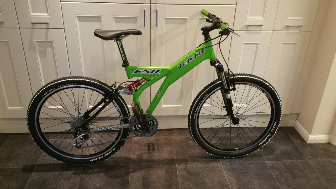

Pretty much done!
Got impatient waiting for pedals and stem and bought a cheap stem and nicked some cheap pedals off another bike and got it all built up today.
Gears need a bit if adjusting and the saddle is also nicked from my hardtail and is terrible.
All up weight is 14kg :D
Feel so much nicer than my hardtail.
Once my real stem arrives I will cut the steerer and get it set up for a ride, hopefully next weekend!
