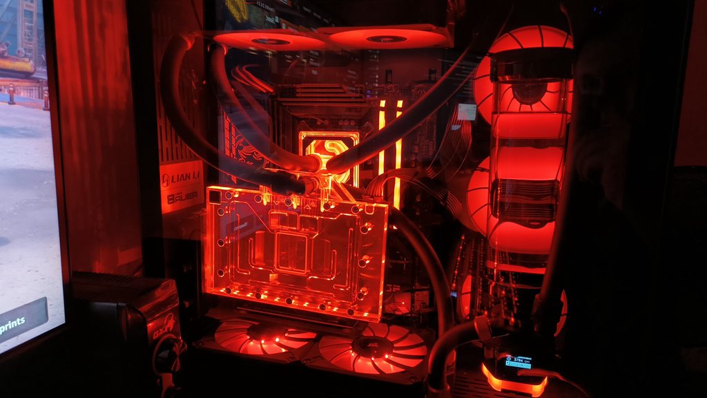

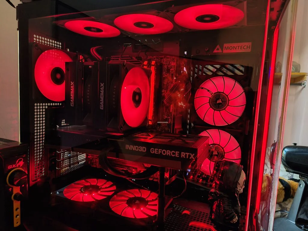

So here is the before and after on my transfer from water to air.
This seems like a current trend.. a lot of people cant be asked about the extra time it takes to setup/maintain etc a proper loop, beside the obvious extra cost. I can certainly see it become more and more infrequent choice - shame though, as its likely to reduce the investment in technologies and innovation in this sphere.
After testing my cpu and gpu for temps, i was surprised. My cpu temps under max load 170watts hit 72c after 30 mins of load. As for my gpu it's better than i thought at 60c and 70c hotspot 230watt 30 mins. Memory temps are good at under 58c max recorded. At 3000mhz 1.050v i got 75c and 86c hotspot with 67c memory which again is not bad at 320watts.
