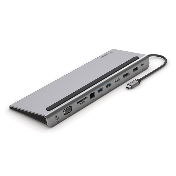

Belkin USB-C 11-in-1 Multiport Dock
This is my point - this only has one usb c port as far as I can see?? Is that a VGA adapter too????
