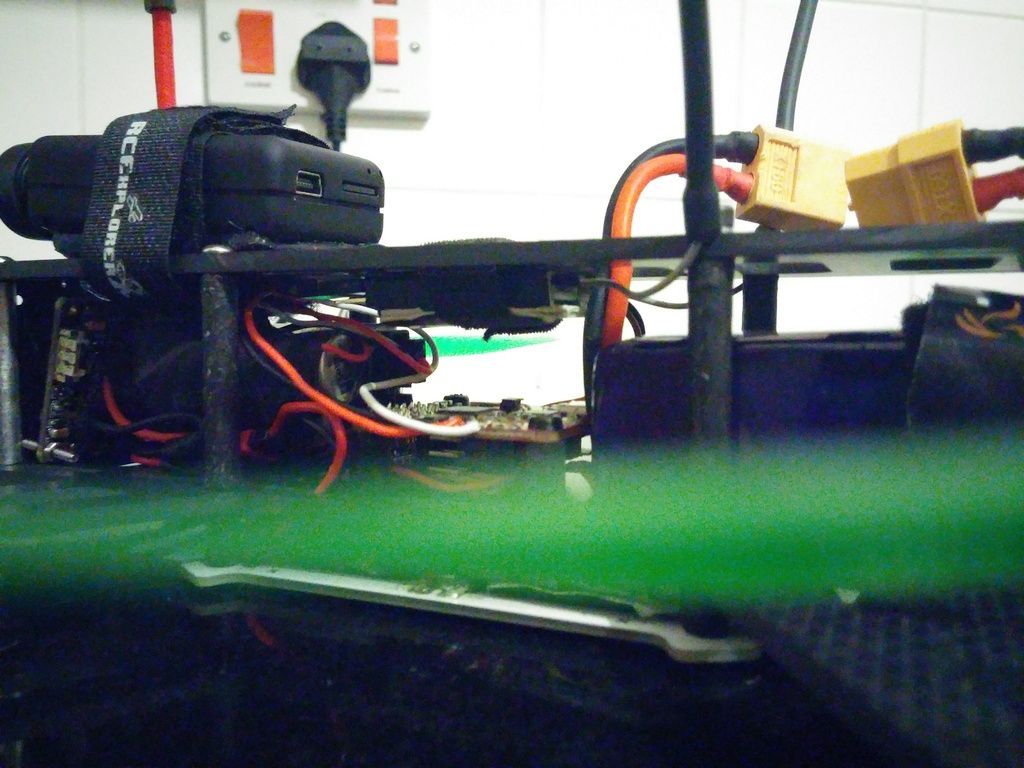

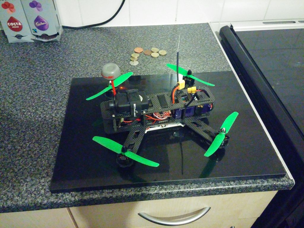

rebuilt the QAV today, I took the old bottom plate and cut the arms off to make a extended thicker top plate, turned out quite nice too. It will enable me to use a larger battery on top when I go 6" with the arm extensions and have ample mounting room underneath.

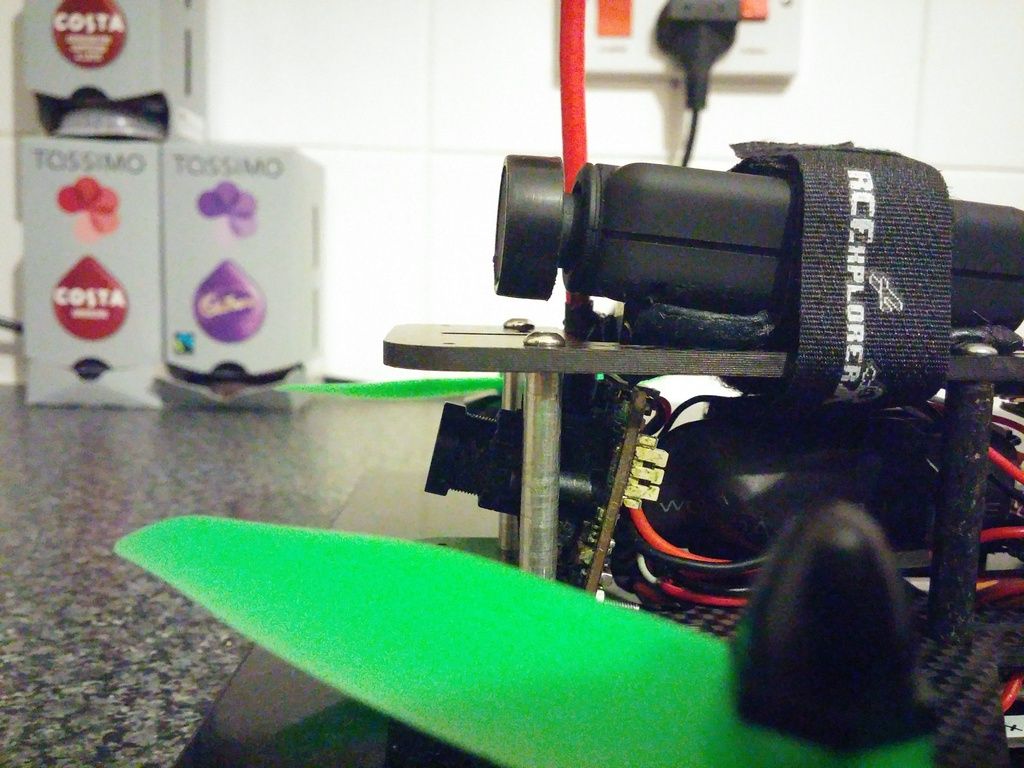

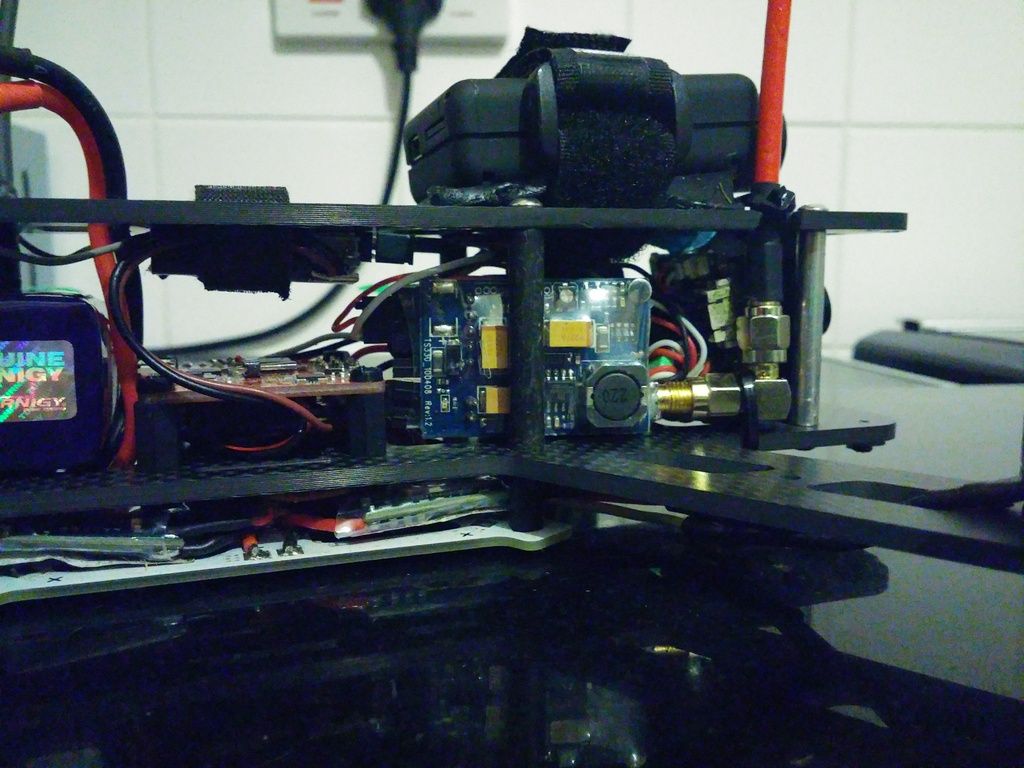

Mounted the VTX up front
Got some washer wire crimp terminals that worked out great for mounting the antenna.
And finally to finish it off i tilted the camera for better viewing angle when flying fpv.
The hideous green props are some of the Gemfan 5040's i ordered, 40 arrived this morning and another 36 yet to arrive. Hopefully the weather is dry and not too windy tomorrow so i can take it out and test it, should be a beast!

Its back :D nice reuse of plate

Kanifee, is your Rx in the front bay with the Tx? Did you find any issues running like it like this? The recommendation is usually to try and keep the Rx and VTx as far as possible from each other.
My rx is mounted in the center of the top plate, i dont think separation is as big of an issue with 5.8 and 2.4ghz equipment, now using 1.3ghz and 2.4 it becomes a real issue, the suggested minimum distance for that set up is like 30cm of separation.
