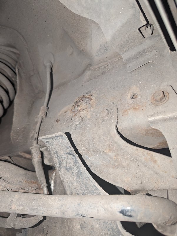

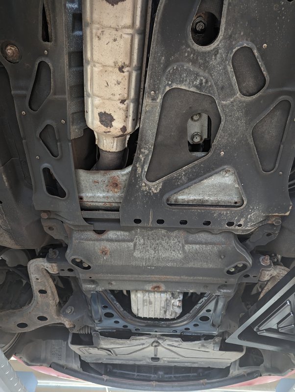

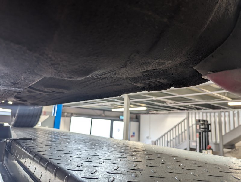

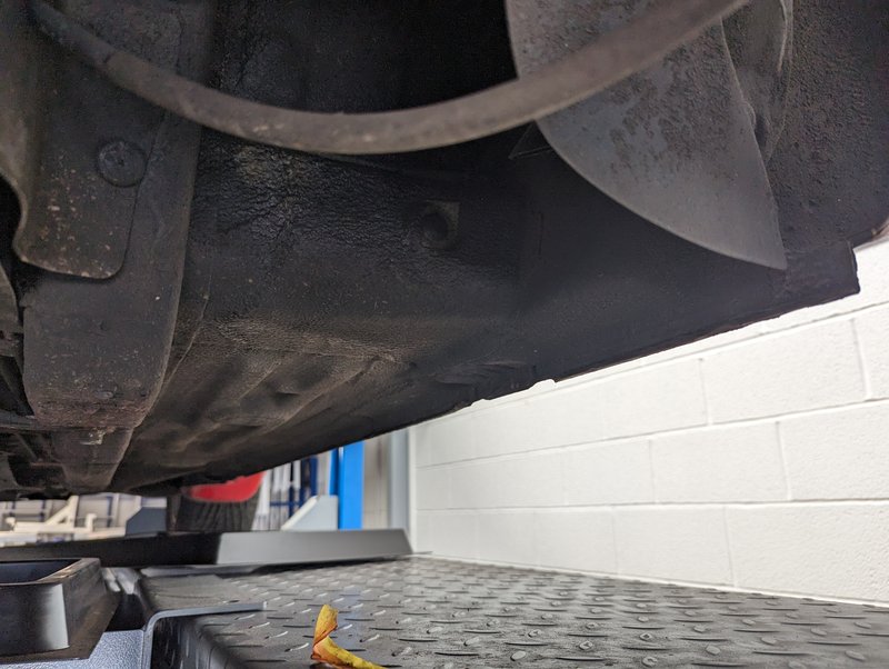

Kicked an MG off and Managed to get the car up on dad's storage ramp. How bad is mine overall? I think it's ok? Average maybe? The first 2 pics are my attempt at finding the chassis Rail corrosion that was mentioned on the advisory. One side looks good, other side is just coming through I think that's what they were pointing to
Yeah, looks like possibly a bit of a rust blister breaking through. You might have to be brave and stab it with a screwdriver.... or at the very least remove the flaky bits to see how bad it is underneath.
Apart from that though, it looks superb. Looks incredibly tidy underneath. Have the sills and arches been cavity sealed internally? If not, now may be the time to do it to keep it looking that good for a long time!
This is promising to hear. I don't know what to expect when looking under a car for this so thanks for that comment.
I've asked for a quote from a customer we do work for to quote on the chassis Rail Repair.
Regarding the cavities etc, I don't know. I feel it could be time aswell.
The previous (and only) owner claimed to have it all treated upon purchase back in 2001, and regularly topped up for a while there after. However in more recent years, due to lack of use, I feel that stopped.
