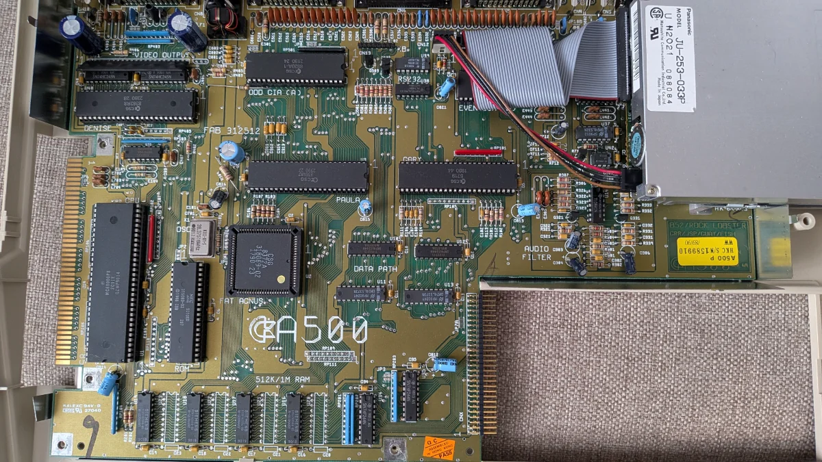

I'd heard horror stories about leaky batteries and capacitors so first job was to open it up and take a look.

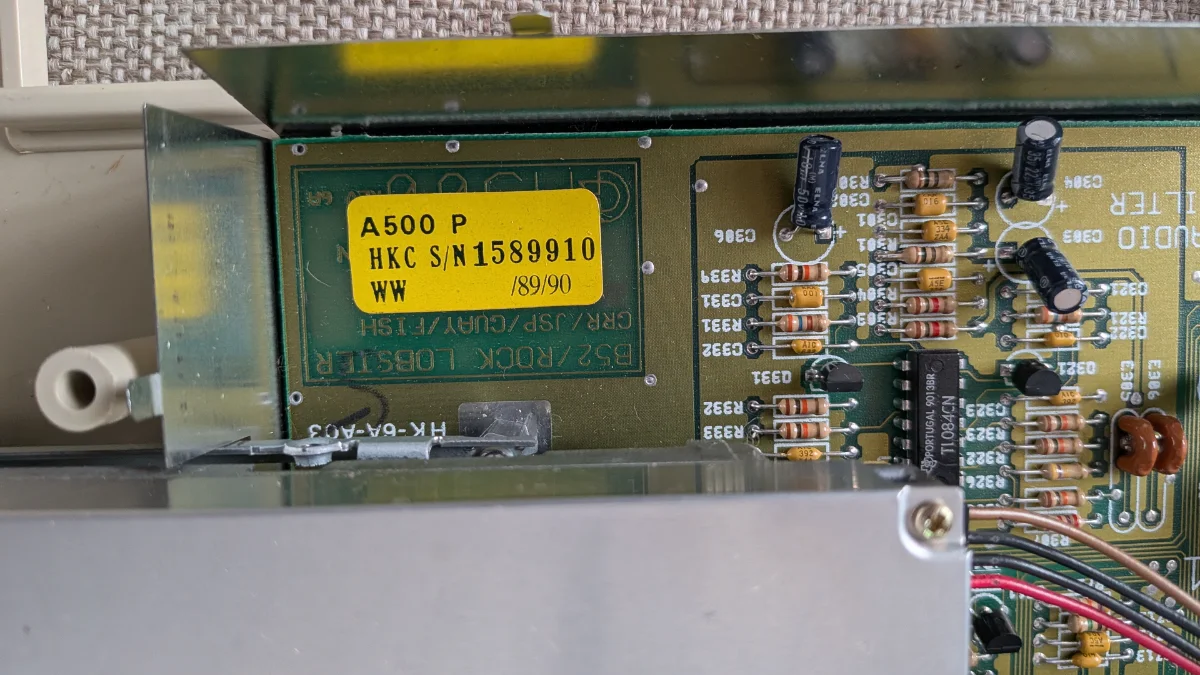

I'm really impressed by how clean the motherboard is. There's no obvious corrosion or damage, and there isn't a battery/RTC circuit to worry about on this particular board from what I read so thankfully there's no battery leakage to deal with either.
The capacitors don't show any obvious signs of trouble, although unless they were leaking or charred I probably wouldn't know any better.

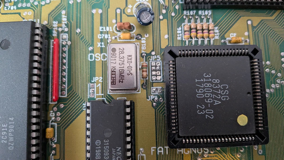

I've included the motherboard photos because I'm interested to see what people can identify from it. I'm particularly interested in the board revision, chips, and anything else that might be unusual or noteworthy about this particular machine. I ran them through ChatGPT but it kept giving me conflicting and wrong information or making up stuff like it has Rev 5 printed on the board when it clearly doesn't.

It looks like a 6A board to me. If you remove the FDD you'll see another label that will have the revision on it.
It's the 500+ that has the RTC and so a potential Varta battery leak, the 500 is generally safe unless an expansion card has been left in that then leaks.
The 500 and 500+ are generally 'fine' from a leaking cap point of view too - it's the SMD mounted caps in the 600/1200 that are a concern.

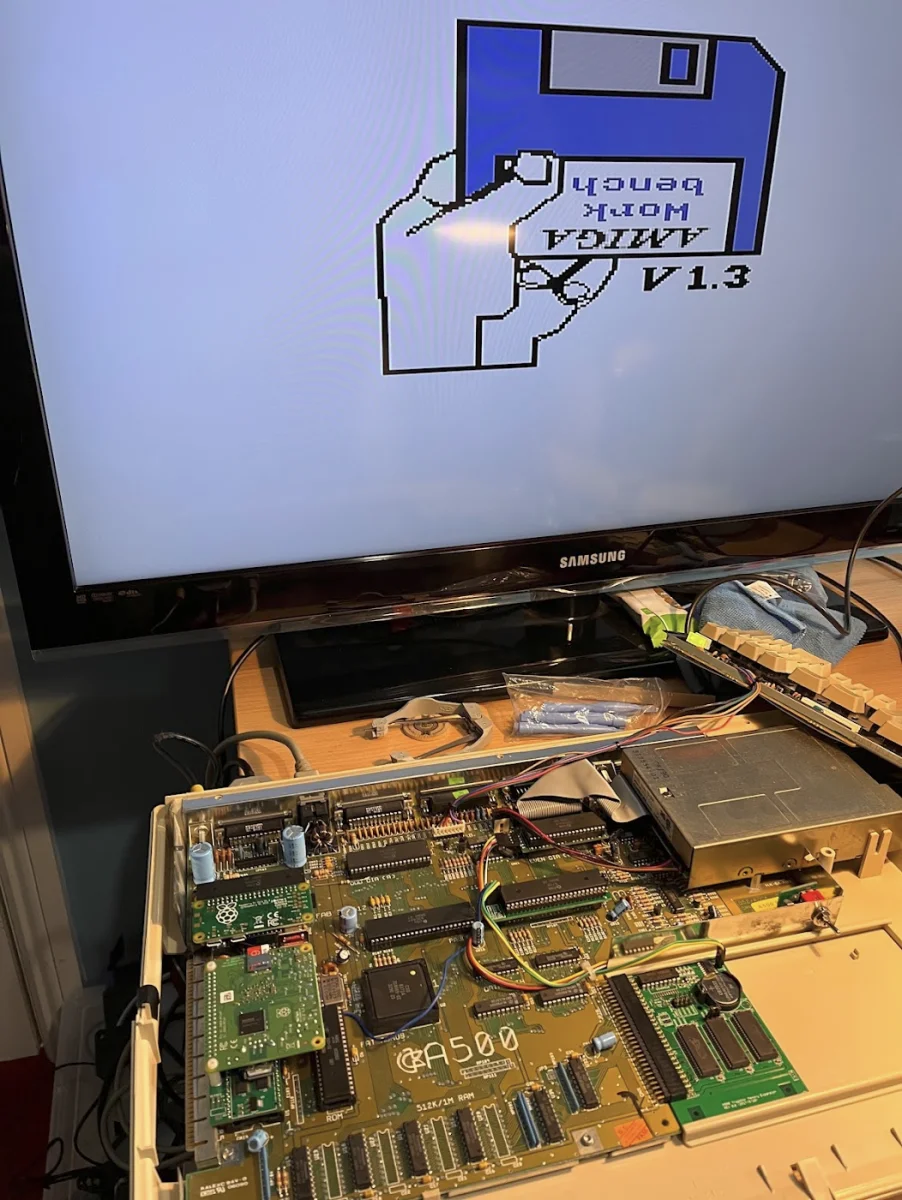

Connected the 520 box and then RF into my TV, did a channel search... It's alive!

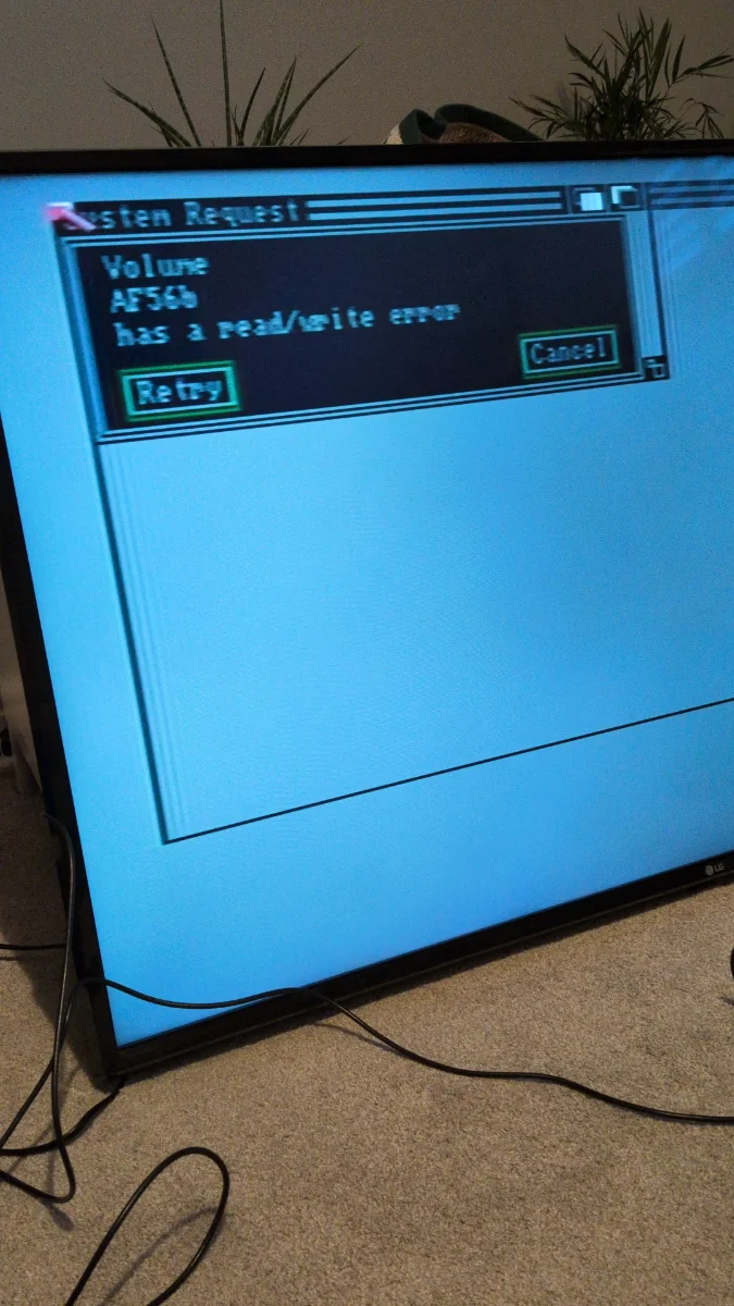

Picked up a couple of Amiga magazines from a retro gaming store in York (Sore Thumbs) which have the cover disks so will give them a go later and see if the floppy drive reads them (fingers crossed).
Edit:
The disks didn't load but I was able to get an error screen to show which allowed me to test the mouse is working so that's a result.
I have a working copy of Workbench 1.3 on the way so if that boots great, if not then the floppy drive might need a clean or replacing, will see.

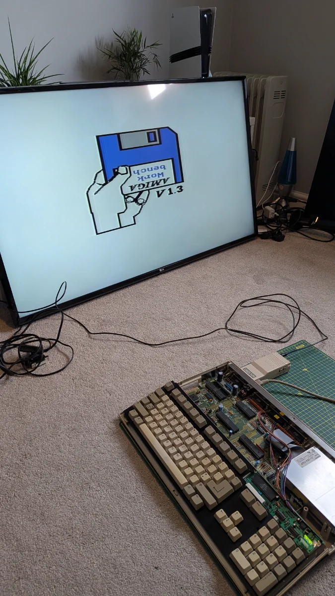

Workbench 1.3 disk arrived today and the Amiga booted it fine, bit noisy but I love hearing the sound of the floppy drive, so nostalgic.
Besides needing a deep clean the a500 seems in good working order which is great news.

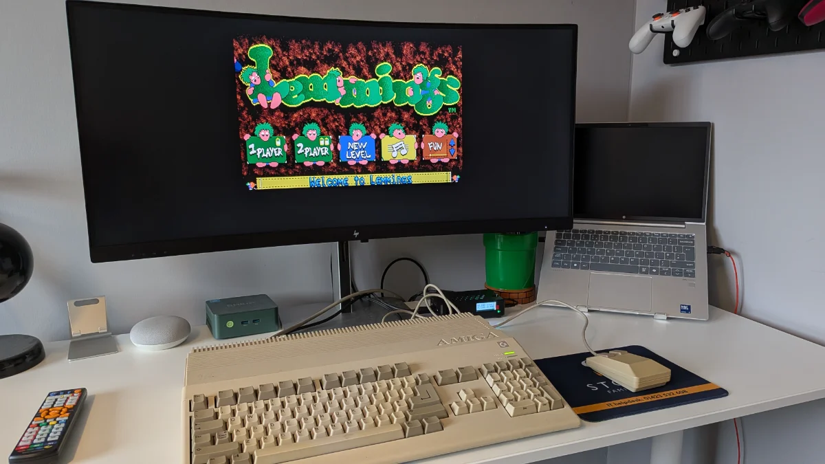

So I am up and running, playing Lemmings on an original Amiga 500... Man it plays great with this old tank mouse.
The Mister is great and all but this feels so awesome.
