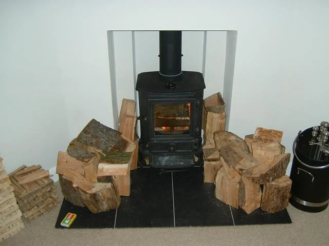

Using the Rothenberger to light the fire. 30 seconds with this bad boy and were off :)
That's cheating! I enjoy setting up the kindling with a few small logs to get it going.
I use 3 sheets of news paper ripped in half and scrunched up (not too tightly) underneith the kindling, and leaving the door ajar for about 5mins.

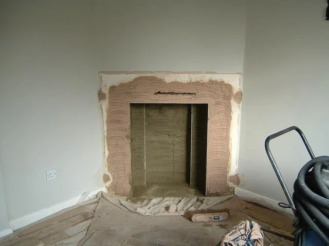

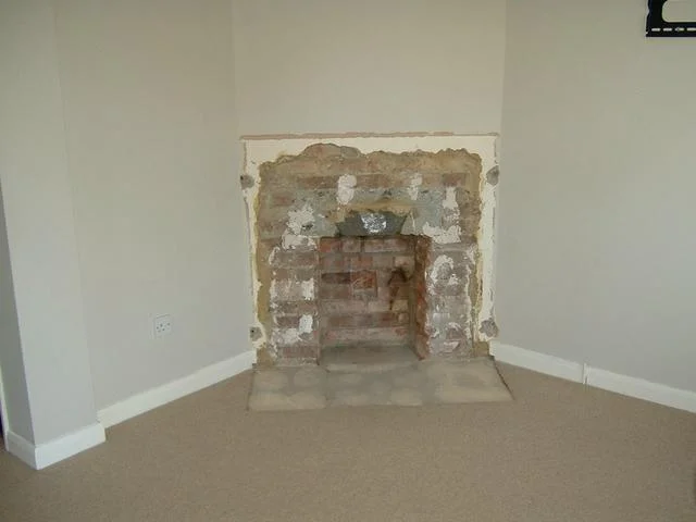

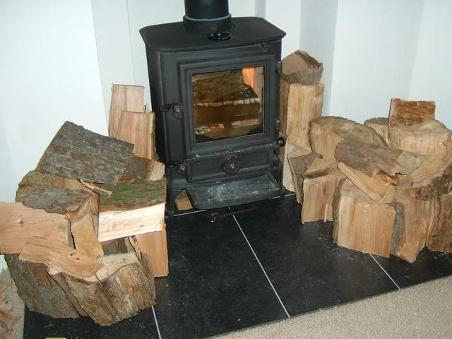

Just finished having it installed. Been using it for the last few days and it really kicks out some heat. It is a small 4KW burner. Wanted a contemporary look for the new build we live in and been really pleased with it so far. Was just a bare wall to start with and we had an electric fire on there for the last couple of years. Already had a class one chimney.
Where did you get that hearth from and what sort of price did it and the total build cost?

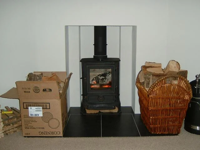

Gave mine a bit of a tidy up last week and finally picked up a log basket. Need another one now.. :D (apologies for large picture, imgur not playing ball)

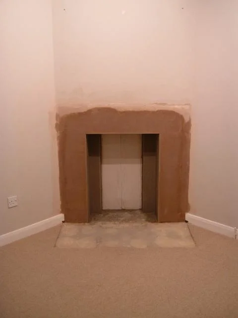

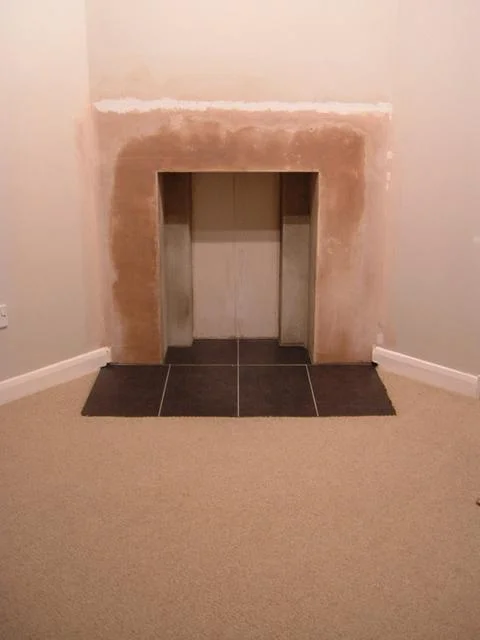

Here is a bit of a step by step of how it looked as it progressed (originally the fire place had a white gloss wooden surround with marbel everywhere):
Sourced myself.
Fire was £425, bought in Nov 2010, gone up a bit since http://www.vestastoves.co.uk/ was in the garage a year!
Hearth £425. Italian granite.
Oak beam £75
Fitting including brick work, flue lining, vermiculite etc. £1200.
Not bad as we were quoted nearly £4k from companies who do the whole package.
