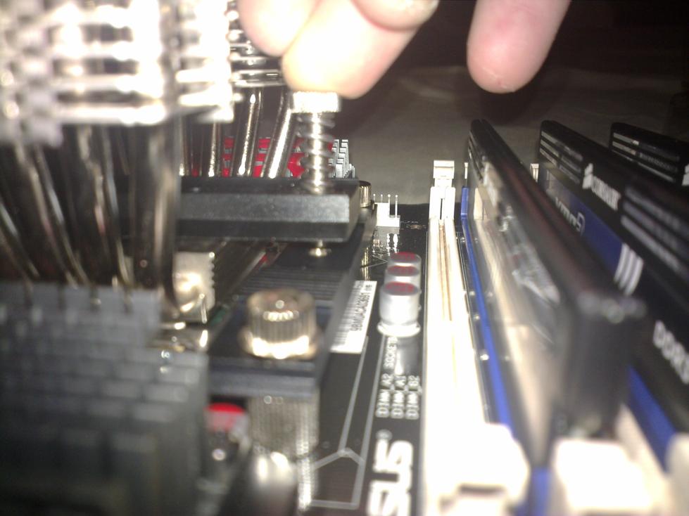

Having problems attaching the heater to the brackets though - worried about applying too much force to the spring screws - should it really require me to press quite hard?
This might help - the bracket that the cooler is mounted on. The opposite screw is in place, but not tightened, just so it's biting. Pushing down on this spring screw to get it to bight might require me to press quite hard. Is this normal?

Ok, so I got the spring-screws to attach to the bracket without TOO much force, just wondering how tight I should do them? They're each in about 3/4 turn atm, and just worried obviously about applying too much pressure.
So an update pic, cooler is attached, the fan is half mounted (in case I need to tighten the spring screws on the cooler bracket)
yes the fan cable is flailing around atm, I will try and sort that later.
So just going to wait on working out or finding out how tight the screws should be, then going to mount the mobo in the case :D
Found an answer :D just looked around at the different pics of builds using this cooler, and there were a few on the rampage, so just looked at how tight the screws were compared and tightened them a bit :D
