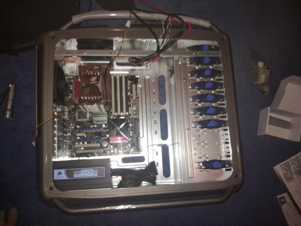

Motherboard is in :D looking more like an actual computer now haha

I put it in based on the stickied "System Build Guide" particularly:
this picture in that thread.
So which way is correct?
edit: I tried the other way up - the screw holes don't align at all, so I guess it was right in the first place.
Not sure wether you have or not - but both screws on the Megahelems need to be done up, some people do it all the way others dont. Ive personally not had any problems going as tight as the screws allow - the pressure is needed to make a good contact with the CPU IHS.
That fan sucks air in, i.e. the opposite way to the arrow in that picture, the whole point of the power supply being at the bottom of this case is to draw cool air in through the bottom of the case via the filter that is there, why else have a filter under the power supply ;). Using this method no warm air from the power supply ever enters the rest of the case, its in through the bottom then straight out the back again.
The case in that picture isn't the Cosmos and probably doesn't have a hole in the bottom either.
While you may be right, the screw holes don't fit, you can't mount the PSU the other way up in this case.
Also it turns out that with the Cosmos and the megahalem, the door wont close because of the door fan - so I'm going to remove the fan, I have a spare regular sized fan - but where would be better - top or bottom?
The PSU should have standard mounting holes and my PSU fits perfectly upside down as I have mentioned. Are you sure it doesn't fit because I have 4 screws holding my supply in place and there are at least 3 other screw holes free at the back of my case around the PSU mount to accommodate other screw layouts. My Cosmos is the original 1000 though, they also don't have a side panel with a fan in it either.

Have to agree with Andydigital regarding the psu, install it so the fan is facing the bottom of the case:>, and the screw holes should lineup regardless what way round it is.
I'm absolutely certain.... that it does fit the other way up haha :P might have been that I had the case on its side earlier so was more difficult getting the PSU back into place. But yes have turned it the way up you suggested now thank you.

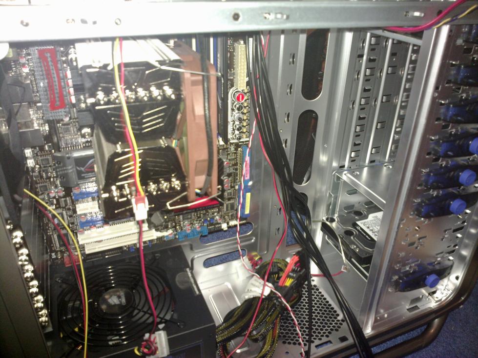

New picture: Front panel cables connected (can barely see on this picture) and these cables routed round the back and down.
All other cables are just dangling unconnected atm. PSU orientation has been corrected:
What model is the case ?

I have a fan on the harddrive stack already :) It's a Coolermaster Cosmos S.
