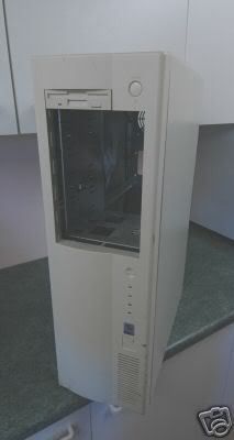

Im a newbie to most of this modding but i want to build a custom water cooled "Super Rig" while i have nothing to do this summer! Im thinking of purchasing this donar case.

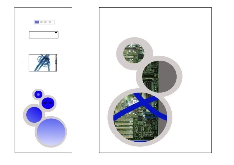

Do you think i will be able to turn it into my rough and ready artist imppression below? The bottom big circle on the front will show the water resovoir, second 1 up just blue light through perspex. The usb and power button will be in the other two, with all the circles being surround by aluminium trim. I also wanted an lcd mounted in the front and the drive above that and some sort of temp controller/readout.
My worry is whether it will be posssible to fill the gaps? I was gonna use filler to make it flat across the front, could i just put some sort of bevel in the hole the fill over it?

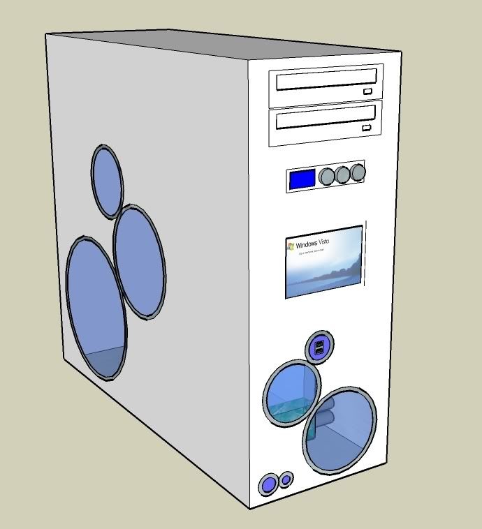

well i got the case so there is no turning back now :D how much are dremels these days? i got bord and made a 3D drawing of my intended plan
what software is that to draw it?
