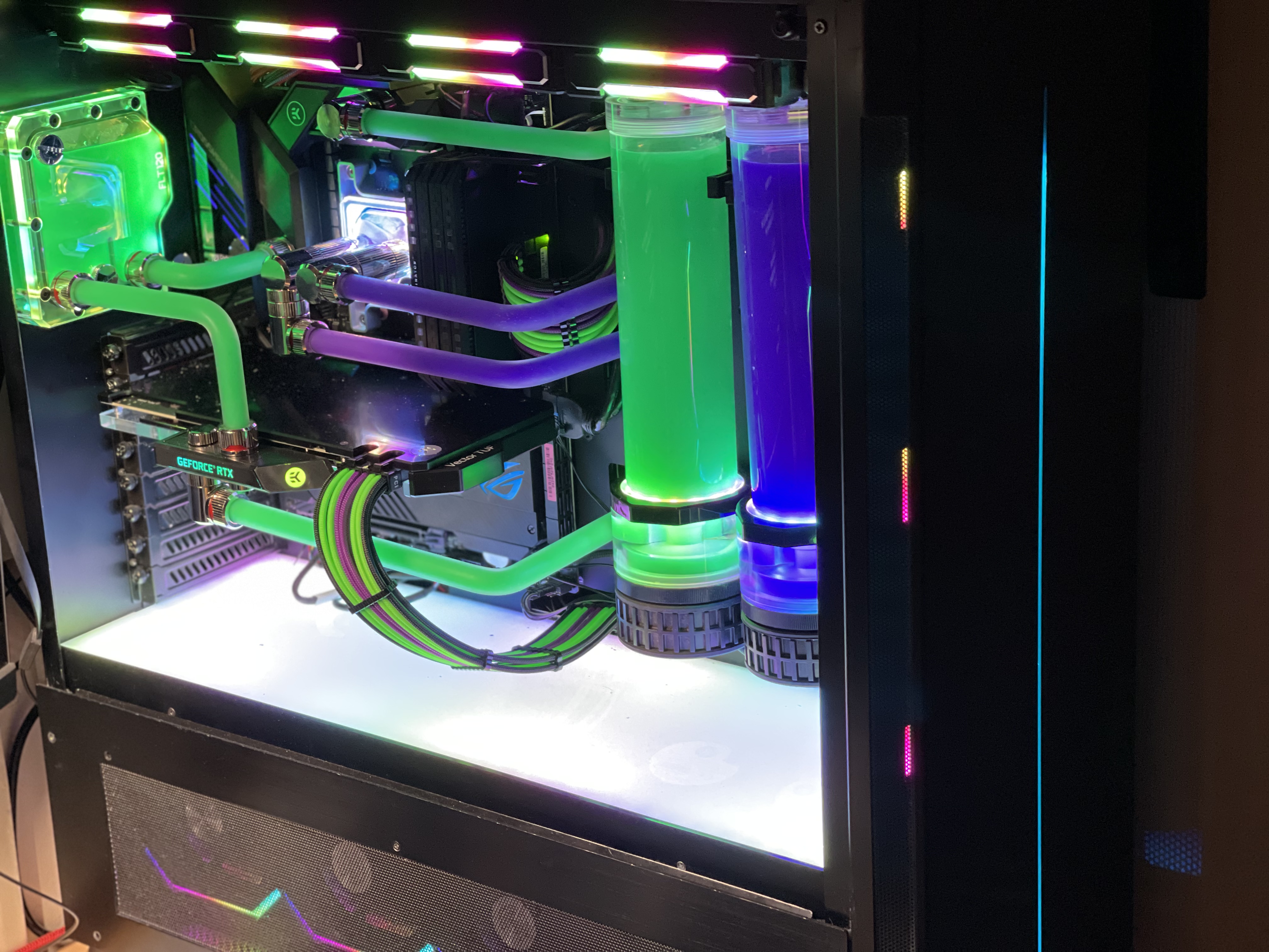

Go easy on me as i am no pro, still need to tidy some cables and have a blow around with the compressed air but here it is
Go easy on you? Mate that looks nice, very clean n tidy build, nice pipework, looks really nice

Cables at the bottom are triggering my OCD a little they are just so hard to hide away or make look neat
