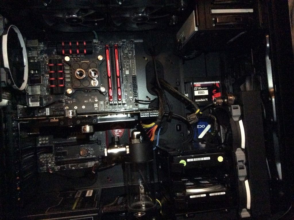

So I'm using hardline for the first time and wanted to ask what's the best way to run the loop
Currently I am thinking of taking it from the pump to the Gpu, Gpu to CPU, cpu to the top 280 rad, top rad to bottom rad then back to the pump from the top
I have a drain put in at the top of the pump should I move it to the bottom? Or leave it where it is, another question should I flip the top radiator around as currently the Sata cables make it a problem for the acrylic
Any help is appreciated
i think you should go to the first closest rad first . and have the drain at the lowest part of the loop , i.e at the out port on the lowest rad .
Ah ok, is the lowest point on the loop always the out port of the lowest radiator, currently there's a port lower then that on the pump, should I move the drain there?, and the closest radiator from the pump or Gpu?
I would defo have it on the out port on the bottom rad. but what ever is easiest for yourself . remember though if draining off the rad to have a T junction off the main loop .
Looking at it I think that is a good idea as where the drain is at the moment it's kind of dragging the res down to one side, thanks again for the help I'll post it once it's done for feedback
