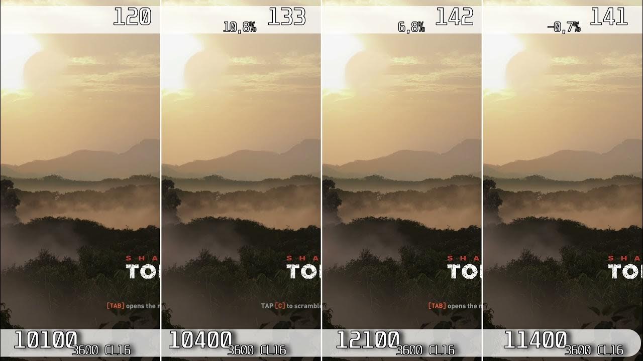

There's a video here:
It seems to gain lots of fps between a i5-3570 and i3-10100 (on low settings), which suggests it is single-thread oriented and doesn't care that much about the GPU (since they're using a 1650 which is slower than your card)?
In a high-fps game like Siege, the 12100 is faster still (than the 10100), so my guess is that this would be an even bigger increase, though higher than your budget:
