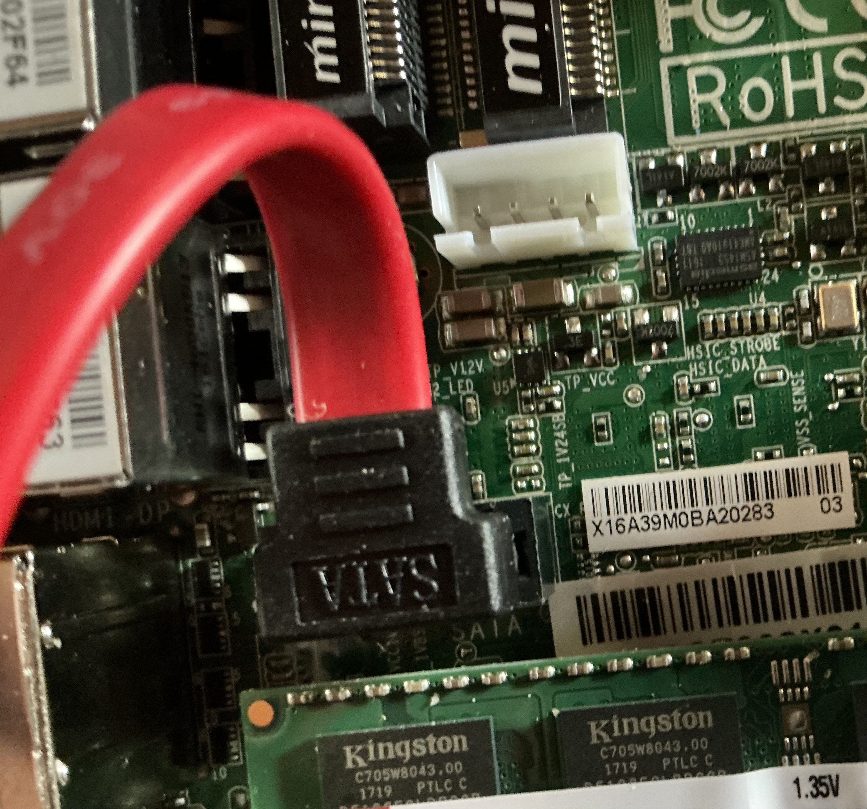

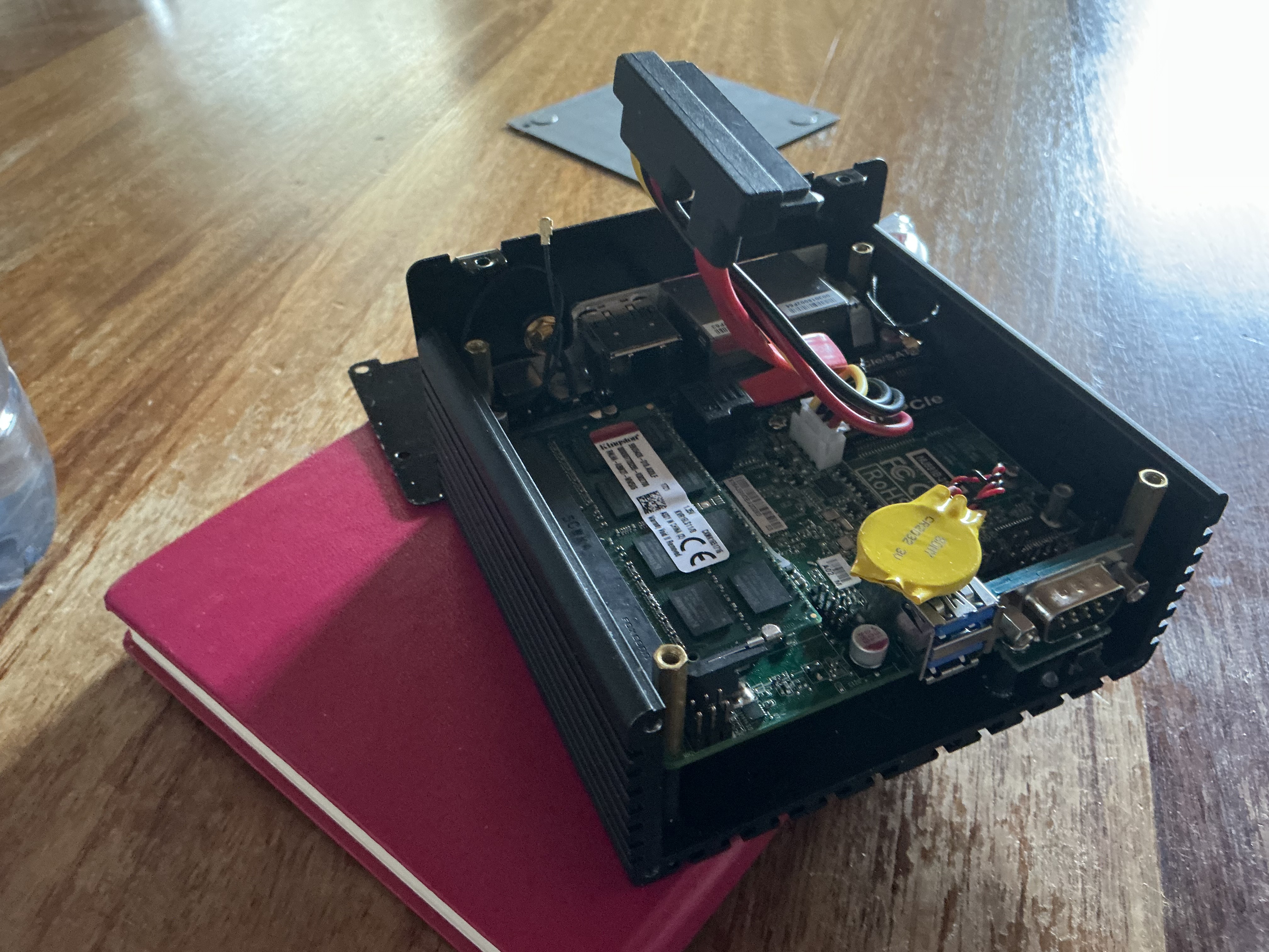

I have a tiny Jetway device that I use as an OPNsense firewall. It is about eight years old. Recently, I changed the 2.5” SSD inside. Since then I have been getting occasional CRC errors. Normally, I would suspect the drive, but it is brand new and passes a long self-test. Due to the limited working space, I have a feeling that I may have damaged one of the SATA cables when installing the drive.
The problem I’m having is finding a suitable replacement cable (or cables). Firstly, it’s a 2-in-1 data/ power cable, then it has right angle connectors, and finally, it is about 10cm long. I have reconciled myself to using two cables, but the other requirements don’t leave me any room for manouevre. I can’t find anything. I don’t even know how to describe it. Frankensata? Is that a floppy 4-pin on the board? I feel like I’m looking at something designed by MC Escher. The data cable won’t be an issue, but that power cable. Ugh! Any suggestions?

The power connector looks like a 4 pin molex could you get pictures of it?
Absolutely. I will disassemble and take a pic when I get home in a few hours.
Looks more like a 4 pin JST to me
The manual is not very helpful. Here’s what it says. Not sure if it helps in any way.
PWOUT1 (4-pin): SATA HDD Power-Out Connector
