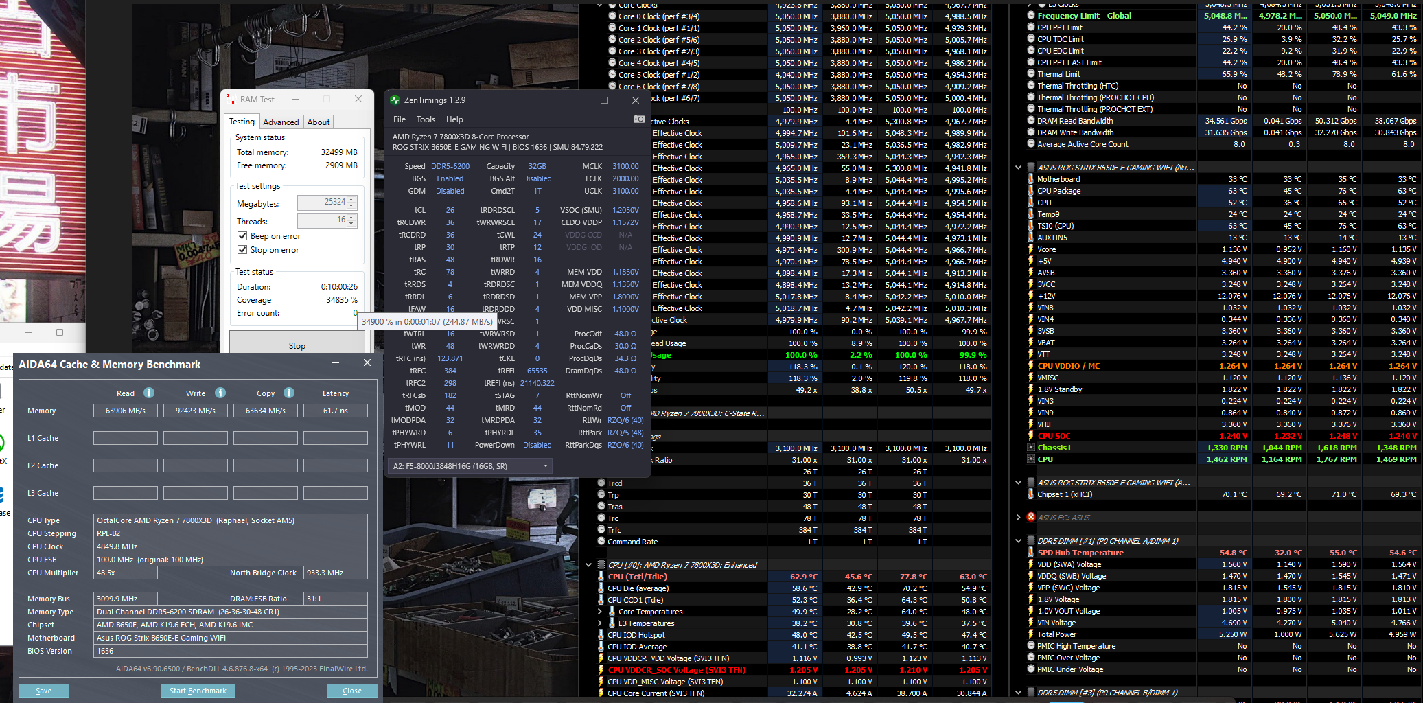

This is where im at right now on C, im bouncing back and forth between B & C, I backed off to 7400mhz from 7600mhz to reduce stupid voltages 1.45v + for everything, and also allowed me to disabled GDM, all for next to no performance lose against 7600mhz
SoC @ 1.25v
VDD @ 1.4v
VDDQ and VDDIO @ 1.35v
What did you settle with in the end for stability (1:2)?
I didn't bother trying to get it stable as all the info said it was pointless running at 8000mhz - it was more of a lets see if it posts thing :D
I went with the general consensus and just 'down clocked ' it to c26 6200 at present ( still need to tune the FCLK ) and as you can see from the AIDA test 6200 tight is better than 8000 loose.
Now i've got a feel for these sticks i'll start playing, but anything past 1:1 seems pointless at the moment.

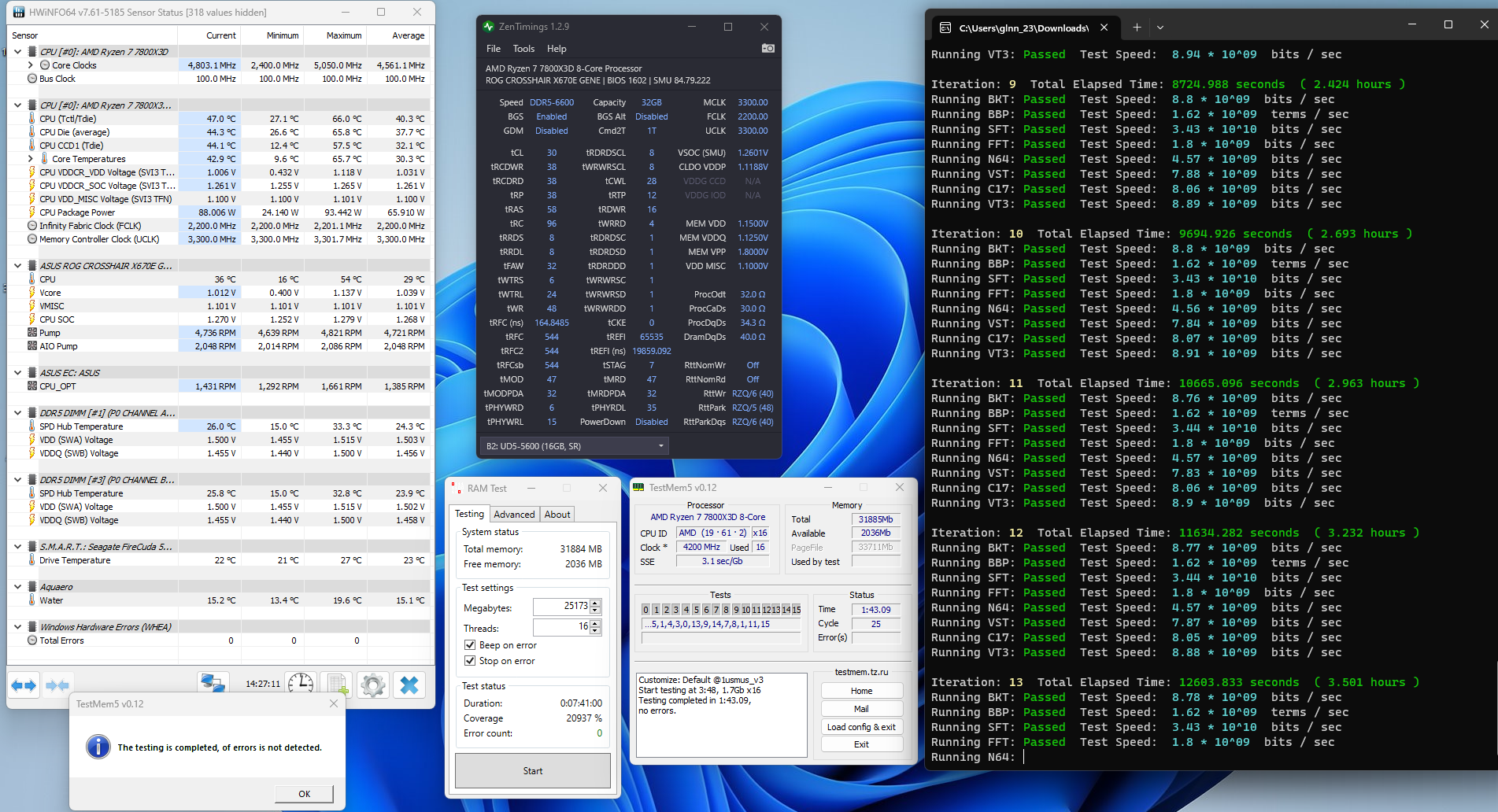

Testing some G.Skill 7200c36 (2x24Gb) F5-7200J3646F24GX2-TZ5RS @ 7800c36
and some TEAMGROUP T-Create Classic 5600c46 CTCCD532G5600HC46DC01 @ 6600c30
Hello, I have the same teamgroup kit advised by buildzoid. Bought on July, production is 17-21 April.
Did you remove the HS to check if they are A die?
Could you share your settings for 6600? I'm afraid mine are M die. Thank you
No sorry I haven't removed the heatsinks.
Timings and voltage settings for 6600 are pretty much covered in the screenshot. Vddio was 1.43v
